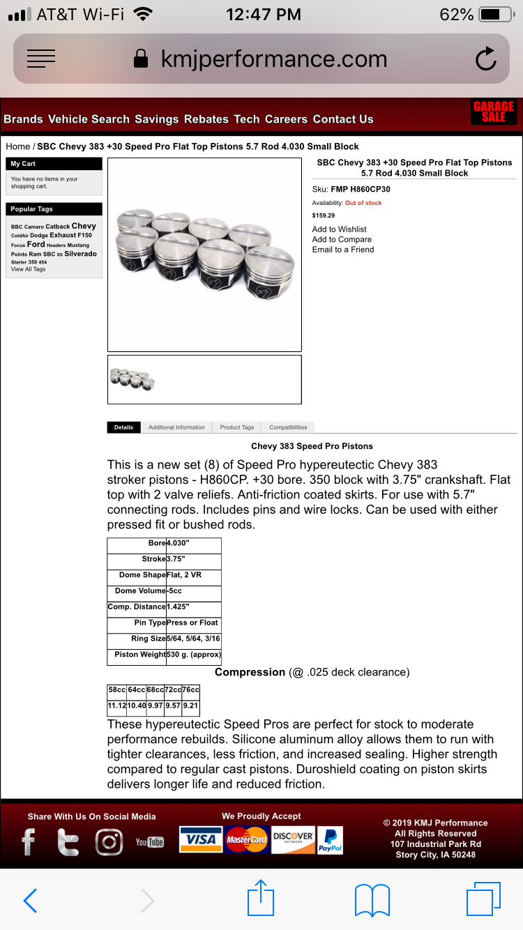

Wouldn’t Mallory weights cost a lot for balancing ?
@Orr89RocZ these pistons maybe
https://kmjperformance.com/fmp-h345d...-rods-sbc.html
Old Mar 6, 2019 | 01:10 PM
TTOP350's Avatar
Posts: 12,231
Likes: 1,159
From: Il
Engine: 4++,350 & 305 CIs
Re: crituque Engine build plan
You don't need that, the crank come setup for internal balance if you order it that way.
Old Mar 6, 2019 | 01:13 PM
Orr89RocZ's Avatar
iTrader: (20)
Posts: 25,896
Likes: 430
From: Pittsburgh PA
Car: 89 Iroc-z
Engine: 555 BBC Turbo
Transmission: TH400
Axle/Gears: MWC 9” 3.00
Yes mallory metal is expensive but not always used. It depends on the counter weights and piston rod weights. May need to remove metal instead of add mallory. But it generally isnt hard to balance a crank. Especially a 383 using 6” rods
those pistons can be fine, just note they are deep in the hole depending on deck height
if its decked to 9” they would be .012 in the hole. If stock deck at 9.025 then .037 in the hole
they seem pricey for non forged tho
