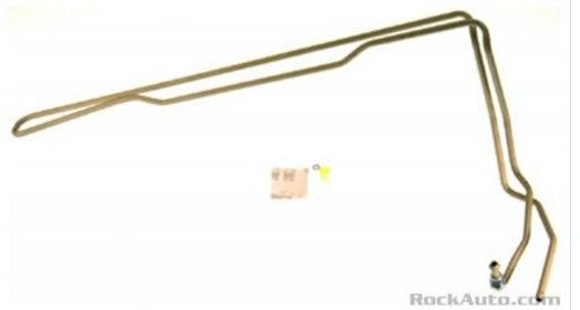

This Is The Cooler.

Originally Posted by gt4373
This Is The Cooler.
My 88 IROC has one of these hard line assemblies under the radiator. Just like in this picture.

Thanks everyone, mine is for sure missing that. I found an aftermarket for 20 bucks. Guess that will be a very near future project
