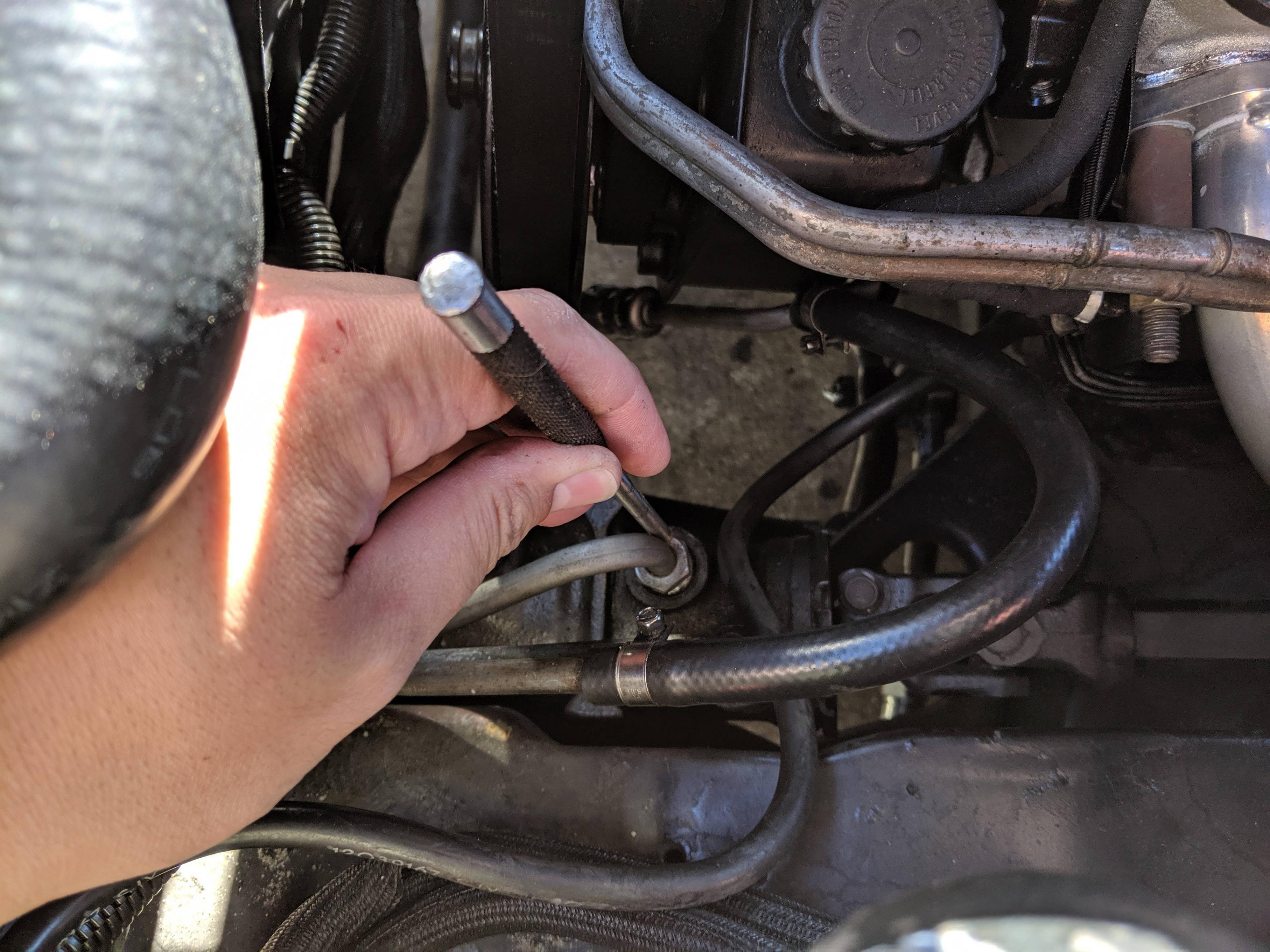

You could also try "shocking" the flare nut with a hammer and punch (or socket extension) positioned like this in a few spots around the nut to try to help it break free
More PB Blaster overnight and trying that in the morning. Are there any other products better at freeing seized bolts?
