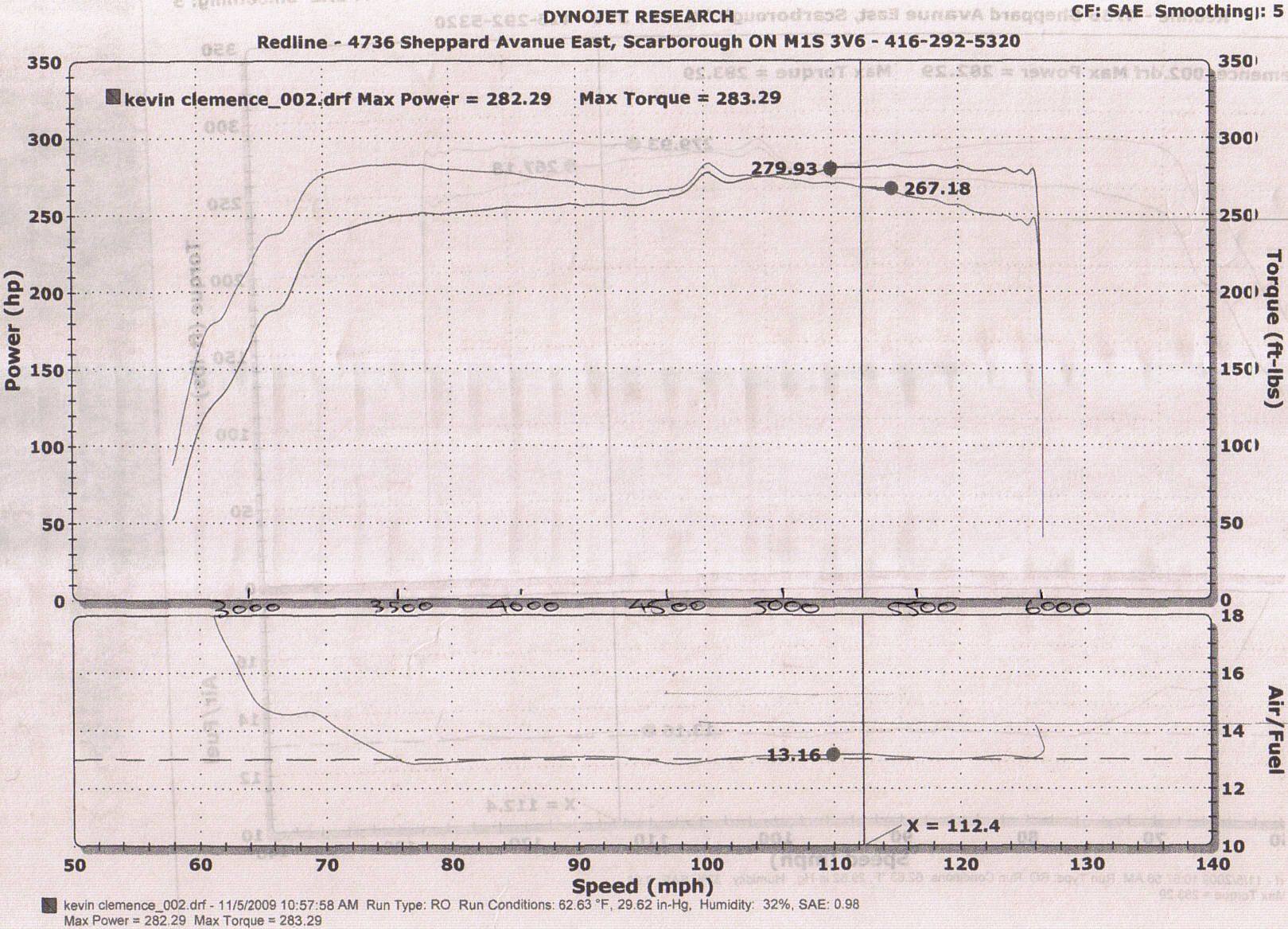

Here's an interesting note on converter lockup and something that the dyno tech said was happening but electrically, it couldn't be. MY TCC lockup is connected to the 4th gear apply valve in the valve body. That is to say, that unless the transmission is in OD, the clutch will not lock up, Electrically that is. I also have a manual disconnect switch on the dash that was in the open position furthering the incomplete electrical circuit.. Now the tech, when examining the output graph, said that on the two pulls that were made, and these were in little d/3rd gear, a small plateau in the graph indicated to him that the converter was indeed locking up. Didn't make sense to me. Nor did the output results that had a 12 second car producing 288 RWHP. Not sure what to make of that.
Perhaps a little off topic but the discussion around output vs lockup got me to recalling that test.

288 definitely isn't a 12 second car. Even AWD 300 WHP isn't going to make 12 seconds unless it's really light. Like 2000 lbs light.
stock type programming has lock up speeds for OD and D. This locks it ar part throttle. At wot there is also a unlock prevention threshold which is what i use. Its usually set between 70-88 mph stock so that once you reach that speed in any gear it will lock the converter. You might have triggered that?
288 whp is welll into the 12’s. My iroc at 3400 lbs total went 12.95 and 12.99 at 103 at 254 whp. My ls1 trans am went 12.11 at 112 with 308 whp in texas negative DA winter air lol. At 3460. 12.52 at 108 at full weight in pa air at 3686 lbs
Ah I see. When I think of a 12 second car I think of 12.00, but most people seem to prefer (gee I wonder why? ) calling it a 12 second car even if it's 12.99, which by all mathematical reason is essentially a 13 second car. I get it though - round down for ET's, round up for ***** size.
I don't race em (yet), I just dyno and tune them. So I just know the dyno says it's not going to make it to 12.00. Now I understand the lingo.

As a follow up and by way of comparison, (if anyone is interested), here's one of the dyno pull graphs.
That chassis went:
June 12 2009 12.87 @ 105.5 1.77 60’ (3.27 gear *)
Oct 17 2009 12.78 @ 105.1 8.088 @ 83.94 1.71 60’ * (all of the above with McCreay dirt track tires)
You can see on the graph where the torque and HP both have a small peak right around the 100 MPH mark. That's the point where the dyno tech said the converter was locking up. I can say absolutely that there was no electrical connection to the TCC solenoid as I had the manual switch in the open position. Is there a hydraulic reason that locks the clutch when at speed? Unfortunately, no RPM scale was available so I sort of estimated based on the crossover at 5252. Not sure how accurate the MPH scale is either.
Engine specs were:
Engine 2007
353: 4.020” x 3.48”
5 cc piston
Resized rods w/ ARP bolts
.030” deck
670 Holley
RPM Air Gap
Vortec heads. Decked .006”. 63 cc (?)
Comp XR276HR. 276/282, 224/230, 110 LSA, 106 ICL, 64 ABDC IVC
Victor Reinz 5746 head gasket .026” x 4.120”
Mid length headers
10.05 SCR / 8.08 DCR
Cranking pressure 185-190
3700 lbs and a tight converter too. An overachiever if there ever was one. With gears and traction, I'd say bottom 12's for sure but in this case, it was an all street suspension.
GD. You talk about area under the curve. I think part of this car's success was the exceptionally flat torque and HP curves. Not great peak numbers but pretty good average values I think. I attribute that to a well thought out engine plan.

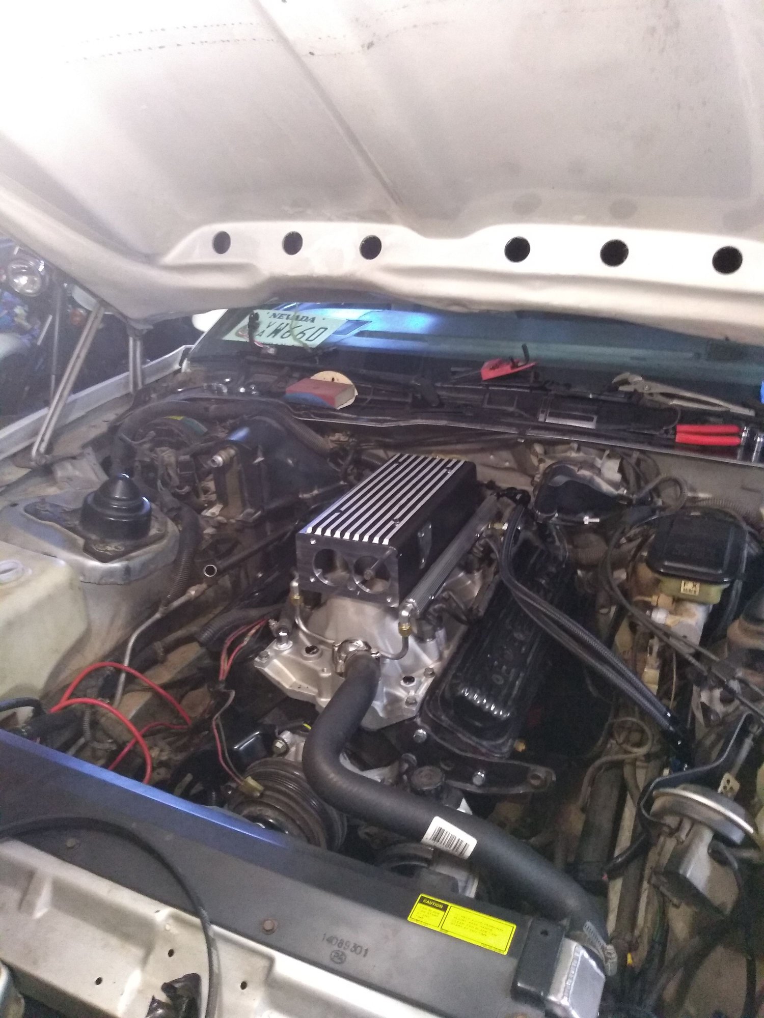

I don't know much about 305 heads but I'm sure there are good aftermarket options. I've seen a couple threads on here with head recommendations.
I have a rebuilt Vortec with a cam and valve train ready to go into the TA. Just have to order a First intake and some injectors.
GD
GD, where did you get those valve covers?
Where do you fill the oil?

That would be these from Proform:
https://www.summitracing.com/parts/p...make/chevrolet
They have other colors also.
I needed taller center-bolt covers to clear the narrow body Scorpion roller rockers on the Vortec heads.
GD

These clear the brake booster?

You might want to look at the location of the brake booster again. LoL. It's nowhere near the valve cover..... any valve cover.
These are only about 5/8" taller than stock.
You put in the oil through the breather hole with a funnel.
GD
