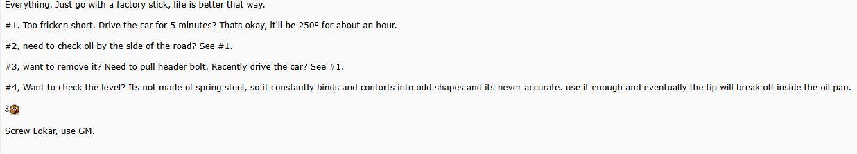

So many on here swear by the Lokar but here is a counter to that from @Thirdgen89GTA . I also am not a fan of it being hooked to a header bolt. Its hard enough to get to the header bolts without this thing being in the way.

yea i’ll keep my $100, hopefully i can get one that bolts on the head above the headers
