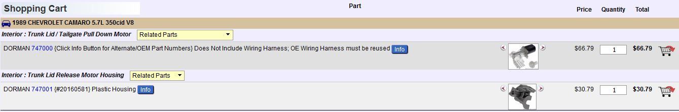

Dorman offers what sure looks to be a glass fiber reinforced plastic housing. Rock Auto sells em cheap. Don't forget to look for a 5% off coupon on the Vendor forum. They also have the new motor/housing replacement assembly unit.
Just a few more options...

I took it apart today,and put the used housing on. I didn’t have any instructions and it was extremely easy and straightforward.
the gear was bad on both units I had though so I had to buy one. Dorman makes them. You can get them for $12.99 delivered. I figured since this was so simple to take apart,and the used parts housing was still in good shape with only a couple small hairlines I’d use it for the time being and order a new one from TDS or buy the fiberglass reinforced dorman one.
i got lucky and all the nylon glides in the mechanism are perfect.
does anyone here know what that blue grease is that gm used?
