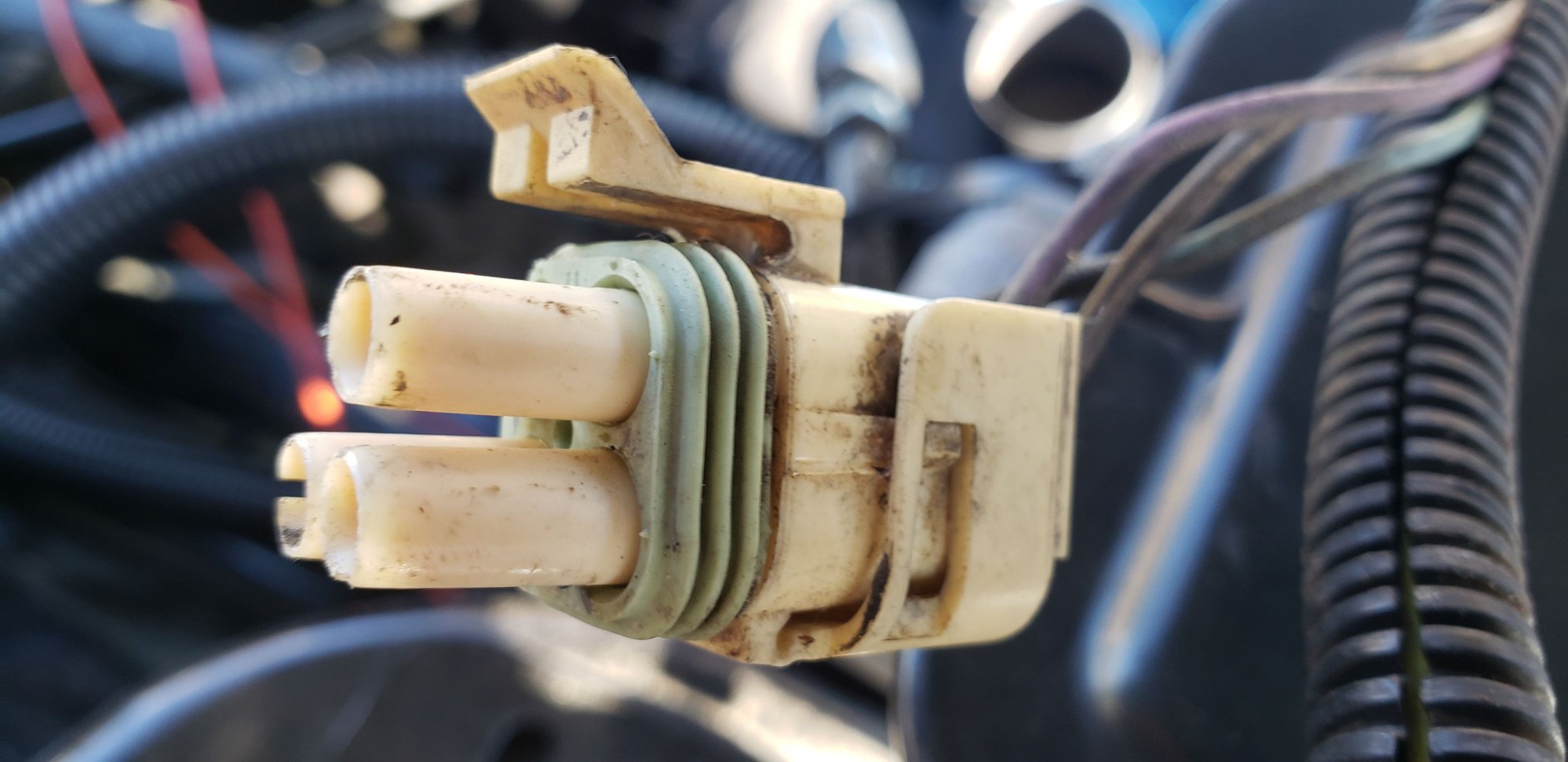

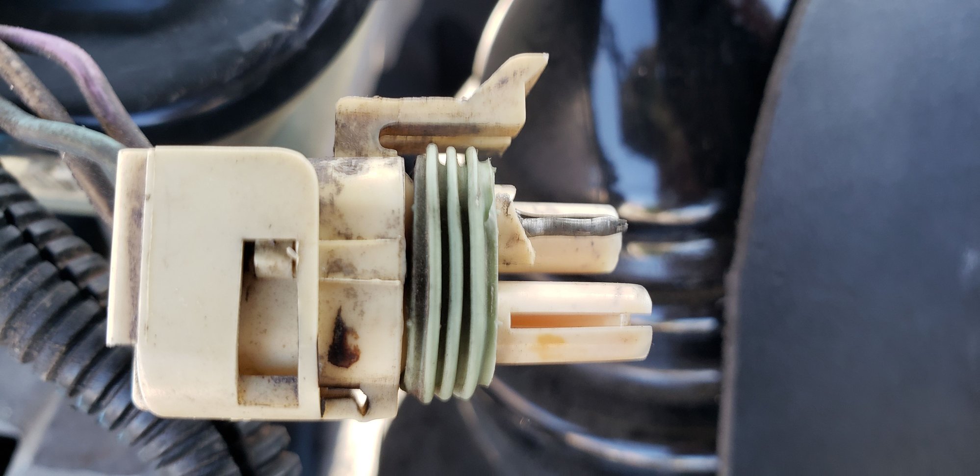

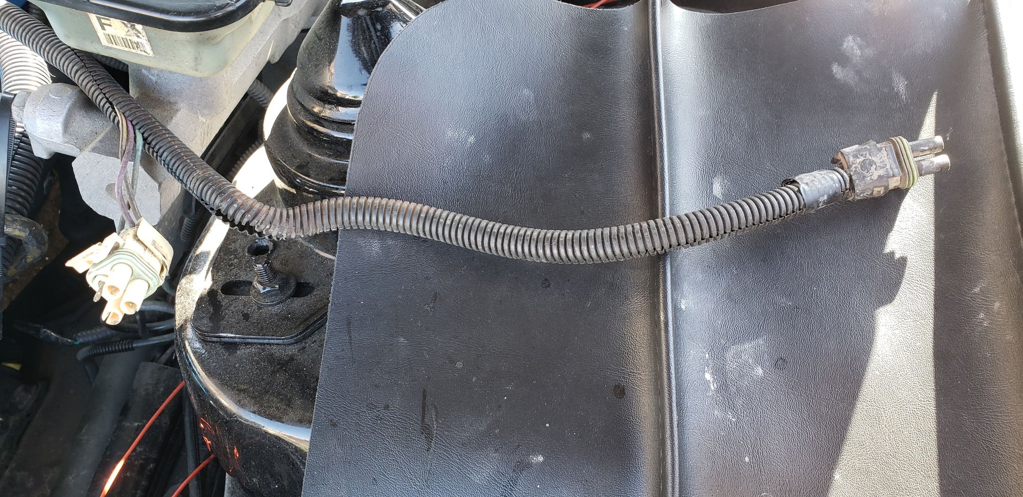

Somehow these two connectors did not get photographed & or tagged before they were disconnected or the wire tags came off during the motor r&r and car repaint.
89 Camaro RS 305 TBI 700r4

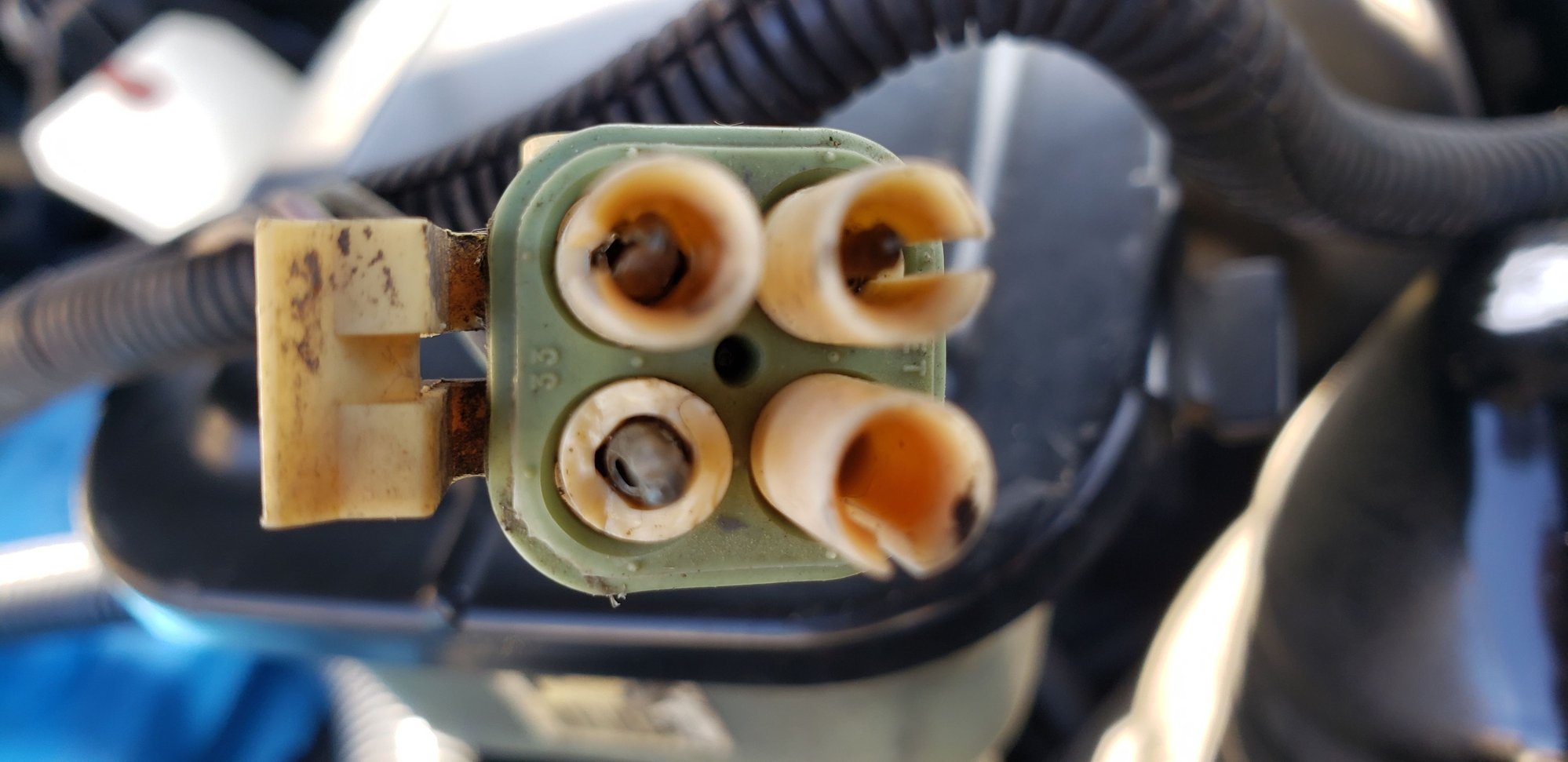

If any body knows what these two connect to I'd appreciate it, I think something's missing which is why I can't figure out what/where they go to.
obviously the 4 pronger is broke, another reason why I need to figure out where they go.
thanks in advance.

Re: Trying To Identify Two Unknown Pigtail Connectors
Tcc lockup plug
https://www.ebay.com/itm/Torque-Conv...UAAOxyf2pR5XrB

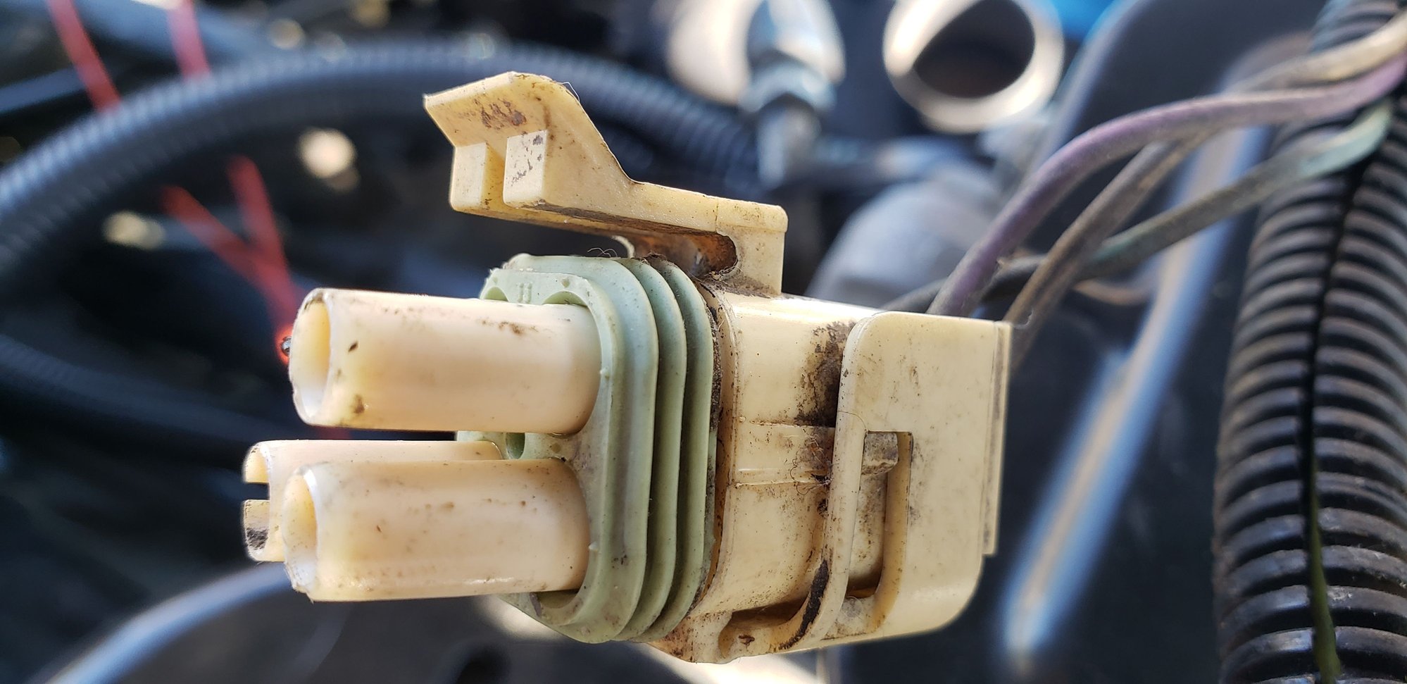

yeah, that's the big one for sure, thanks...
Any ideas on the green two hole'r 12"-18" away from it?
thanks in advance
The other one goes to the trans vss
Since the big one is the converter could the small one be the VSS ?
thanks again, I appreciate it.
