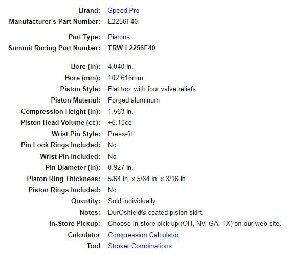

Unfortunately that combination of those "rebuilder" truck pistons and those heads will give you rather low compression; ideally you'd want pistons without the extra .020" of "rebuilder" clearance that those have, and to have had your block decked closer to zero and squared up. A stock 350 TPI motor with aluminum heads had 58cc chambers; you're WAY below stock compression. Kinda too late for that now though. Gotta work with what you've got in that department at this point.

Furthermore your pistons are performance oriented pistons unlike the reduced height ones Sofa is talking about.

Head gasket choice can kill compression but I bet that engine is still 9.6:1 or better. If you are not zero decked, I would use a set of GMPP Vortec 350 gaskets. The are small bore, 0.028" compressed composites that work very well with aluminum heads. I have them on my 11:1 383.
