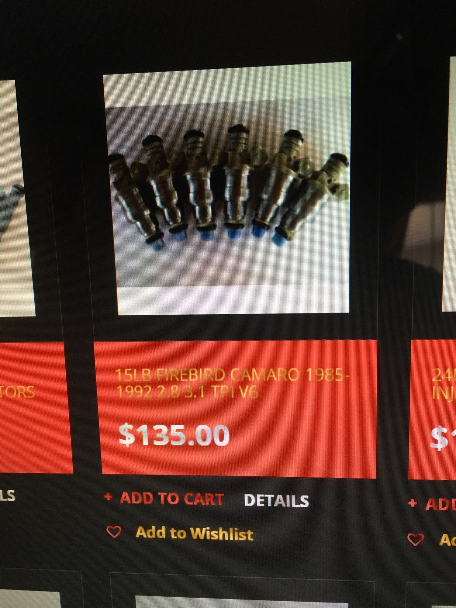

With all due respect , Why would you have the lady spend $250 at RA when she could get a perfectly functional set from SouthBay for $135 ? She ain't looking to play "break the bank" , she's looking to get her car running right while spending the least amount of cash possible

No , actually if the oil smells like gas it will be thin , it's quite possible that if your injector(s) or fuel pressure regulator are leaking that the excess fuel will end up thinning the oil and causing low oil pressure . What happens when either the injector(s) or FPR fail is that it runs way too rich . This fouls the plugs , washes the oil film off of the cylinder wall (bad bad thing for excessive wear) , and end up leaking past the rings and diluting the oil .
The regulator is on top of the fuel rail that mounts the injectors to the lower intake manifold and is accessed by removing the upper intake manifold (the spider looking piece with the 2.8 badge on it) . There are tests that can be done without physically taking it apart , one being to use one of those little hand pump vacuum tools to apply vacuum to the regulator and see if it holds vacuum without leaking . If it holds , it's fine , if it leaks , it's bad and if bad the vacuum line connected to it will very often be filled with either raw fuel or it'll stink like raw fuel , the classic result of a ripped diaphragm .
And Hell yea , $135 beats $250 by a good $115
Although they may be functional. They are not correct for the application. Those appear to be Ford F1ZE injectors which flow like 14 lb I believe, a little more or less due to higher/lower pressures on ford applications. Still functional but will throw off the ecm off a bit. I use to run them but switched back to stock.
