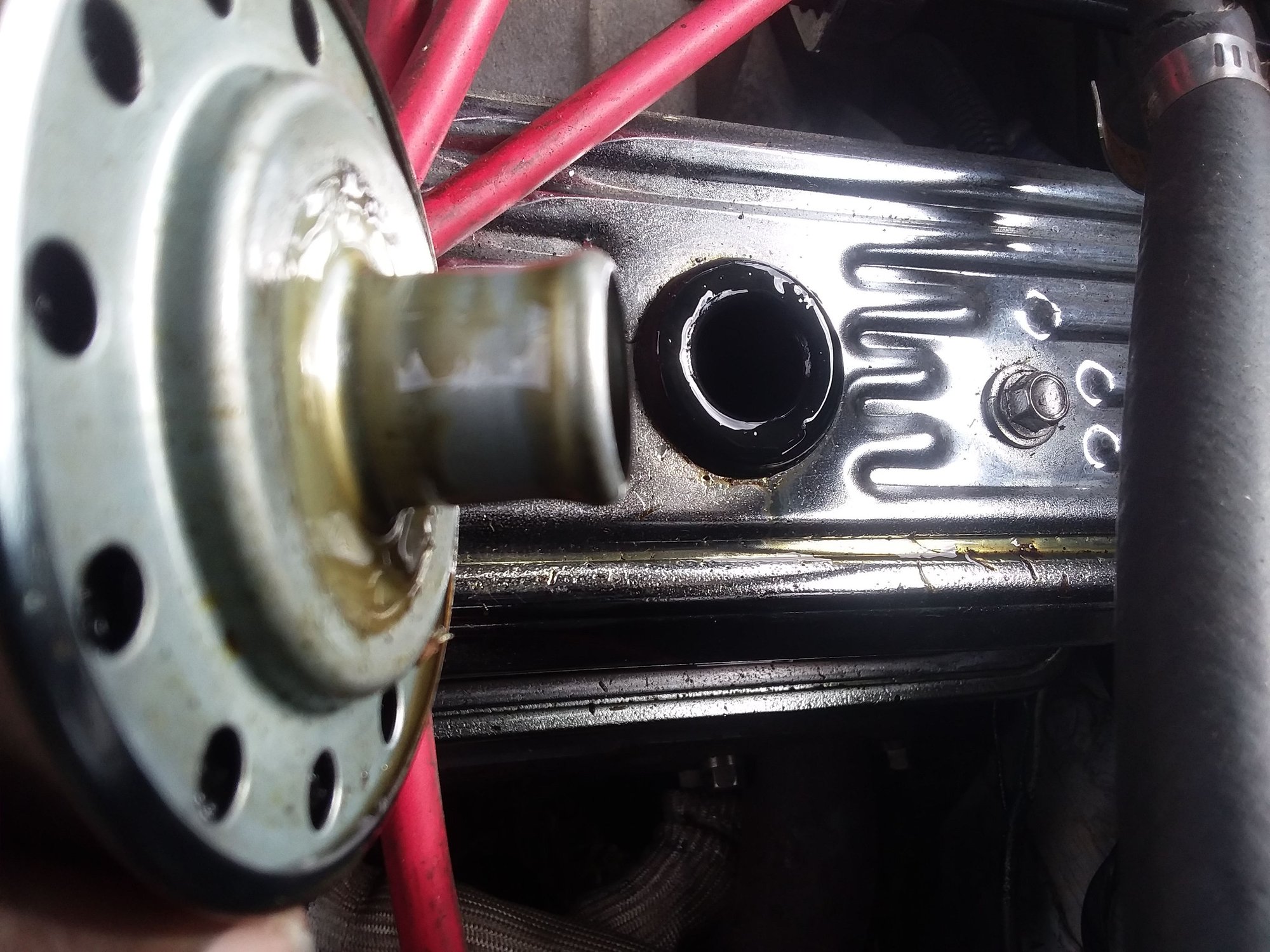

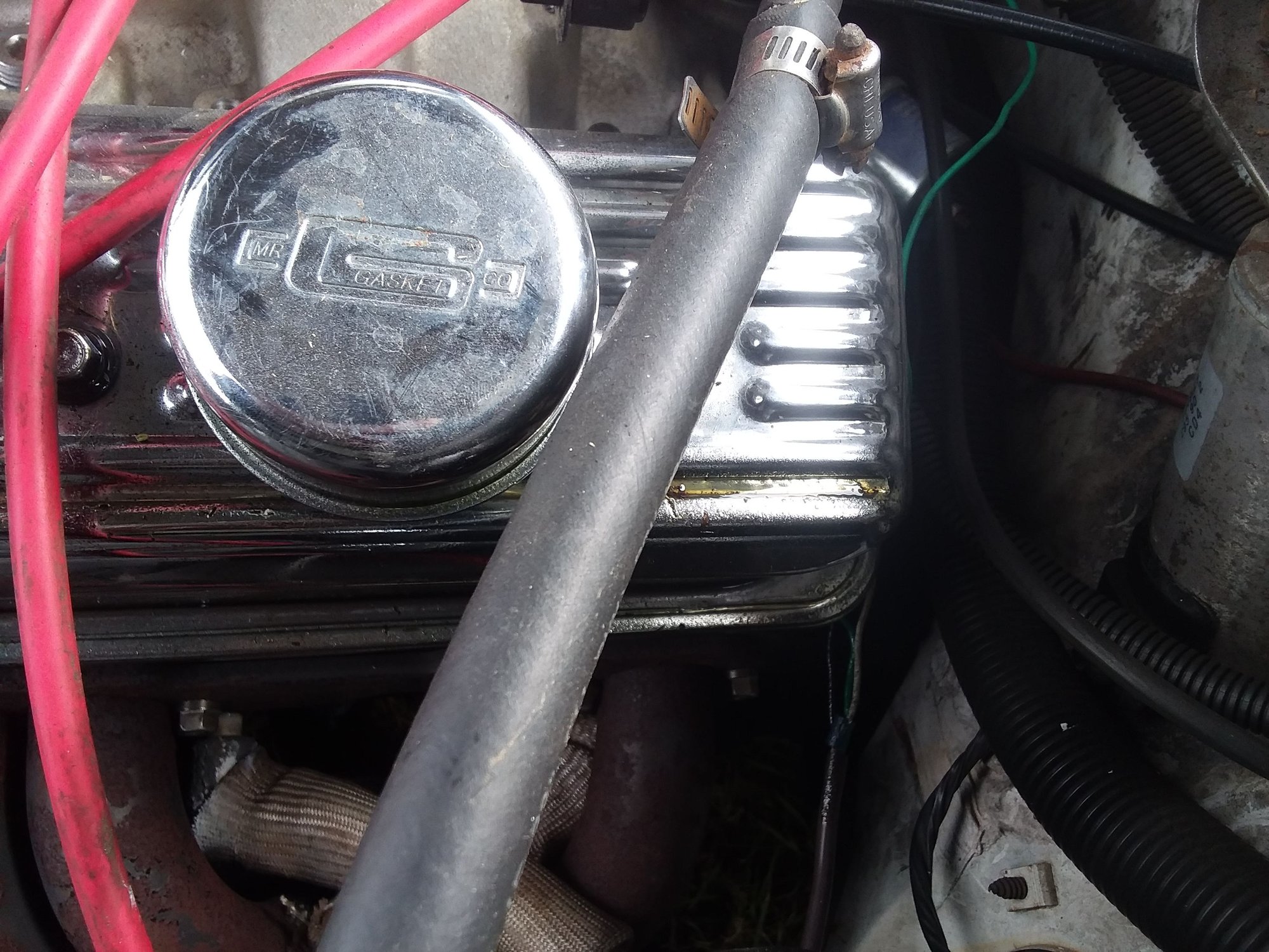

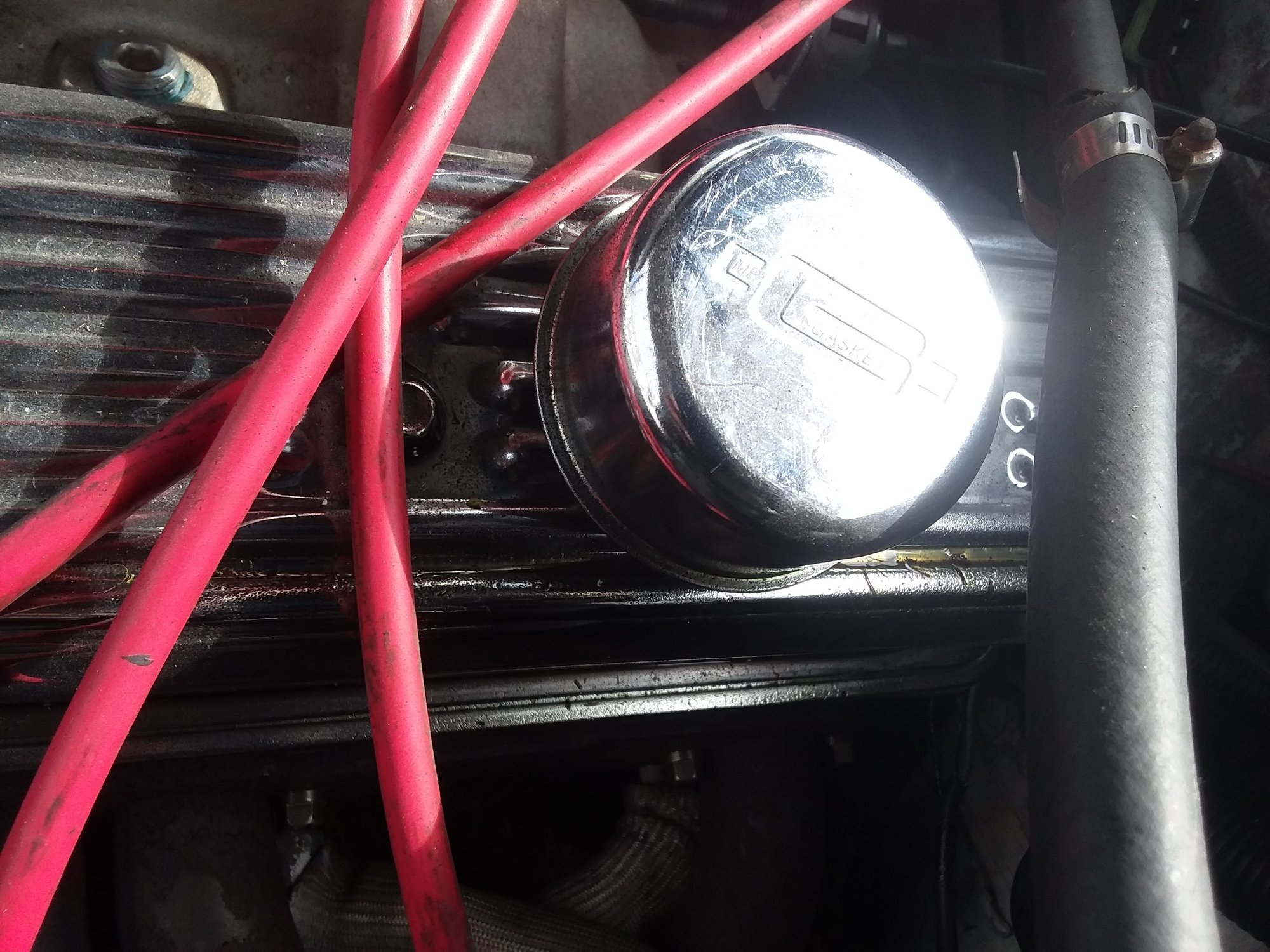

I dont know what this means. The motor is new crate with vortec heads. No water-oil mixing in the crankcase. Is it a bad filter? The pics are what I found when I popped the hood....
is it just pressure from 3500 - 4200rpm and over 40psi oil pressure or do I have a problem????
I dont see any other leaks and yes I have been keeping tabs.
86-90s 350vortec 274cam 850rpm idle, 0 other leaks about 300 miles total on motor

Maybe read up on positive crank ventilation (PCV)? Looks like oil blow by from no where to go?

If its a fresh engine, perhaps the rings have not seated. Have you done the heavy throttle accelerations needed to build the cylinder pressure to help seat the rings. Also those breather filters always seem to leave an oily film on the valve cover even on a healthy engine. At WOT the baffles in the valve cover will always allow some oily vapors to escape as the PCV valve ceases to function in the absence of manifold vacuum.

Do you have baffles in those valve covers? Sometimes they are missing. PVC system only works under vacuum, once vacuum is gone crankcase pressure will push out of breather. You might want to consider a catch can if your going to run an open system.

Go hammer on it to seat the rings. Driving lazy is terrible fornew motors. Then check for oil leaks. Alot of oil could be thrown up to the top end making its way out the breather hole. Esp with rpm, or combined with blowby from fresh motor

Baffles are in valve cover.... yes

A catch can is plumbed to the valve cover and traps the blowby oil vapors by condensing them in the can.
My break-ins are always foot to the floor. With a flat tappet cam I break in the cam. Check for leaks. Then take it out and seat the rings. I try not to take them over 5K until it is broken in. Just don't sustain high rpm or high speed for the first 500 miles.

What you are seeing has NOTHING WHATSOEVER to do with oil pressure.
The REAL cause is, those … [insert words describing manufacturer's impaired brain function here] "breathers", coupled with KROME valve covers that most likely don't even HAVE baffles.
Put some STOCK valve covers on it, and a properly configured PCV system. Problem solved.
