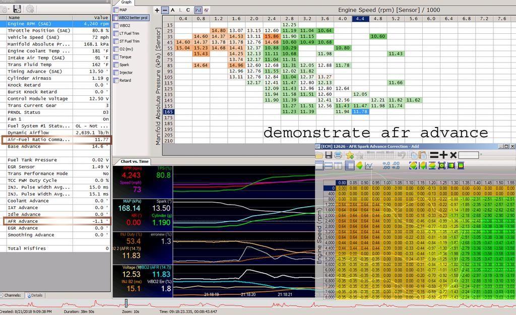

explain to me how to get around the cylinder air mass calcs in the timing table for a boosted 0411 car? You hit the max gram sec value of 1.2 at 4-7 psi on some combos. If your setup runs 20 psi or 30 like my car did you are stock with one timing value the entire way from 4 or so psi to 30 psia. Not ideal for best performance. Maybe later ecms can edit the range but i could not. The way we cheat it is to lie about your injector value flowrate to fudge the gram sec vaue thats calculated but that isnt right
ah-ha ! I am so glad you asked.
The 2-bar OS for 411 ECU may contain a hidden table called "afr advance" which simply relates air fuel ratio to ignition timing. Here is an example of how I used it.
Heres the thread where I reveal the features of this table, and it shocks even those regular on the forums
https://forum.hptuners.com/showthrea...l=1#post540960
With this I can achieve any timing at any boost pressure, as it blends with the primary spark table and utilized RPM as the y-axis for discrete control.
i still dont see how you are doing that. If the spark advance adder is equivalence ratio which is inverse lambda then How does it know what boost its at?
i run near same afr at 15 psi as i do at 30. Theres no compensation for boost or map mentioned anywhere in that thread
you gota use your tuning experience, use your brain. combine the ve map with the afr advance to achieve any timing you want.
say i want 30psi of boost but use the same a/f at 15psi of boost.
In that case simply adjust the VE map leaner and use PE to add an artificial amount of fuel, thereby generating a whole new 'line' of timing values for the increased boost pressure.
I've never had an issue doing this with any amount of boost.
And even if you didn't have that map you could still do it by using a creative implement of IAT or other related timing maps. For example add timing with temperature means you can use a variaster (variable resistor) to add or subtract timing in real time with a dial. I have one of those setup for when I want to throw a couple degrees into it or pull out a couple degrees, or compensate for heat soak, etc...
Simply recall that most automotive sensors work 0-5v or based on a resistance value (with some kind of voltage divider in the ECU) and through these efforts we can achieve any practical application approach.
thats just another way to fudge programming but suppose it could work. Definitely not how i would want to do it. Seems like too much room for error in trying to change fuel to get a new timing value instead of just changing the timing value in a table. Also it would fudge again when iat fuel adder changes as iat increases as intercooler soaks with heat. Or if your water pump fails for air water cooler and temps go crazy, we use iat for safety
Interesting concept tho
After I said turbocharger allows for higher rpm (thus 7k 8k 9k 10k etc)
why do you say "they don't run 6k and more boost" when I just clearly stated that the higher rpm is desirable,
its like you mistook the significance of the statement? I was not saying to use less rpm, I was saying you can feel free to use more rpm with the turbocharger. ...
boost gives us torque, combined to rpm gives us power. So of course we want the highest angular frequency the engine will tolerate...
i did not mistake anything. What you say here is what i have been telling you. Torque at higher rpm makes ls combos live. Not low rpm. There is some cushion effect with turbo car backpressure but its not necessarily the reason they live

Im talking strictly properly tuned thngs. I dont do untuned
lol but how do you know what is tuned? And when?
Dynometers can't tell you that. Driving it with a wideband can't tell you.
Track testing for vehicle acceleration is not a best 'tuned' situation either, its just the fastest setting to get down the track and rarely matches up with what a dynometer will tell us.
In short the only way I know of, to know whether the engine is 'tuned' or not is to use a combustion pressure analyzer in conjunction with gas analyzer and several individual EGT sensors. Or similar. And then to drive the 'vehicle' in many many many different situations (high altitude, low temp, high pressure, low speed, all variations within the scope of application) and compare it to both a physical scale down model (say, in a wind tunnel, or other environments, etc... like they do with planes and ships) and a computer model combined with the empirically generated data.
And none of us has any of that.
So none of us really knows when something is tuned or not.
For example you can't look at a timing map for a particular engine and 'know' whether or not the timing values stated are anywhere near proper unless you have precious experience with that engine's particular nuance behaviors. And even then its just a ballpark.
Which brings us to the idea of ballpark tuning, or tuning to fall within some scope of measurable outputs.
That is we are attempting with the dyno/track/wideband. We take what little data we have and make educated guesses.
guesses
Old Dec 3, 2019 | 10:25 AM
Kingtal0n's Avatar
Posts: 3,306
Likes: 78
From: Fl
Car: 5.3L turbo 2800lbs RWD
Transmission: 4l80e
Axle/Gears: 3.512
Re: 350-400 rwhp build plan
First, its two graphs. PE and VE. They work together, naturally.
So if one goes lean, and one goes rich, its the same thing as if one goes rich and the other goes lean.
There is no 'fudge factor' using this technique.
It's not like a scale tune where every single ****ing table has to be compensated for.
There is no large scale, system wide draw back to using this method.
That you seem put off by it's deceivingly simple principle indicates a limited experience tuning a wide variety of computers, which is nothing to be ashamed of; nevertheless be aware that I have tuned around 10 different computers/engines from 10 different manufacturers and have come to use basic principles of how to best utilize such sensors in each case, and it is rarely the same method between them which yields ideal results.
The IAT sensor for example in this case, using a OEM Hptuners style ECU, is completely different from say a haltech or AEM style of iat tuning behaviors. The HPtuners ecu in particular seems better off without an IAT sensor most of the time lol. In fact I drove for many years without one. I also never use a closed loop on my own cars.
IAT: add some perspective
I get the feeling you think of a single IAT sensor, when in reality you need several, and to be able to switch between them instantly, or log them all at once somehow.
For a performance car has multiple stake points for IAT to be taken for measurement.
ex. Before intercooler, after intercooler, before intake, inside the intake, turbo outlet temp, engine bay temp
Furthermore, we often need a steady resistance value handy to clamp the IAT in certain situations.
It depends on the vehicle application, and flexibility of the ECU.
HP tuners(factory ECU) is the only computer I've ever used which does not allow the user to customize fueling based on IAT outside of an Power enrichment state.
And even then it's got a bug where you cannot fully control fuel adding property due to IAT.
This information is general. How you use it depends on necessity.
examples
The factory ECU pulls/removes fuel when IAT rises.
This is because it assumes that air density is decreasing with temp, naturally.
However in our performance applications, we generally do not want the fuel to be removed for high IAT.
Therefore it is useful to disable, or lock the IAT value for those instances. Since we cannot adjust the behavior of the ECU manually this is our only option.
for example I may lock out the IAT for normal driving at 80*F and hold it there. Especially for hot starts in the blinding sunlight when underhood and consequently instantaneous IAT is 150*F when in reality its more like 90*F with the engine running.
that is because you watched "100x tuners tune 100x engines" and those were the results. (sample population vs observation)
Of those 100, say 99 tuners didn't tune it properly and you have no idea which one was the 'correct' one.
Its all about perspective. My opinion is based on what I've seen (very high torque at very low RPM is quite possible using the correct procedure, such as with a blower which can make full torque at 1200rpm)
and I know of static forces within connecting rod, that is,
Force = Pressure / Area, If we know pressure and piston area we get force in the connecting rod given some range of angles (theta), thus an integral of force as the engine rotates exists inside the rod, and RPM has nothing to do with that except that it exaggerates the stress as RPM rises due to momentum being conserved.
RPM is a rod killer. If it was safer to use higher rpm why not 8k 9k 10k?
You make it sound like 7k is the only safe place to be, 5k and 6k is too low, 8k is too high? You have some kinda mental picture here which isn't seemingly represented in reality.
I think what is really happening is 'people'(tuners) are using too much timing at low rpms and the only way they can get away with using so much timing is by running the engine RPM up as high as it will go which helps the piston move out of the way of the expanding gasses that much sooner after a spark.
As simple as it sounds, take a look at the majority of timing maps; you will see several with 'locked out' timing after some specific RPM. like this: 12 13 14 15 15 15 15 15 15 15 16 16 17
When in reality it should be more like this: -2 1 3 6 7 9 11 13 14 13 12 14 15 16 16.5 17
So they both run the same for the last few cells; but if you make any torque before that, the first timing map will damage the engine. Which leads to the rumor of low rpm killing the rod.
Which is absolutely, intuitively incorrect for a mechanical engineer that understand statics, at least IMO
