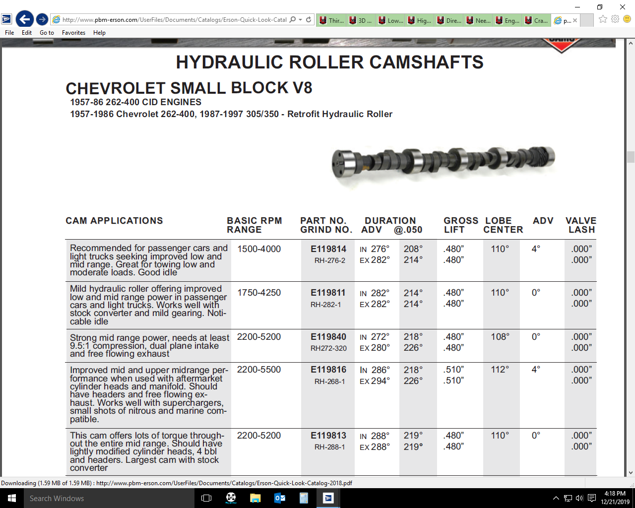

I found a couple of single pattern Erson Hyd Roller cams for you.
