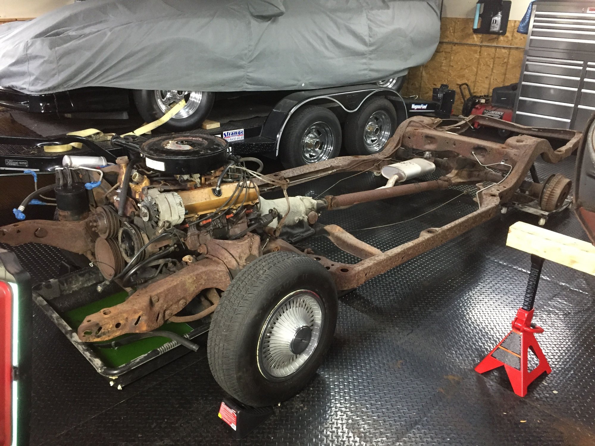

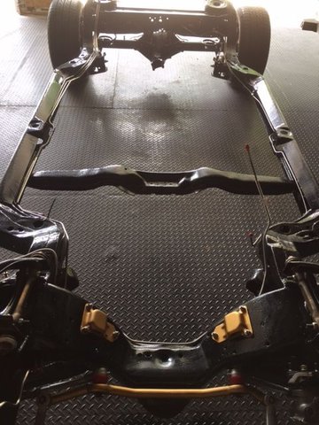

Old Dec 30, 2019 | 09:07 PM
Drew's Avatar
iTrader: (58)
Posts: 20,310
Likes: 1,068
From: Salina, KS
Re: Pulling and Installing the engine and trans - tips?

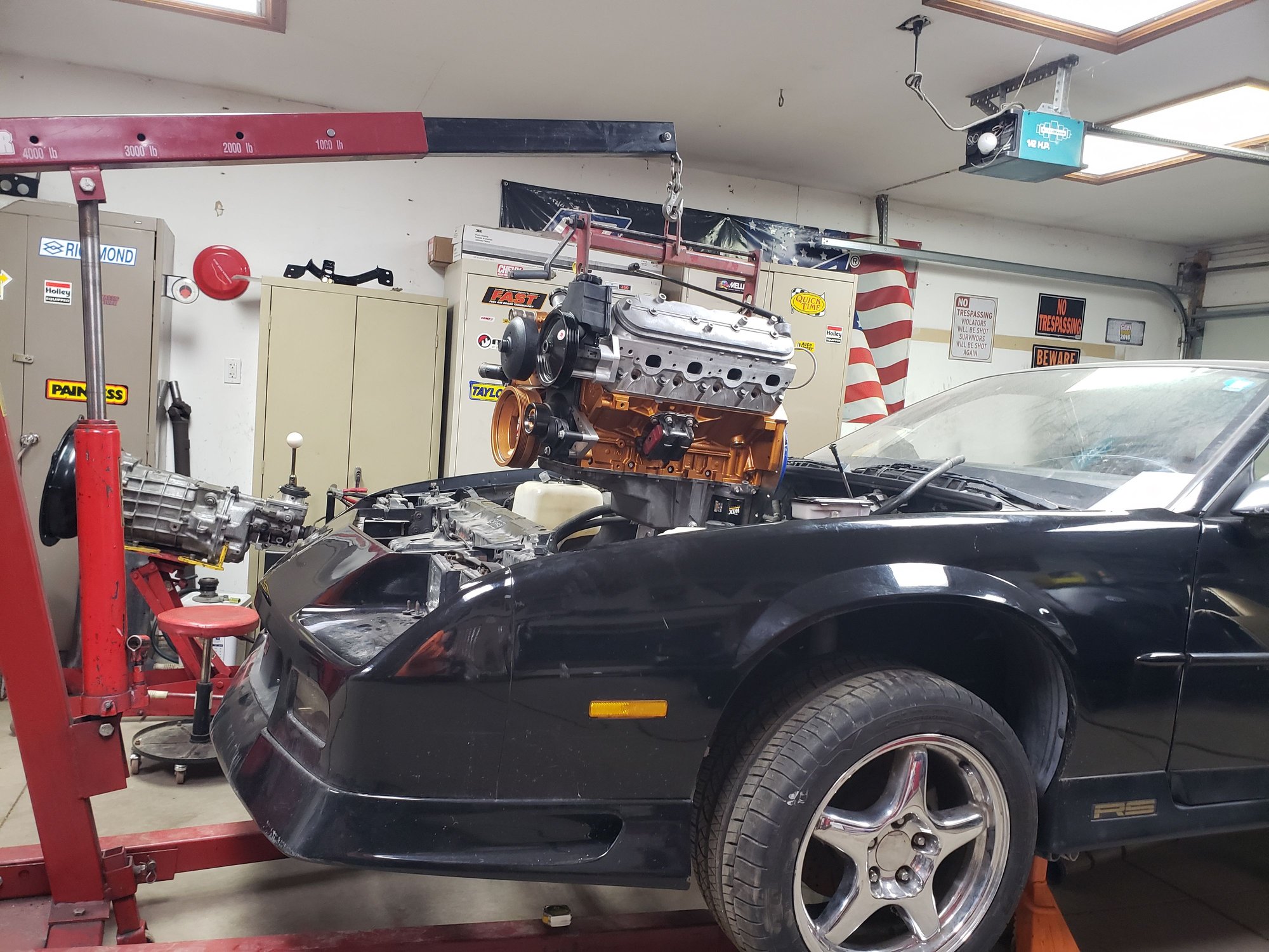

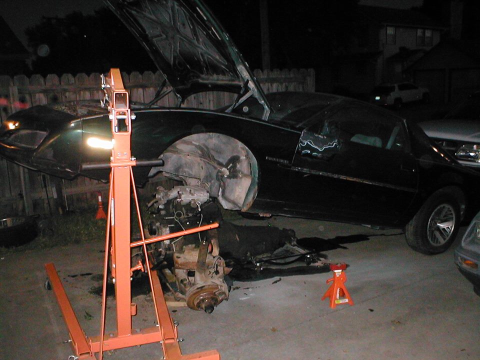

It's pretty self explanatory. Get under the front end and decide what's easiest to leave with the crossmember, and which is easier to remove out of the way.
A harbor freight furniture dolly is enough to support the front half, I used a worthless wheel dolly under the trans pan.
I didn't raise the back end when I did the last one. Getting the rear up a bit would greatly reduce the angle of the body required to roll the engine/trans out. With the tires on the ground, the exhaust will drag on the ground before there's room to roll the engine out.
If you leave the struts/brakes/control arms/etc on the crossmember, you may want to find a way to restrain the front springs in their pockets, and tie the struts together so the rotors don't drag.
Do a Google search, there are a few threads about pulling thirdgen/fourthgen engines out the bottom, youtube videos, etc. Even going into it with a rough idea, it wasn't that bad. I completely just winged it, and didn't crush myself, so it's all good.

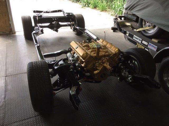

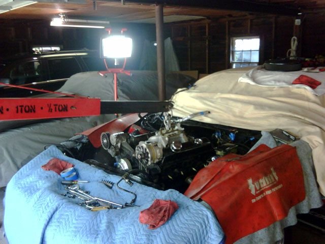

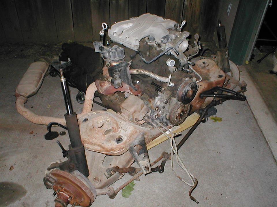

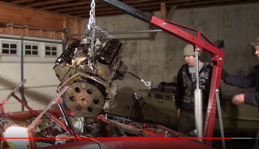

Drew's Avatar
iTrader: (58)
Posts: 20,310
Likes: 1,068
From: Salina, KS
Not too easy to find pics to compare... I know I didn't take any pics the time I pulled a 305 and a 700R4 in one piece out the top, I was too busy picturing what it'd look like when the chain or one of the bolts or the hoist failed and all that steel came crashing down, to worry about pulling out the camera. Fortunately thru the power of the internet...
1st example - Notice where the boom is at in relation to the load, and note that the engine isn't even half way out of the engine compartment, much less how much HIGHER the engine would have to go to get the entire length of a 700R4 out of the trans tunnel, and over the radiator support.
2nd example - Again, look at the boom. Imagine how high the engine has to be off the ground to snake the transmission into the tunnel and around the corner to clear the radiator support in front.
3rd example - Engine dangling at an angle, hoist over 1/2 extended, no transmission, so figure another 3ft of height to get the tailshaft over the fenders or rad support.

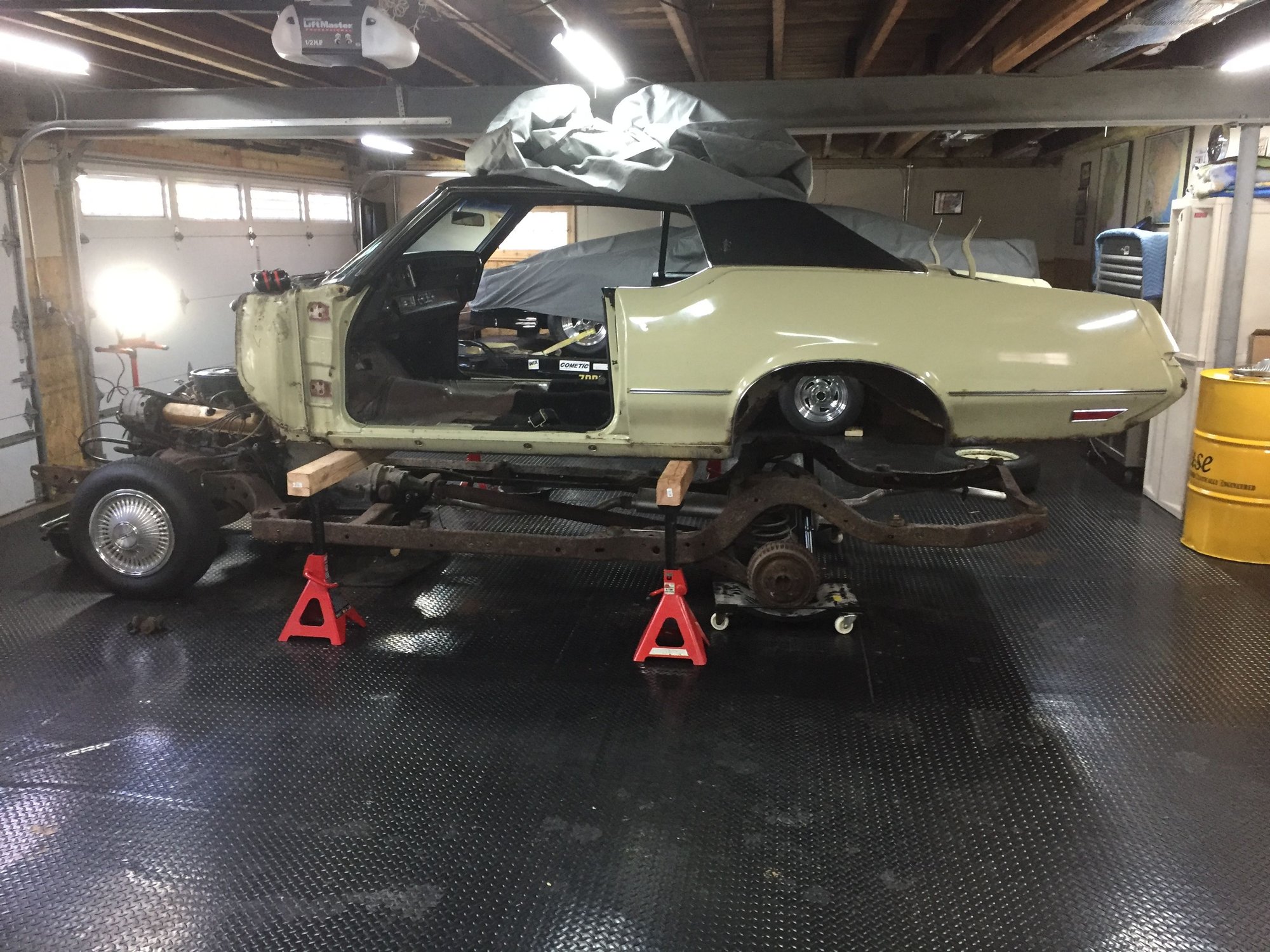

4th example - Engine and trans extending over the puller's head. Hoist nearly fully extended. If anything goes wrong, things are going to be ugly.
Now scroll back up and see how far my hoist was extended to clear the engine out the bottom.

Originally Posted by skinny z
Question though. Once you've got the car hanging from the hoist, what do you use to support the engine, trans, crossmember and front suspension as you lower it out of the chassis.​​​​​
You don't.
Jack the car up, put it on jack stands. Roll the engine hoist over the engine as normal. Hook up the hoist as normal. Raise the hoist until the car is nearly off the jackstands. Remove the last bolts retaining the crossmember to the body. Raise the hoist high enough to slip the stands out from under the car. Roll your furniture dolly under the crossmember, lower the hoist (engine/trans/crossmember/car) until the crossmember is resting on the cart. Unbolt your pulling chain from the engine, bolt it to the sway bar mounts or steering mounts, hook your hoist to the chain, and lift the body up and leave the crossmember and engine/trans sitting 4" off the floor on a dolly. Roll the engine/trans out, slip the jack stands back under the car and lower the body. About the only danger is potentially working under the car while it's sitting on jack stands and the hoist is lifting the engine/trans/crossmember. But really, you can get at all the crossmember bolts without being under the engine or crossmember. The hoist is no more likely to fail here than hanging 6ft off the ground, and the body is on stands/the ground.

Out with the old 383 and in with the new 421. Note the cherry picker hook snug to the lifting plate with just enough slack to undo the shackle when the engine was mated to the transmission dowels and the motor mounts bolts were hand tight. Observe that no angle tiltler is needed when removing the engine separate from the trans since much shorter not to mention a lot safer and easier to handle when working alone.
Removing the radiator gives the extra clearance to separate from the transmission then lift the motor straight up.
Just remember when you see the "dream teams" pulling the motor with trans assembly on your favorite Hot Rod show they have no less than 3 people helping/spotting.
Most of us are working alone without a full blown shop. Do what works for you and be safe !

I did the same thing when I completely dis-assembled my '72 Cutlass to restore it.
The difference was, with no body on the frame, I mated the motor and trans together before re-setting on the restored frame/chassis, totally different scenario. I could maneuver the cherry picker without any severe angles and simply grab the trans by the tail shaft guide it to the cross member and stand wherever I needed to since there was no car body in my way. Once I was happy with the position landing on the motor mounts was a breeze. The firebird sat on the trailer for a couple years while I completed the restoration to the other car.

Actually I cheated and pulled the body off the chassis, I rolled the chassis to an empty bay then continued to blow it all apart.

Drew, in post #6, what are you attaching the hoist to to lift the car? I know I'm a spoiled mechanic who's been using a two post hoist in a well lit shop for a lot of years, but that photo scares me.
I also used a chain between the V6 mounts to lift the crossmember back in the car, so I could set it back on the ground to avoid nosey neighbors asking about the immobile car in the driveway. As I've mentioned a few times before, with the engine/trans/crossmember/suspension weight off the front of a thirdgen, an average adult male can easily lift the entire front end of a thirdgen off the ground.

with the proper lift (not the harbour freight 3/4 scale version) it's still being operated within its design parameters regarding height. That the engine/trans are getting near vertical doesn't change the weight but the centre of gravity is higher up than it would otherwise.
Is this a continuing rip on my 'baby ate too many carrots and erupted like a volcano' orange HF hoist? Because ****-dawg, I could drive to every store in town and not find a better hoist, I'd just spend more money. I've had a few different hoists, I've used friends hoists, this HF is the 2-ton model they don't even sell anymore. I've lost count of how many engines it's pulled at this point. I guess I could grab some Mexi-chrome and stencil CUMMINS on it if that'd make folks feel better. The best hydraulic ram is still an O-ring failure away from dropping your engine, regardless how much you spend your hoist.
Center of gravity is going to matter when it changes the loading on the cheap bolts you're using to pull the engine. It's going to matter when the engine/trans you're lifting comes down on the end of the tailshaft and vaults a few hundred pounds of steel and aluminum in a random direction. Personally, I'll stick to dropping the engine the foot or so to the ground and lifting half the body up in the air for the 30 seconds it takes to roll the engine out from underneath. But to each their own.
