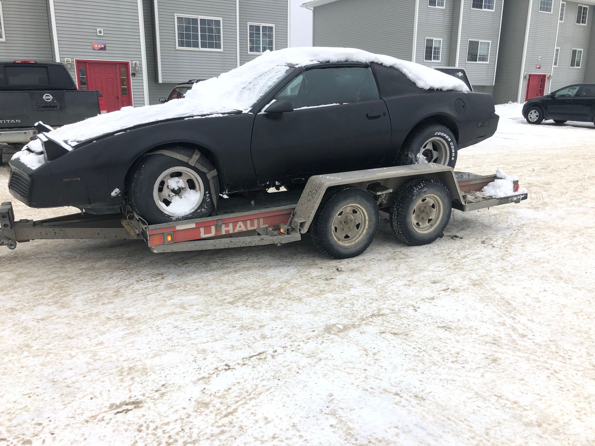

Hello everyone, I just purchased a 82 Firebird here in Alaska! Picked it up for $300. Previous owner said he thinks the starter went out so he bought a starter to go with the car but didn’t install it. Has a brand new Edelbrock Carb on it along with a New air filter housing. Also came with 2 brand new headlights. After getting the car to the house and looking over the car I have noticed that a lot of the fuses are missing. So naturally I replace the ones that are missing and the ones that wasn’t. In doing so I noticed that the fuel pump fuse location along with some others have no wires running to the fuse box and there is no where for a fuse. I’m no electrician but obviously that’s wrong. I also noticed that I assume where relays go for the IGN and a few other things was not there. Upon further inspection of the car the neutral safety switch has some wires cut as well. After doing some reading I’m assuming they had tried to bypass the NSS. When I turn the Key on I get dash lights, headlights, brake lights, and a dome light. And the push button to open the trunk works. Other than that I have no crank or anything. I’m new to the Firebird world and older car world but would consider myself handy as far as working on things go. Any help or shared knowledge would be greatly appreciated
