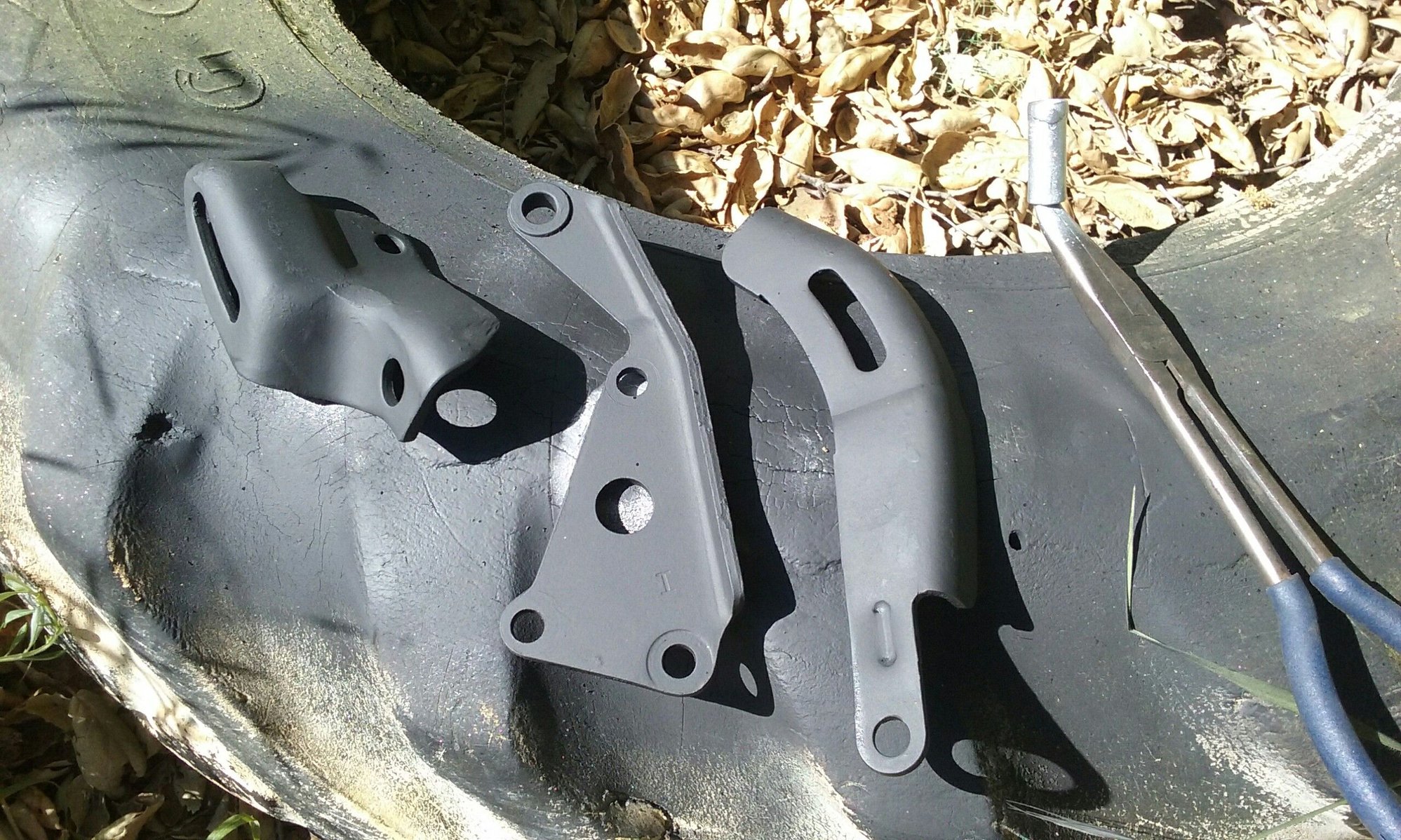

Does anyone know if these two brackets can be removed or are they necessary for the PS pump? I no longer have AC and am installing headers and would like to clean up the engine/bay.

Yes they are needed.
However... you could cut off the top of #1, maybe round it over somehow or something.

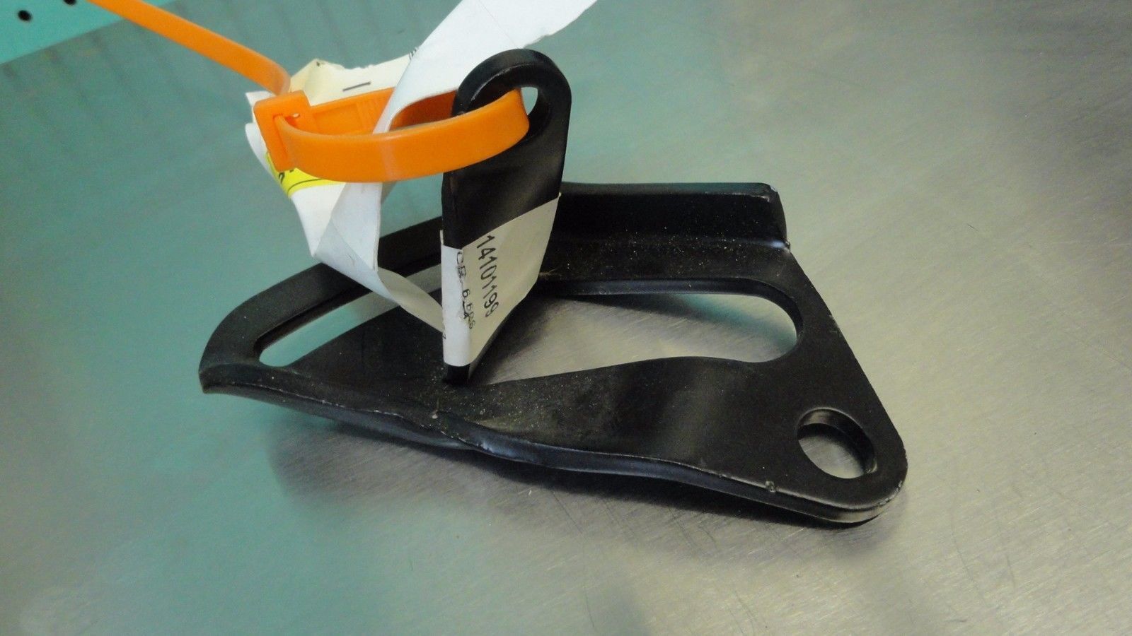

Here is he bracket that the non_AC cars used:

Thanks NoE, that's a huge help! I'm going to look at that bracket and see if I can fab one out of my current collection.

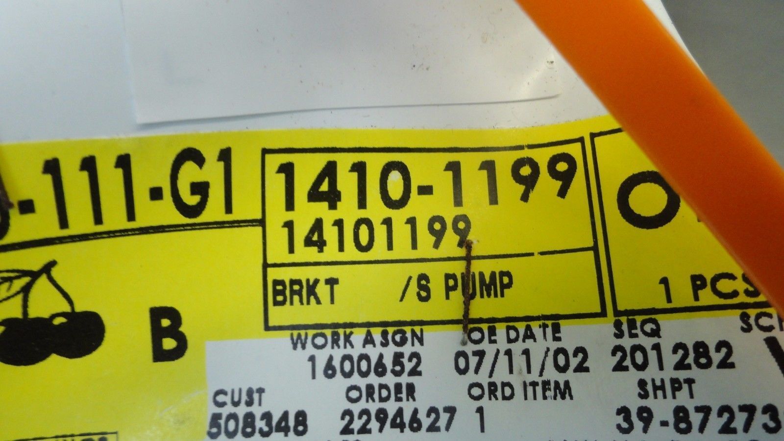

Part 14101199 Has Been Superseded
  • 00469560 is interchangeable with 14101199 since August 1, 2000 for the U.S. market;
  • 14101199 is discontinued since November 1, 1995 for the U.S. market.
Cars 14101199 bracket Fits
Camaro 1982...1992
Caprice 1982...1990
El Camino 1982...1988
Monte carlo 1982...1988
Chevette 1982...1987
Berlinetta 1982...1986
Impala 1982...1985
Citation 1982...1985
Malibu 1982...1983
  • Chevrolet
  • Chevrolet Trucks
  • Pontiac
  • GMC Trucks
Parts Related To 14101199 bracket:

Do you know if this lower bracket can be omitted?

Not really. The PS pump needs it. Or at least, what it does. The no AC version has the same feature but implements it differently.

I can't say for sure, but IIRC, there is an additional stud on the back of the PS pump that goes in the slot in that bracket for belt adjustment. It's a real PITA to get to also. Since you no longer have AC, then you can remove bracket #1, put a thru-bolt here, and cut the top part of bracket #2 off. Keep bracket #3 and #4 in place.

Excellent! Thanks guys. I've chopped the AC bracket down, fabbed up a spacer roughly the height of the manifolds to remount it to the headers.
