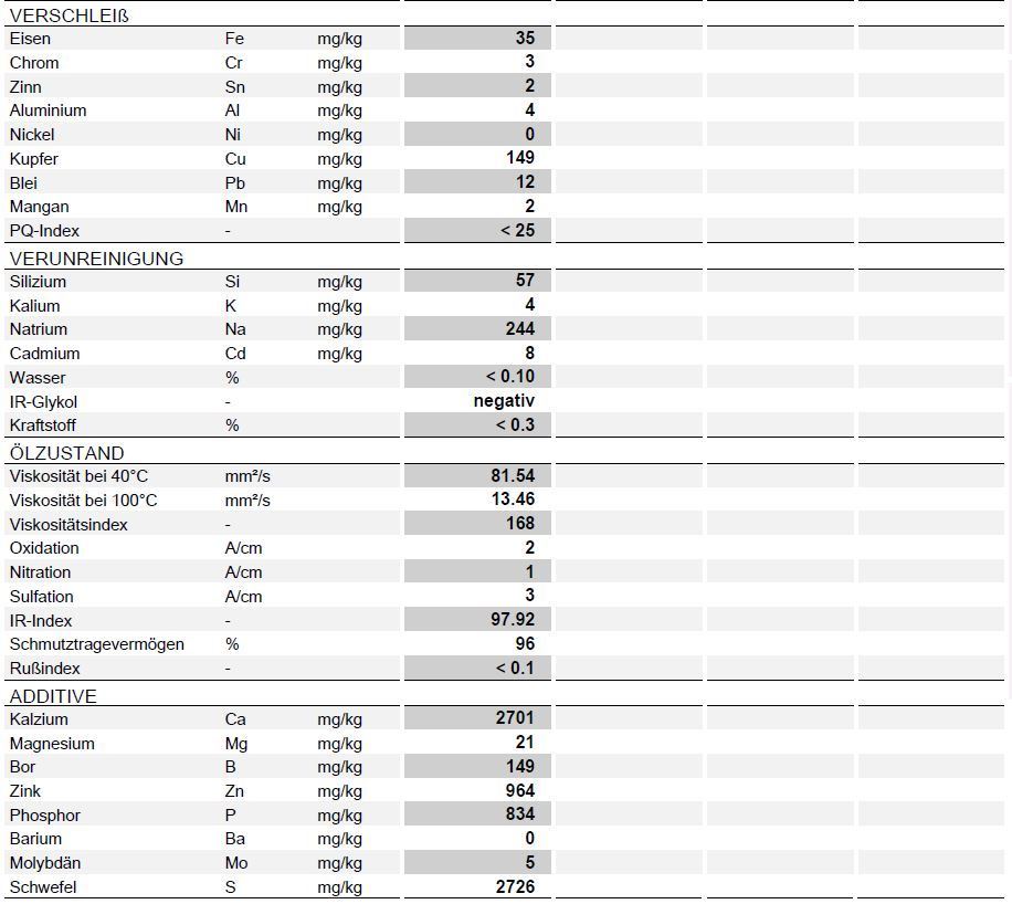

I've recently done an oil change on my 88 350 TPI. I've sent a sample of the used oil to a company that checks all residues of metal or anything else in a laboratory. They told me that I have an amount of 149 mg/kg of copper in my oil... How can copper get into the engine oil? I've sent a sample of my 92 305 to them at the same time, there is an amount of 2 mg/kg copper in oil, absolutely perfect.
How is this possible? Any ideas? The engine is bone stock and has just 20k mls on the odo. Runs strong without any problems or noises.

I believe GD may be onto something. If this is analysis on a relatively "fresh" engine the initial numbers could be high. 149 PPM (mg/l or mg/kg for you who have never been to the moon and back) is a relatively low level for a new/not yet broken-in engine. Did they also report the nubers for zinc, tin, and molybdenum in the analysis?

No, the engine is bone stock from 88, roller block, 350 TPI. I have disassembled the intake two years before because of a small oil leak on the rear china wall, while doing that I changed the valve seals because they were 30 years old... Everything is factory, except for a few sensors, plugs, wires and so on... It has original 20.098 mls on the odo today. Runs great, passes german emissions test every two years, doesn't smell, doesn't burn oil (new valve stem seals), gas mileage is fine. Oil pressure is NEVER under 30 psi. I know, the instrument is not as reliable as a manual gauge. From time to time I check the pressure on both cars with my manual gauge to verify that it "indicates" correct. You are right, I think I wouldn't be able to detect one worn rod bearing when the other bearings are good... I guess, I have found a way to get over this corona crisis or maybe it is an upcoming winter project. I need to buy oil for my garage heating unit for the winter...
They did, here is a screenshot of the other elements. It is obviously in german, maybe you need a translator.

No translator needed, since the periodic table is fairly universal.
What kind of oil was being used? How long has it been in the sump?
