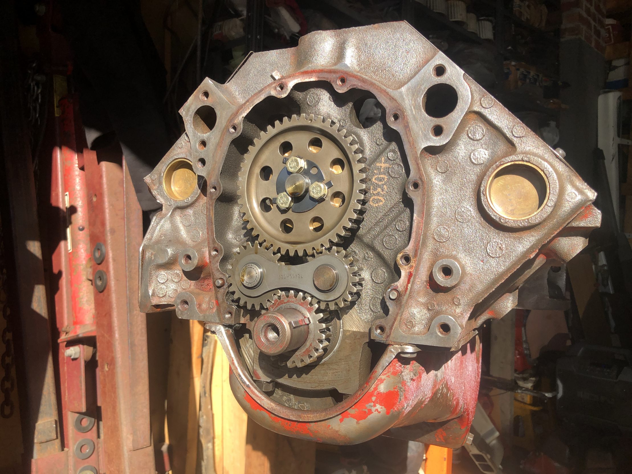

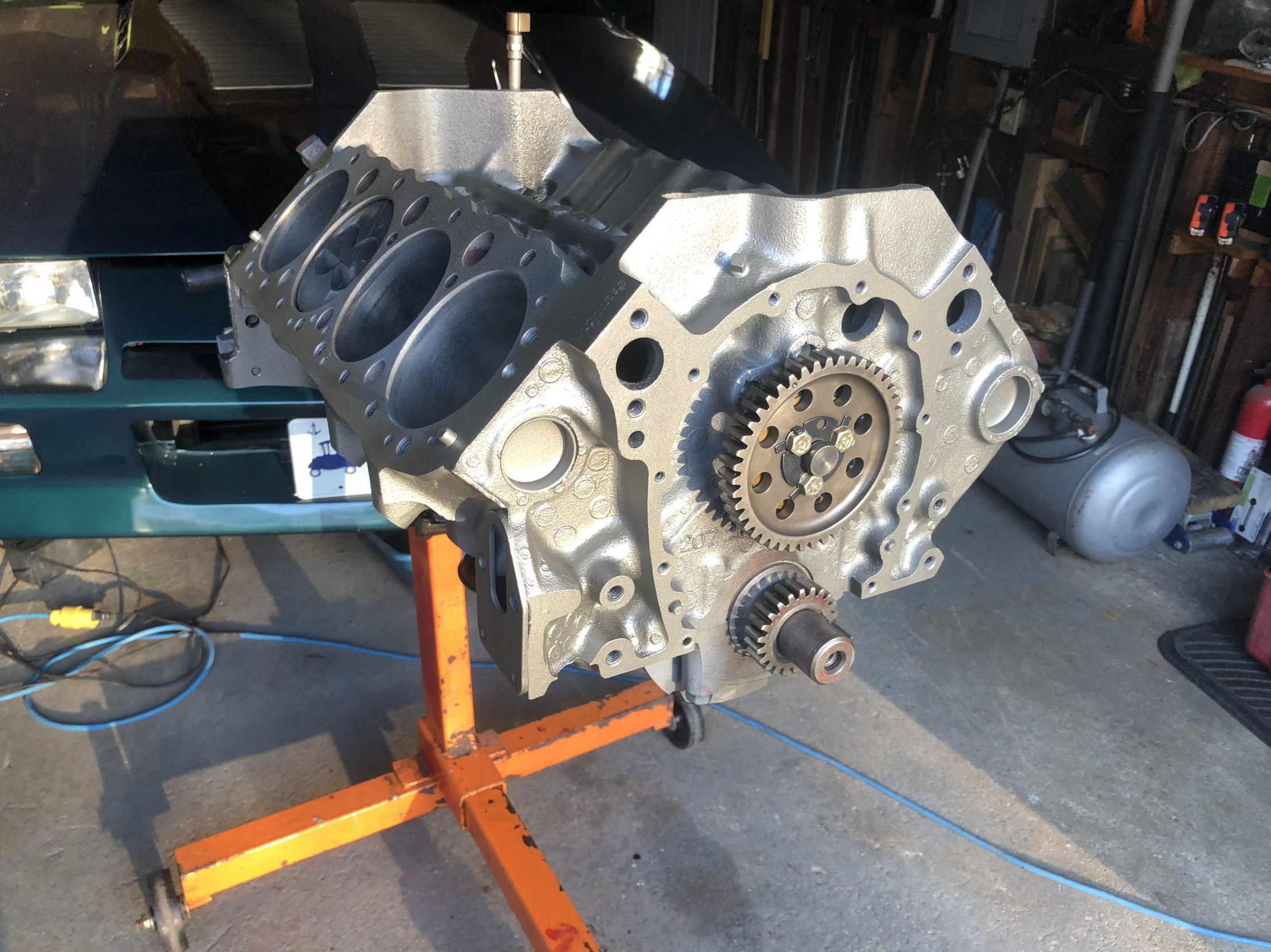

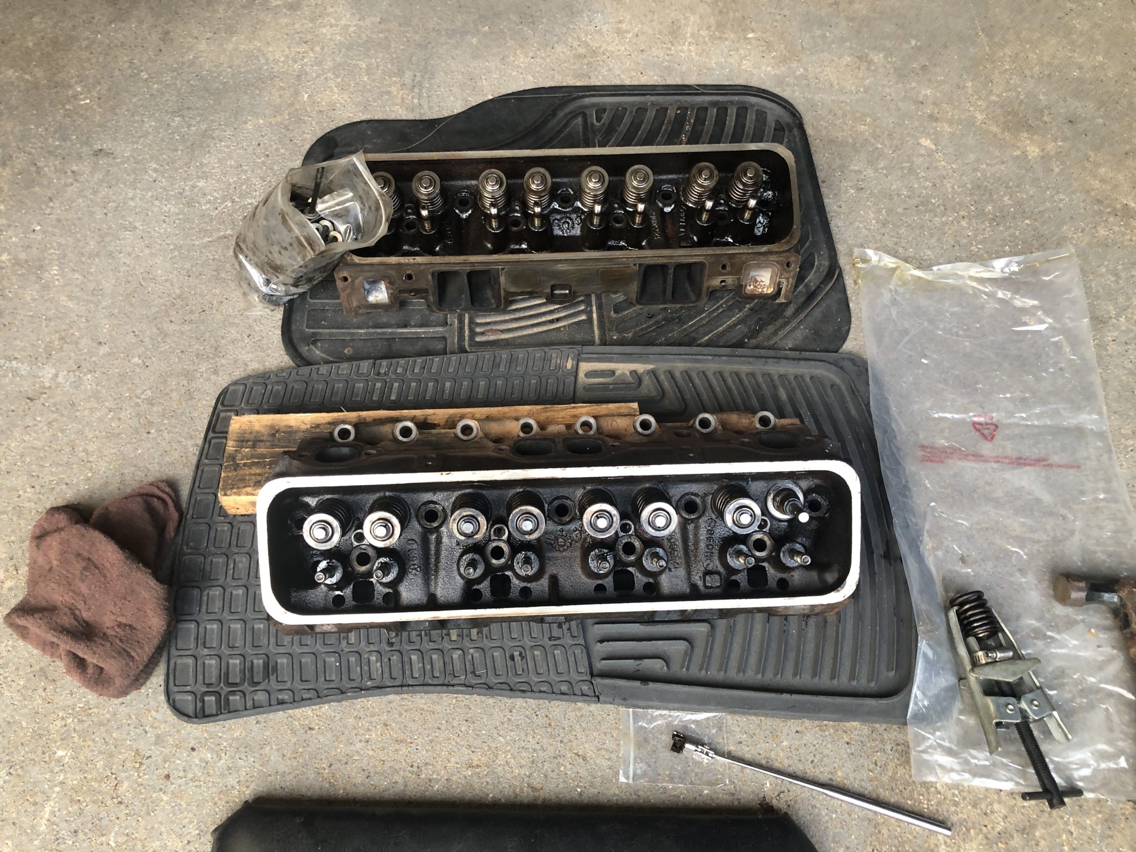

OK - awake from hibernation. I've got a quick question:
Got the pre-87 355 flat tappet hydraulic lifter block with Vortec heads....... What rockers am I supposed to use ?? Self aligning or not ??
The heads were recently returned to me after getting checked for cracks and I had the guy drill some coolant passages too. Started looking at acquiring parts for reassembly and wasn't sure what rocker arms I'll need. I've always built within the year range of the engine I was workin' on so if it was flat tappet it got regular rockers and if it had roller lifters it got self aligning rockers. Did not plan on using guide plates.........
I haven't started assembling anything yet and figured I'd ask before dealing with rod length and rocker arms...... I'm GUESSING regular pre-87 rockers ?

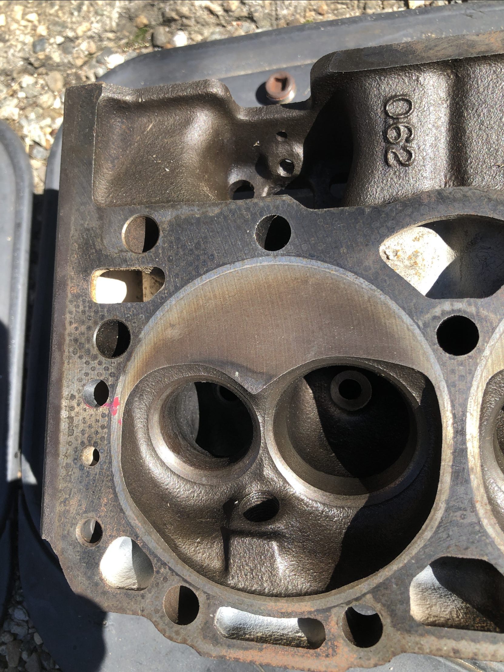

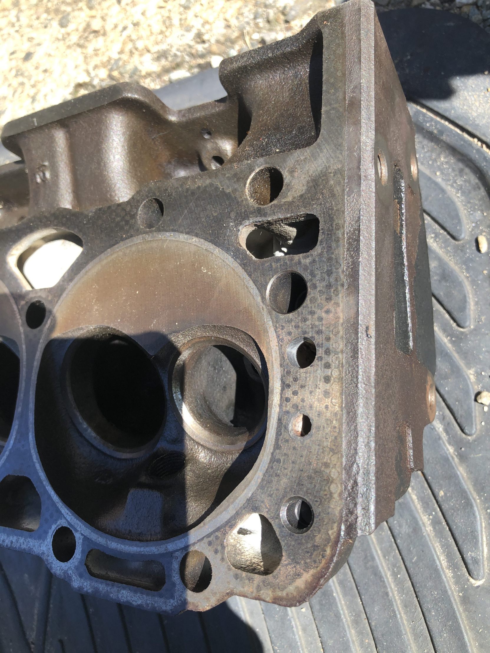

The push rod holes in those heads are too big to provide rocker guiding. You'll have to either use 87-up self-aligning, or install guide plates, or step up to $$$shaft-mount$$$.
You don't have to use a flat-tappet cam if you'd rather not. I wouldn't if I could avoid it. You can use a "retrofit" roller-tappet one. It'll require link-bar lifters, shorter push rods, and a cam button. Pretty straightforward.
Not sure about "drilling coolant passages". I've never done that to any heads except when setting them up to go on a 400 block. The block OTOH is a different matter... look CLOSELY at the 3 holes circled in magenta, bottom center: there's usually either a triangular hole or a round hole in the deck there, and those 3 holes MUST be COMPLETELY unobstructed to allow full flow through them. Lay your gaskets on your block and heads, and enlarge the holes in the deck to clear the holes in the gasket, if they don't already. Maybe that's what they did to the heads, in which case, good on them. Verify that they're COMPLETELY clear on both sides of the gasket, use a die grinder as required to open them up. That's a MAJOR cause of "mystery" overheating-like behavior other than boiling over; things like burning up the valve cover gaskets, excessive pinging, hard starting when hot, etc. The problem then is, the 2 center cyls on each side are "overheated" (cast iron is VERY hot) even though the coolant temp seems OK.
The gasket performs the function of regulating where the coolant flows. In that pic, grey is oil drainback, yellow is head bolts, red is dowel pins, cyan is the aforementioned 400 adaptation, and all others including the magenta are coolant flow. The hottest part of the heads is the exhaust ports, hence the ones across the bottom at the corner right under the front & rear exh ports, and the magenta ones and the 2 at the top center which serve the 2 exh ports at the center. That spot is far and away the hottest part of the head. The itty bitty holes elsewhere reflect the fact that there's far less heat at all those spots, therefore far less cooling is required.

He might be talking about drilling the internal coolant bypass passage into the Vortec heads for use with older blocks, water pumps, and Vortec intake manifolds that aren't setup for and external coolant bypass.

Yes; I was referring to the coolant passages that are missing / not drilled in the vortec heads. I've got an 88' style aluminum Edelbrock WP II plan to use and prefer the "internal" coolant bypass system on the pre-86 block. Here's a look at the new holes:

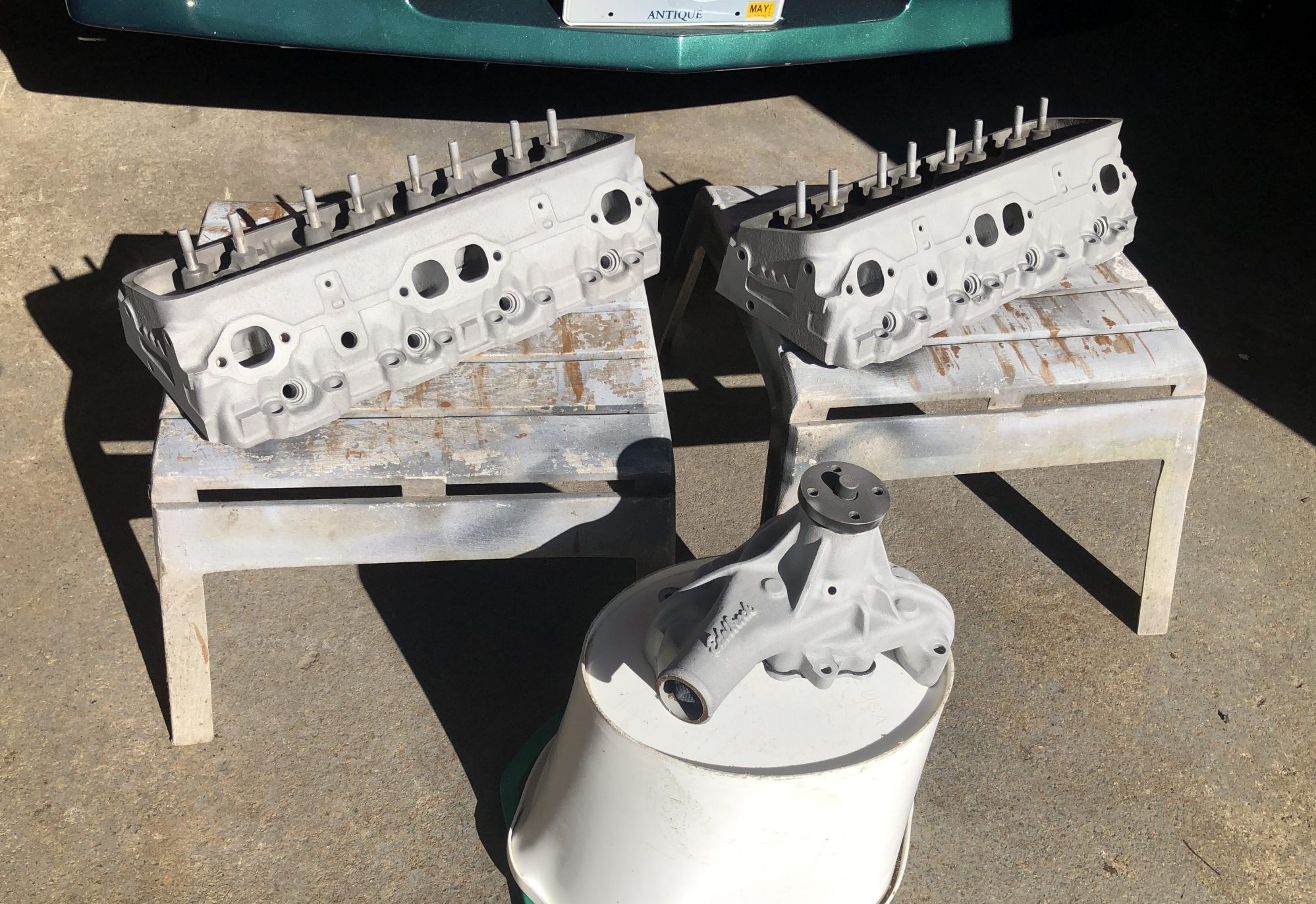

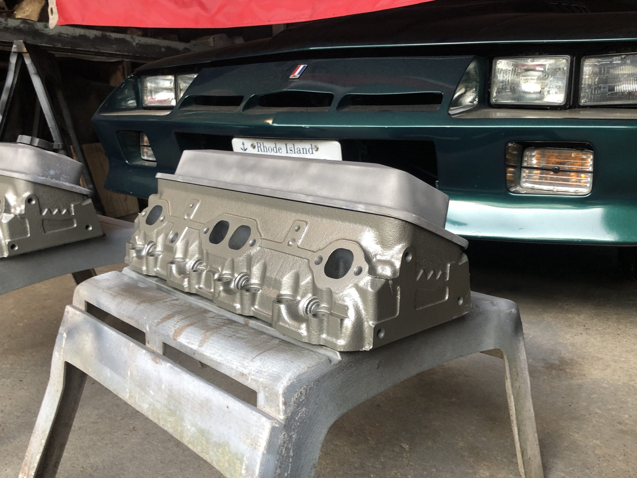

I finally found a little good weather & "spare" time to put some work in on these things. We FINALLY got some good weather for blasting / painting on the east coast this week ; still a LONG way to go,.... but you gotta' start somewhere !

Finally got a little work done on this; managed to get the block painted during that freak 80 degree late October day a couple weeks back so at least now I can mess with it little by little during the winter.
How it looks after sitting under my bench for the last decade or so with 2 coats of paint on it: ( Motor, 85' 4-BM, 2-Pc RMS, .30 over, Gear Drive; was rated @ be 350HP when 71' Vette heads were installed on it with 1.5 rockers.) https://golenengineservice.com/
Here it is after the strip-show:
Here it is after the rattle-can paint job
I'll list the stuff I've acquired for rebuilding the heads soon, just waiting for a couple more things to arrive.
Having some trouble with the head gaskets: from what I'v read I should be trying to land @ about 40 thou of clearance; the feeler gauges I've got only got to 30 thou and there's still gap so the piston-to-deck is above 30 thou before even considering what head gasket to use. I'm just using a straight-edge and feeler gauge,... should I get a dial gauge for this measurement ??

No, the way you're measuring it is completely acceptable, and your results normal. (unfortunately) Even if undesirable.
Best way to cure it is to deck the block to the nominal dimension. Correct distance from crank centerline to deck is 9.000". Factory blocks are almost always over at least .015" more than that, and uneven besides (check the 4 corner cylinders to determine that). Most "rebuild" pistons lower the piston .020" in the block from stock (pin center to crown height 1.54" as opposed to stock 1.56") since that's "safer" than going the other way or even just leaving it stock due to the large number of blocks, back in the day, needing MASSIVE decking due to scour marks from blown gaskets. That's not as big of a problem today as it was in the 60s & 70s, butt the custom has remained. Virtually all cast, most hypereutectics, and many forged (SpeedPro/TRW for example) are like this. Crank grinding makes it worse; wear on the crank is concentrated on the TDC point (duh), thus if you (machine shop) "offset grind" the journals a little bit you can scrap fewer cranks, at the expense of further increasing the deck clearance and lowering the compression at the same time, and your customers almost never will know the difference. Might be worth measuring the actual stroke as well: you might have any or all of those factors in play in your motor.
This is the kind of attention to detail that allows the Edelbrock RPM "kit" to dyno 435 HP or whatever it is when they finesse a motor and dyno it, butt people in the real world that just buy it and bolt it up, hardly ever break 275.
Re: Vortec question:
That said, yes, 40 thou is the number bandied about. Safe distance for adequate clearance and tight enough to get that desirable mixture motion happening.
A few things to consider after having dug into this in some detail.
Piston top profile enters into this. A dish with little to no quench pad kind of kills the whole deal. A flat top is ideal.
40 thou isn't the be all and end all I've learned. Depending on the compression ratio and the type of fuel you wish to use, the detonation resistance that a tighter quench allows might not be entirely necessary.
Similar to yours, my 1st Vortec engine was a 350 with a piston below deck of .035". And as Mr. S pointed out, this varied from front to back and corner to corner. Best was about .030" spot on and the most was at or near .038".
I opted for a .026" head gasket (Mahle 5746). The math says quench was better than .060".
CR came in at slightly less than 10:1 and combined with the cam of the day (there were a couple at least) the engine performed very well. Mileage was excellent and was a solid daily driver. "Peppy" too.
That said, I've gone out of my way to try and get the ideal quench in my more performance orientated engines. Going less than 40 in some cases but eventually settling in on exactly that number.

Awesome input - THANX !
At least I'm a bit more comfortable now about figuring out the head gasket than when I had first thought to consider it. Primary goal now is to get myself a "better" straight edge, then take a full set of gap measurements measuring from the center of each piston to avoid errors from piston "rocking". Hope that just over .030 is my largest gap, the heads were never decked,.. but the block might have been.
I'd read that the gasket bore size should be at least .030 to .060 larger than the bore and if a 355ci has a 4.030, and my compressed size is .025 and smaller than I'm starting my search at summit of 7 gaskets ( 3 of them @ 4.060 & 4 @ 4.1 ) Of those 7 gaskets the thinnest (compressed) gasket is .015; that added to my deck of +/- .030 is already over the .040 that I'm aiming for. Basically looks like I'm gonna' be ordering at a real slim steel shim: Fel Pro 1094 is a 4.1 bore and .015 thick @ $27,......... and Fel Pro 7733SH1 is a 4.1 bore and .016 @ $11 each. There are a couple COSMIC MLS and a copper option too, but @ $70-90 each gasket - and they are .20+ compressed. ( and Yup; Mahle 5746 @ .026 )
Once I can clean all the carbon from the pistons ( Thanx Edelbrock 750 ! ) and 'feel it out' again I'll repost the piston gaps a for later reference. Also gotta' find a set of feeler gauges with .030 and higher fingers !
