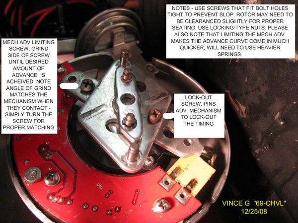

Handy pic from the Crankshaft Coalition Wiki. Should be helpful.

Re: Fresh 350 build. Needs high base timing (18°+) just to idle?
^^^ That would be a modified HEI.
Something I've had to address with the substitute distributor installed when troubleshooting an ignition problem. Welding up the advance slot is another approach but like the mod posted above, it's a cut and try kind of deal. But that's tuning for you. Sometimes never simple.
Nice pic by the way. I may try that approach.
Tuning is the part that leads to someone having an average engine vs a good or very good engine. The distributor stuff is really important, perhaps the most important part to actually making power. It's also probably one of the more mystical to most as well.
Ouch... Yeah, I may just run this motor as is. Not much room to fit anything in the sides and that would require a bunch of modifications. It easily breaks the tires loose now and my wife is happy with it so far Maybe I can build a separate motor that I can put in later.....
