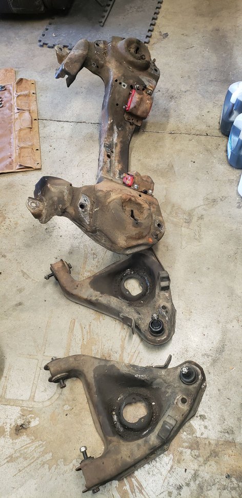

Anyway the crappy Summit Racing pan leaks because the fitment is horrible, the drain plug design absolutely sucks, and the firment is such that it is impossible to remove the pan with the engine cradle in place. So today this happened:
I decided I really want the ability to pull my oil pan at any time so an UMI K-member and control arms are on order. And a stock GM Performance pan and gasket are ready to go in.

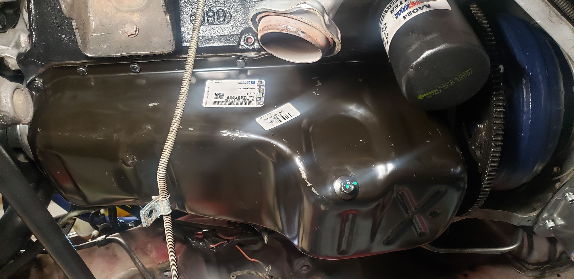

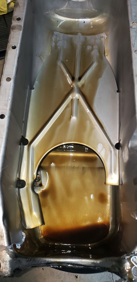

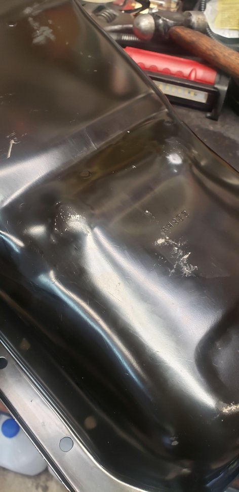

I changed out the spring, and the new pan is fitted. I did have to modify the pan a little with some clearance bumps for the Vortec main cap bolts with their splash shield mounting studs.....
The pan was clearanced to fit flush against the block without the gasket so with the gasket there won't anything touching the pan. And I did check that the pickup tube is appropriately positioned.
