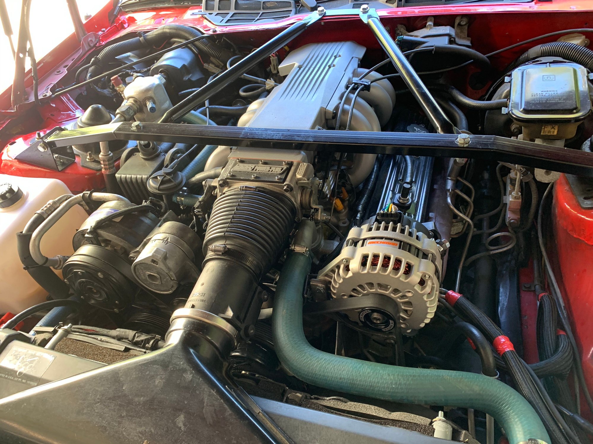

Old Jul 3, 2020 | 07:52 PM

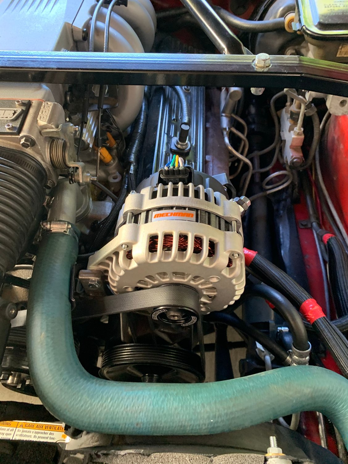

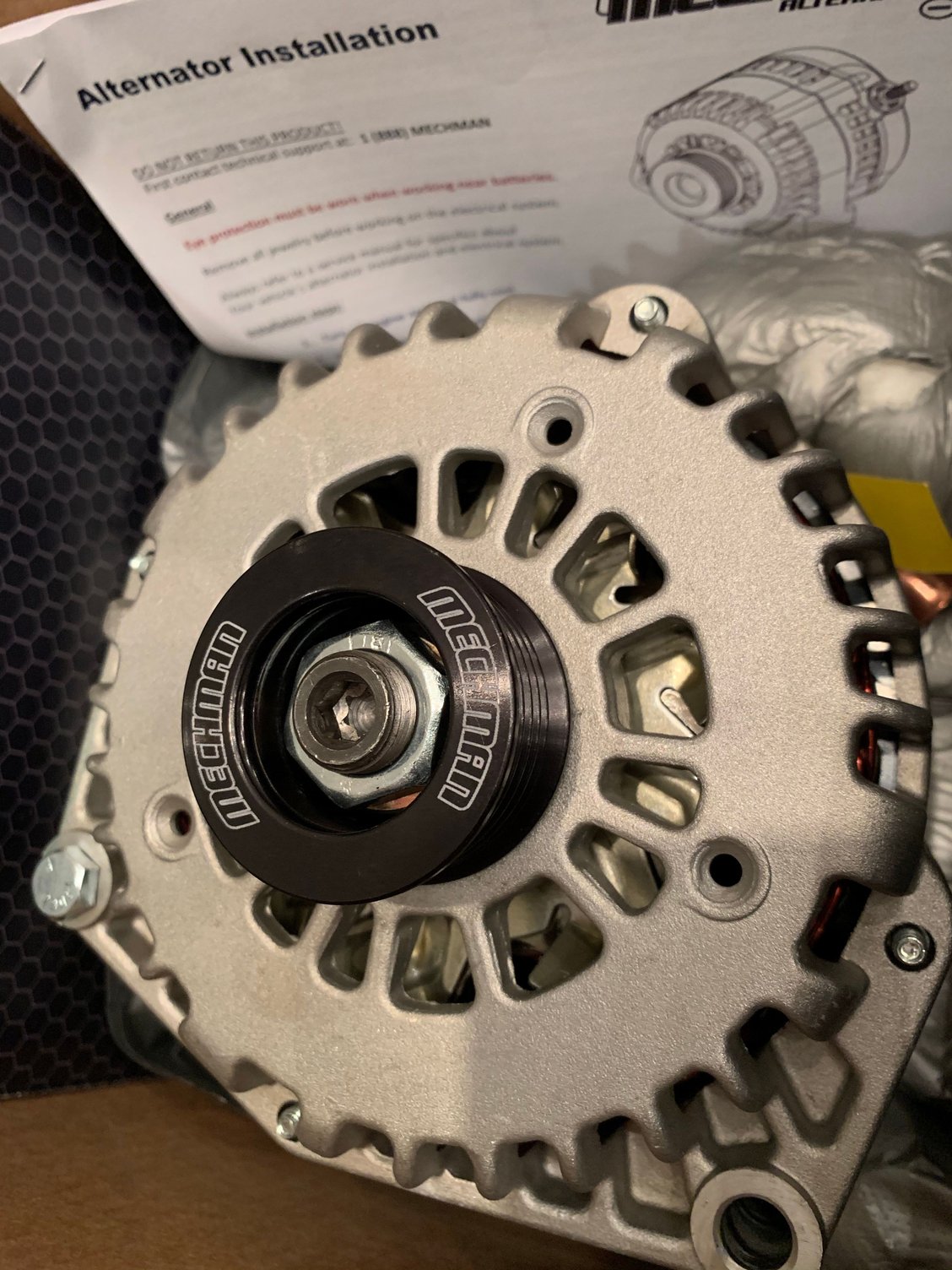

Vote for Mechman 240 amp alt. Have it in my 92 and this thing ist a little nuclear power plant. It's a direct fit for 88-92 models and comes with the needed adapter fot the two or three wire plug. I upgraded to I/0 battery cables from Innovative Wiring, the factory door bell cable is too small to handle the load.

What the last two posts said is you also need to replace the alternator cable. The factory one is too small and will cause voltage drop, heat up, and may melt the back of your alternator as it did on mine :-). Bump up to at least a 4 gauge battery cable. I went with a 2 gauge for my 200 amp alternator. The improvement was very noticeable. I used a 48" one from Autozone. 100 amps is a lot of amps. The voltage doesn't matter. 200 amps is that much more. The quality of each connection (grounds included) is very important with that many amps.

No bracket needed. Its a direct fit to the original 88-92 mounting location. What you see in my pics is the original mounting bracket, just powdercoated.

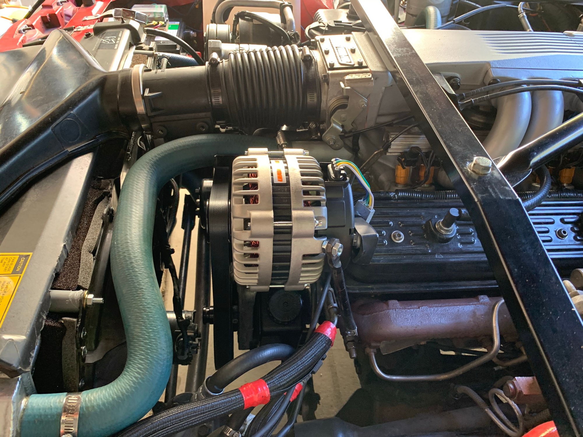

I bought the 200 amp Powermaster from Summit for my stock 89 L98. It is not a drop in replacement. The front two holes line up but I needed to get creative with the bolts. Also, the rear bracket needs to be reworked but I got it in. GD's comments have me a bit worried but so far everything is working great.

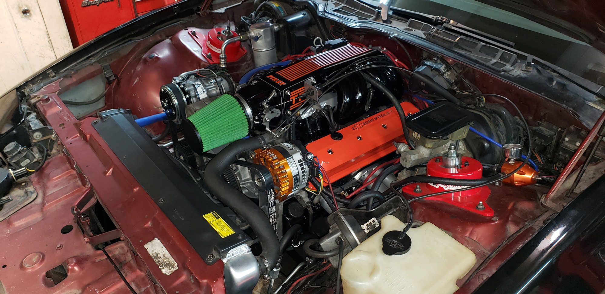

GeneralDisorder's Avatar
Joined: Mar 2017
Posts: 4,255
Likes: 427
From: Portland, OR
Re: Best Drop In High Output Alternator?

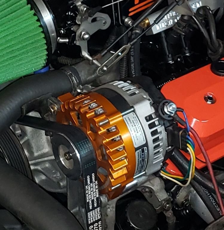

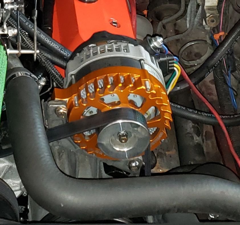

My first Powermaster lasted 3 months. Summit exchanged it no problem. Replacement lasted 9 month. I tore it down to put their quality on blast because it irked me to no end. I also repaired their junk to better than new and stuck it in a customer's box truck (93 P30 chassis). I had one of their starters also that lasted 6 months on my stock 305. Couldn't repair that one - it was just a mangled pile of chinese recycled sewer pipe, used condoms, and tears of aborted female fetuses..... You get what you pay for. In Powermaster's defense (if you can call it defensible) you can't source quality parts for the CS130. Believe me I tried when I repaired that junk.
The DC power offering is a 180 amp and can be anodized in your choice of color. Fitment is perfect and it's a small case alternator that looks more appropriately sized compared to stock.
GD

Nice looking unit. How do you like that FIRST intake? What else do you have done besides headers? I have a set of Dyno Don's headers to go on next, but need and intake to support heads and cam and future 383 cid.

The FIRST intake is great as are the Dyno Don headers and y-pipe, etc. It's on a built 350 Vortec with cam, valve train, etc. It's about 400 HP. You can check out my thread on the dyno results, etc. The FIRST intake can support much more - Ken has customers with a lot more cubes that are up over 600 HP naturally aspirated.

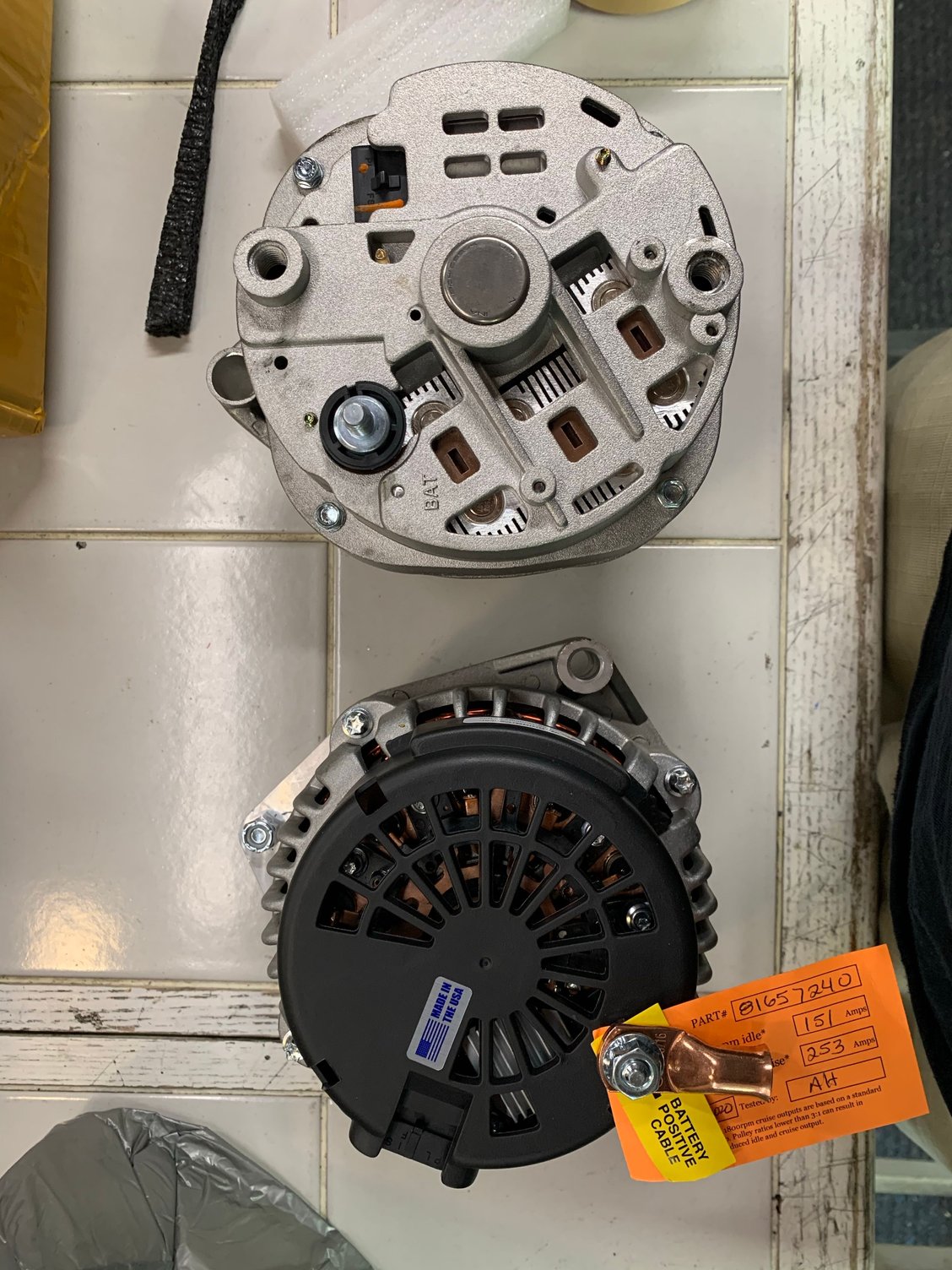

https://www.rockauto.com/en/catalog/...generator,2412
P/n 88877302
This is what I'm running. The link I posted above is how you install it.

I have a Mechman unit 170 amps.

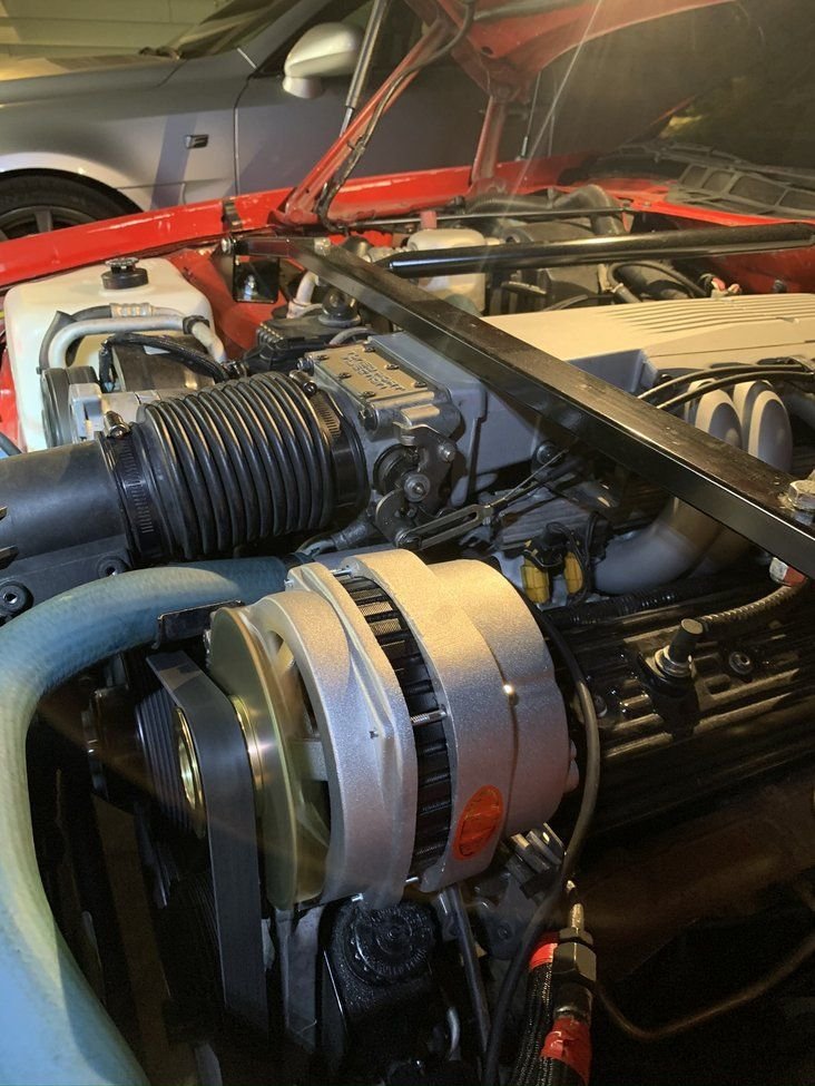

Well, I'm a little relieved. I read GD's Powermaster thread and turns out I went with a CS144 size. Doesn't at all look like the 130 model. I also did not go for the XS version. The CS144 is much larger and much heavier than my CS130 AC Delco Professional one that burned out so I am hoping there is more than just case size to the internals.

Yes and not exactly. This thread documents my experience.
https://www.thirdgen.org/forums/tech...-required.html
I was able to use the front two bolts locations but I needed a new (longer) upper bolt, nut, and ground down washer as the alternator has no threads in its housing. I was able to mount and use the alternator without the rear brace but the conventional wisdom here was that it is needed over time. I ended up removing and bending/fabricating the old brace but it wasn't without effort (I heated and pounded a bigger flat area on one end (yes blacksmithing I think), then drilled a new mounting hole, and after a little bending, got it in.

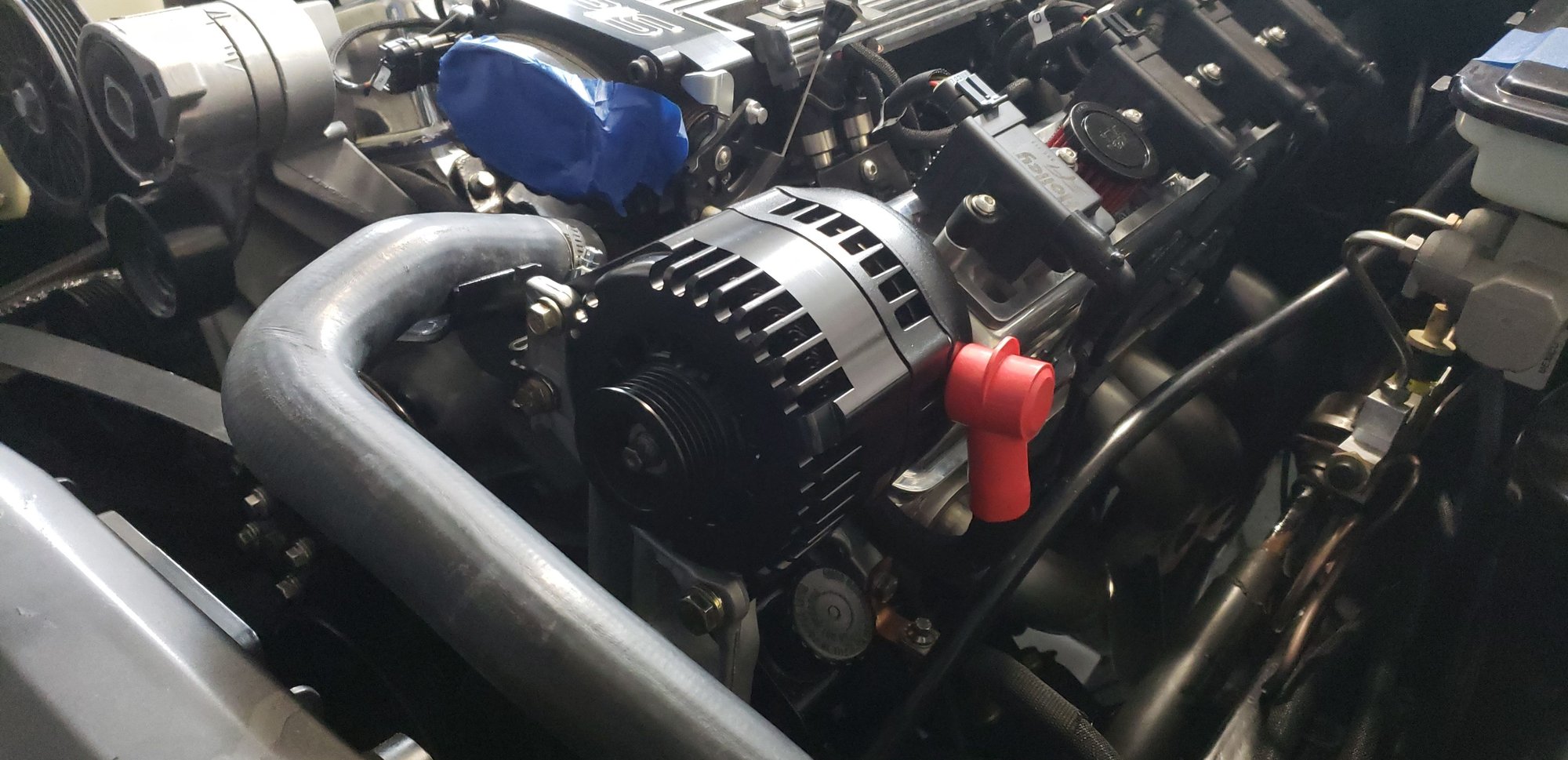

One other nice side benefit of the DC Power and Mechman units are they have internal fans. It's a bit safer and cleaner without the fan out there trying to snag on fingers, cuffs and loose clothing. Not a huge deal but I prefer an internal fan.
I've personally used about a half dozen of the DC Power units for various applications and haven't had a single issue. I really hate seeing people support Powermaster after the quality issues I've seen. It's pretty obvious what their game is.
GD

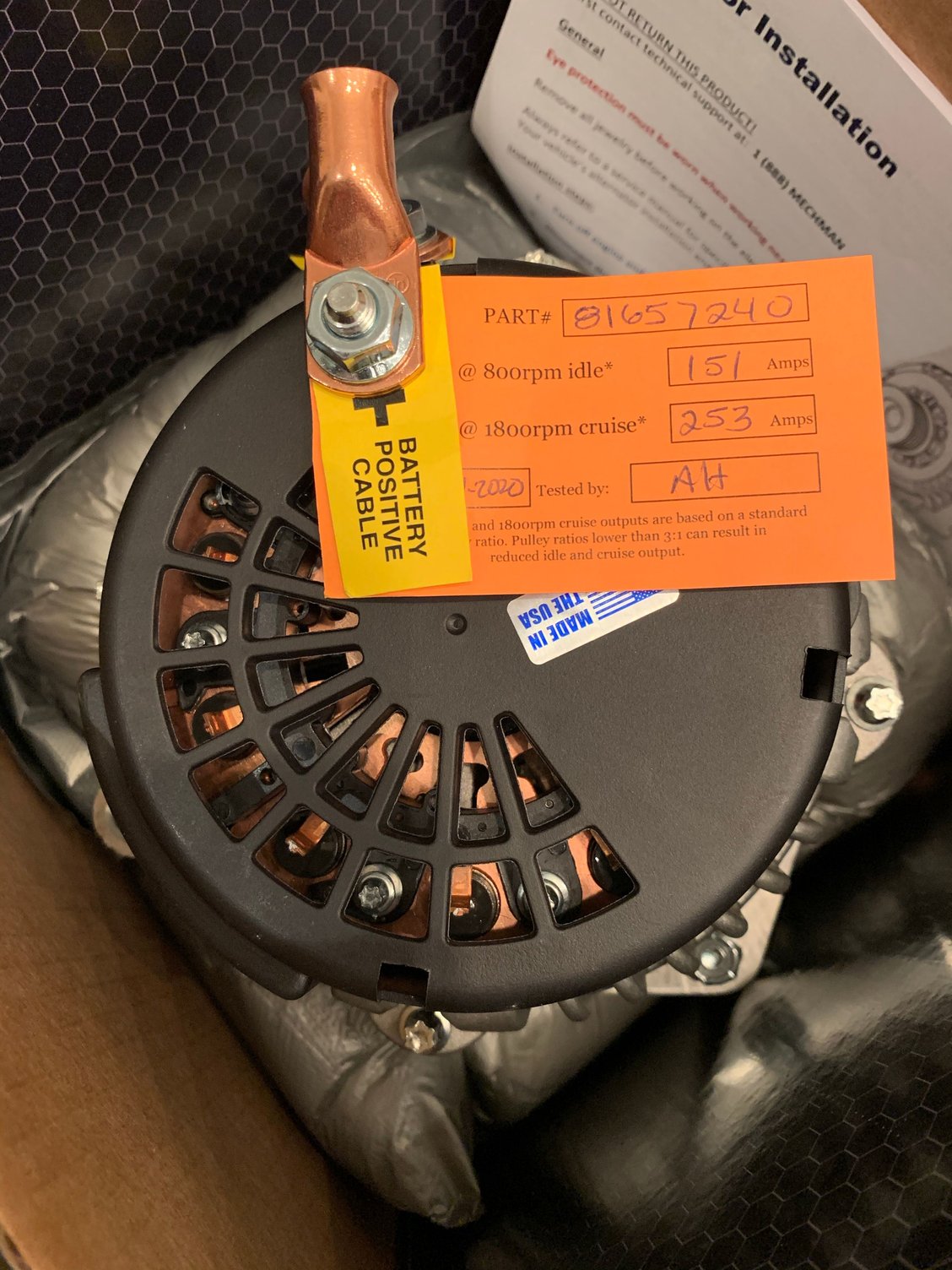

I know when I got my alt it came with a spec card. Idle amps, idle amps hot and then max amps and max amps hot. Mechman was really easy to deal with on the phone. I would have delt with DC power as well if I had to but it didnt turn out that way. Hear alot of good things about those 2 companies. I did try to deal with 2 other companies out there , forget the names. But the interaction was terrible and one actually told me I had to modify the factory bracket, no thanks. They both lost the sale in the first minute on the phone.

Yep. Other than waiting about 3 months for my special Orange anodizing (totally worth it), DC Power has always been excellent to deal with including rushing an alternator we needed for our booth car at one of the local events.

You can get these in any color combination anodized and colored pulleys. Just ask them on the phone when you call. I was going to go with the 240 amp but for my application and racing it they recommended the 170 amp. Think it makes 140 at idle. I dont have any kind of stereo. That orange DC alt looks really nice too.

What color scheme you get?

Got the Mechman in. Too bad it is DOA. Nice looking paperweight. Checked everything. Should be charging. I will contact their tech support on Monday.
That's a known problem on 89-92 cars. You have to swap the green and the yellow wire on their adaptor harness vice versa. Then it works. Ran into that myself on my 92 and figured it out after half an hour of head scratching... because in my 88 it worked flawless. I thought I must be a complete fool, but on 88 cars you have different wiring on the connector than 89-92.
Wait, WHAT?!
Holy cow. I will give this a go. I tried to find internals for the alternator but no go. I figured it was something like this. They are going to get an earful on Monday as to WHY I wasn't provided this info. I will swap the green and yellow and report back.
Wait, WHAT?!
Yup, I bet this will work. I reported this issue to mechman support (which answered within three minutes!) and got a reply that the are thankful and they will tell the technicians... That was in April... it seems that they didn't. The "L" terminal on the mechman alternator needs to be connected to the "F" terminal on the original alternator plug. On 88 cars you have three wires on the connector plug, on 89-92 just two. And that's the problem.
That worked! Thanks VERY much. The car woulda been outta commission for the weekend.

Weird..... mine is an 86 but with a serpentine conversion and I swapped to the serpentine connector on the car side, then used the DC Power adapter and had no issues. The DC alt has 4 terminals, the adapter only has 3 wires, and the car side only has 2 of those that actually pass through to pins with wires. The adapter I got from DC Power has 4 pins on either side, but only uses three wires - one of the 4 is cut off flush with the car side adapter..... they must have figured out what I was doing because I told them to base their alternator build on an '89 because that's how I wired it when I converted to serpentine......
I have to say - DC Power is smaller and a little more "custom" in the way they do stuff. When you call you usually talk to the same guy - I think the guy that I usually talk to is the owner. They asked plenty of questions when I ordered (phone order) and likely used this information to pull up a wiring diagram. That's my guess anyway because I am wired for an 89 and their adapter worked out of the box.
