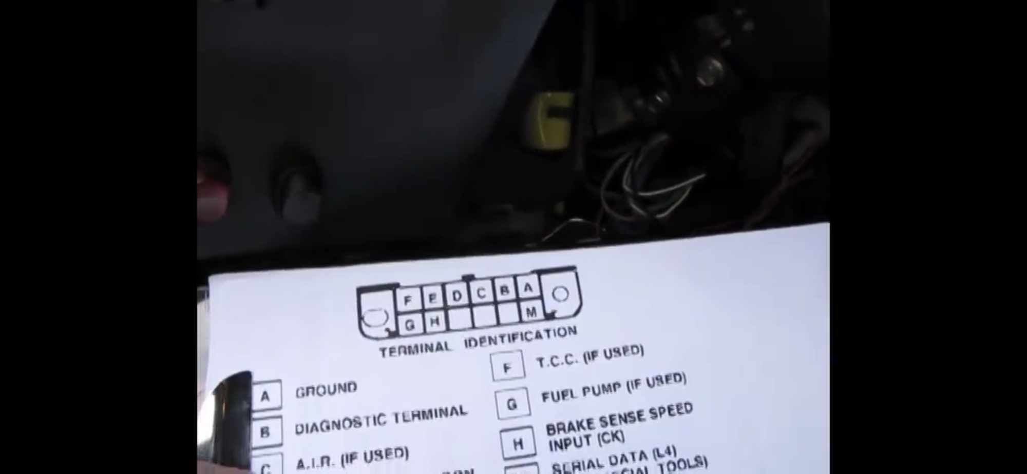

I wonder if you have a Camaro that has the self check in the obd plug I would check and see because if I remember correctly all you have to do is run a jumper wire and the cars check engine will flash a certain amount of times for you to get the code. Hope that stuff helps good luck

you want to keep the key off and on the A and B connector use a paper clip to put in there. Turn your key on and the check engine will start it’s diagnostic. It will flash a number twice like 1 and then 7 continuously before it flashes the code you want so expect a same type of pattern at first it will be like 1 flash then 7 flashes then 1 flash then 7 flashes then it will flash the code you want
