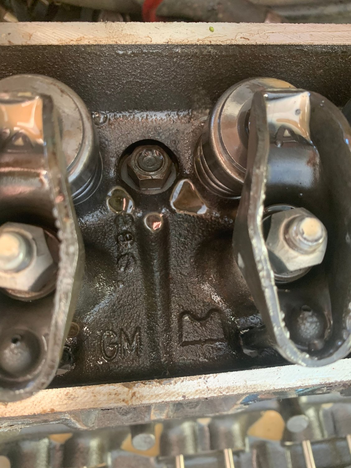

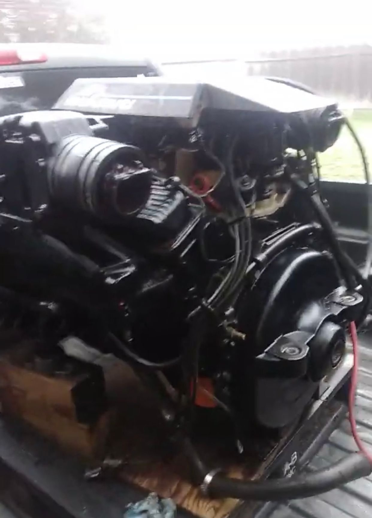

Here’s my build of a marine engine 305. If you guys haven’t seen one then jump on in and check it out. Chevy built these engines specially for boats. Some say they will out live cars if you use them. They call this one the black scorpion. I’ll update as I go
Camel hump heads is what you want. Only thing is they aren’t aluminum but that’s ok for what I’m doing.
Head numbers

That's just rusty hot garbage - essentially a mild upgrade to the LB9. Can't give them away. Just pickup a Vortec 350 that's worth your time.

Those heads (081 casting) are in fact LB9 heads. The exact same part # as the 305 TPI motors had from 87-92. They aren't "camel hump" ones like the ones from the 60s & 70s, like 186, 462, 492, 041, etc.; or the earlier ones like 461 (that didn't have the bolt holes for accessories). Decent enough heads for their day but not the same. The casting date (J126) means that they were cast on the 12th day of the Jth month, (the 10th, October) in a year ending in 6; most likely 86. The boat it was installed in was probably a 87 year model.

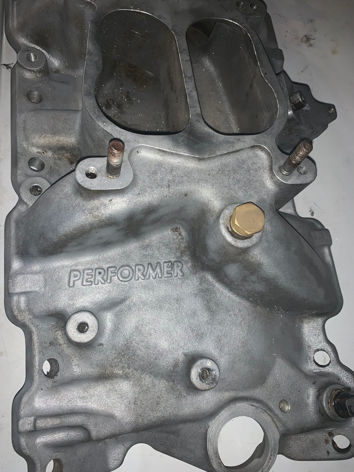

That intake isn't native to that motor. It's an Edelbrock Performer. That never came on Merc motors that I'm aware of. In fact it puts the carb at an awkward angle, for a boat; the correct Merc intake would have the carb parallel to the block mounting surface, because in a boat, the motor sits level rather than being tilted back like it is in a car. I have one out in my garage I could take a pic of to show you if you don't believe me. The one I have is a Merc 888 (188 HP Frod 302 2-bbl) but the principle is identical. The original one was probably cast-iron, not aluminum like that one.
The cooling system in a boat pretty much ALWAYS dumps water into the exhaust. That's just how it's done. In fact the exh manifolds have water jackets and are cooled by the water exiting the engine before it passes into those elbows on top of them. The thermostat isn't just open/closed like it is in a car; in a boat motor with seawater cooling like that one, when its closed the water goes one way, when open it goes another, rather than the flow just being blocked. There are 2 water pumps; one in the stern drive, and one on the front of the block just like in a car. The thermostat operates at a MUCH lower temperature, something around 140 - 150°. In a boat with a closed cooling system, there's antifreeze in the motor, a "heat exchanger" that the coolant goes through and the seawater cools, and the seawater is pumped from the stern drive through the HE and from there to the manifolds and elbows.

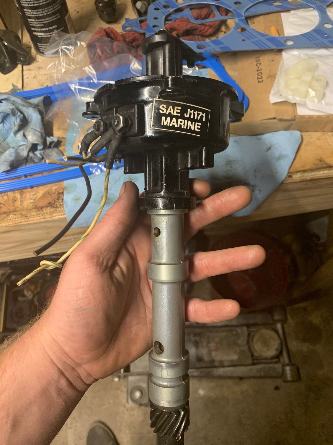

There's nothing particularly different about a boat motor compared to a car one, regardless of what you may have "heard". That Merc 228 or 230, I forget what Merc called the HP in 87, is basically the same motor as the LB9, with possibly a different cam and of course all the marine cooling system external oddities and whatnot, like the distributor without vacuum advance, the fuel pump that only puts out like ½psi, the carb with the weird vents, and so on. It's still just a 305. The same underneath those external parts as about any other 305 from the same time frame, except that it has the better heads (not the swirl-port TBI ones). Just as futile to spend money on, thinking you're going to make it competitive, as any other 305 that anybody else has ever come up with that idea over; and just as destined to disappoint.
