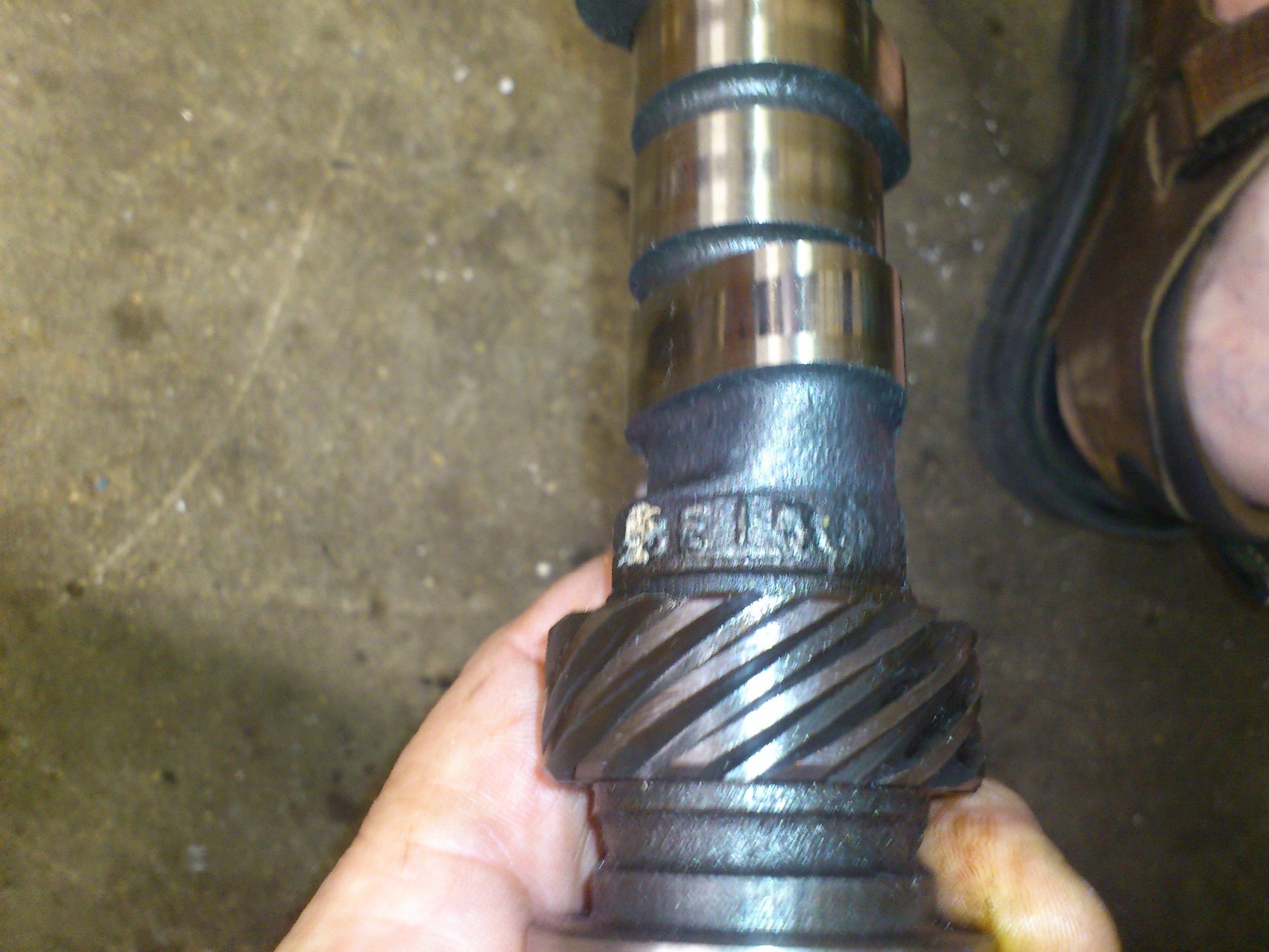

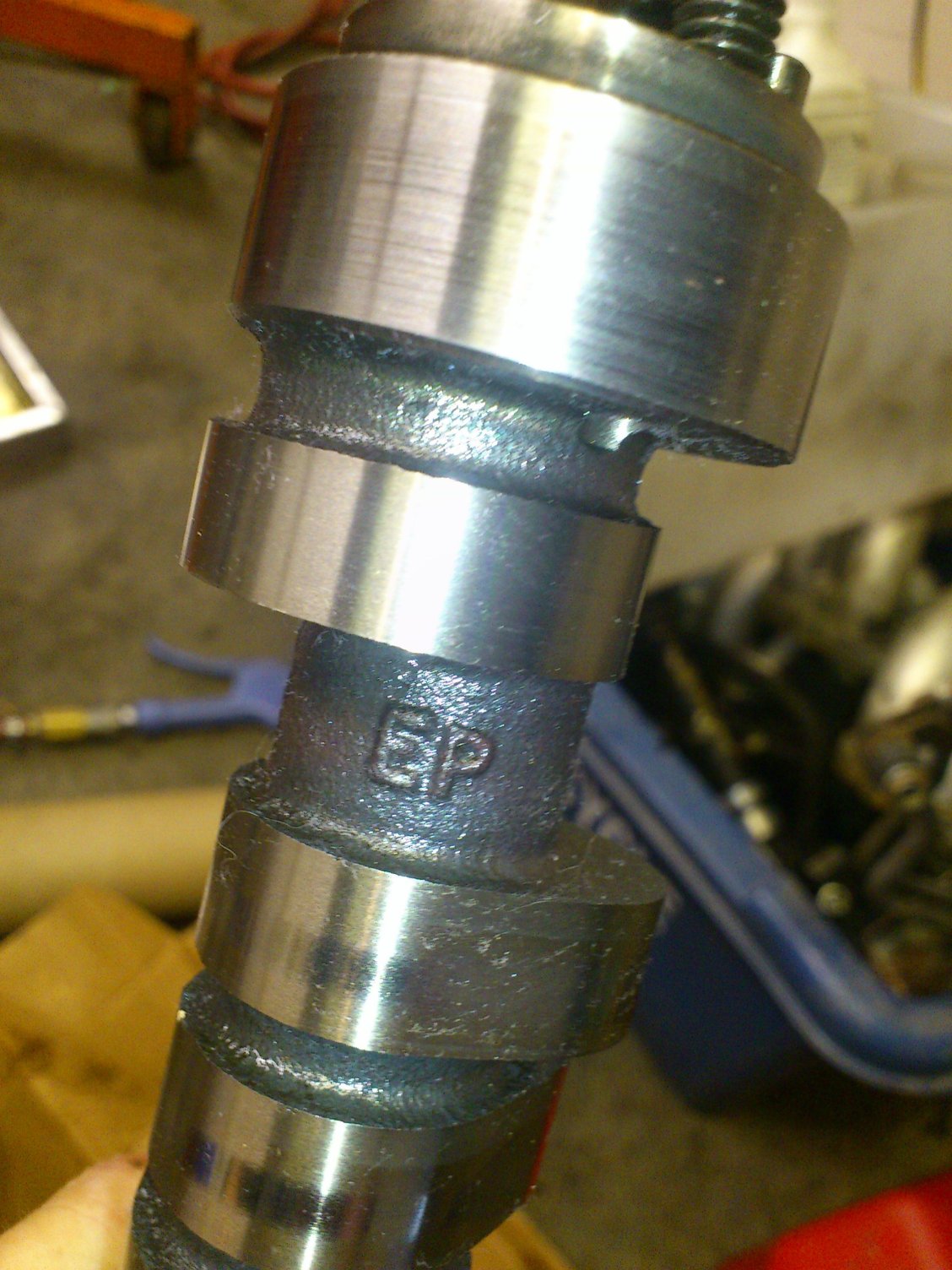

absolutely spray penetrating oil into the cylinders,and do it more than once.many recommend diesel as well,im not sure which would be better but you have to try.when you try to rotate the engine again,baby steps .try a gradual back and forth with the breaker bar(and the crank bolt adapter if you get it),if it doesnt move,spray again and wait and try again in a day or two.do not skip this step as it may be the only way you avoid seriously scoring the cylinder walls necessitating a potential hone or overbore.such a shame with so low mileage,but hopefully you can get it to rotate again.keep us posted.

MY BAD im used to a stick,good point,thanks.i deleted that part.im looking for help id-ing a cam i just pulled out of an L98 TPI engine,i dont know if you can help or know someone who might know.im in the middle of a cam swap,pulled out this cam and was a little confused as its a cast core roller cam.here are a couple pictures,any help will allow me to either put this cam back in or throw in my new 7151 baby hotcam (this is NOW a carbed build)
