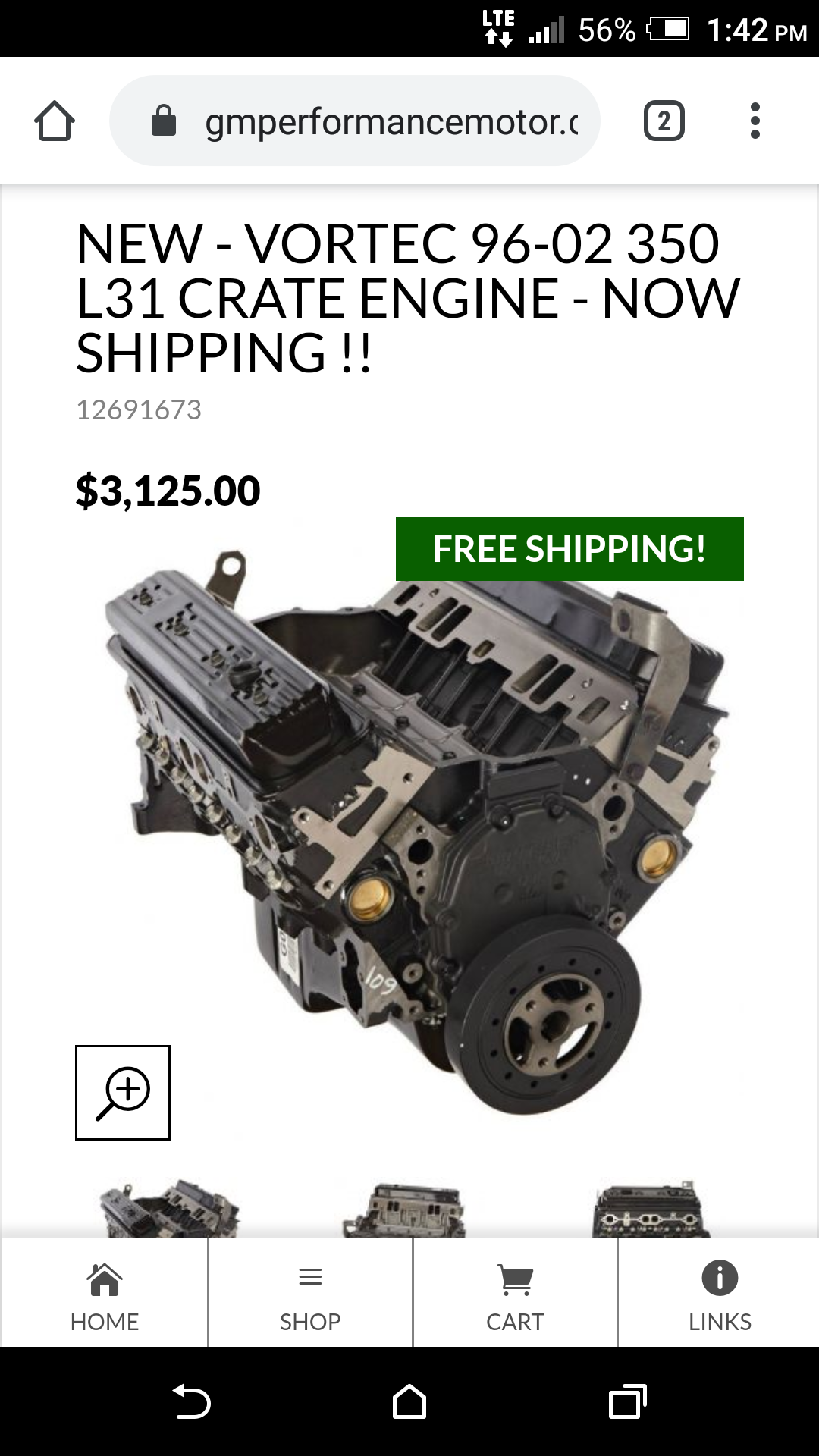

Originally Posted by TransamGTA350
Agree with the L31 Vortec 350. You can get a brand new GM long block for $2K. Add the vortec base and you’re good to go.
new GM vortecs have been discontinued. I haven't seen any replacement crate from GM for it.
Old Sep 1, 2020 | 10:27 AM
skinny z's Avatar
Joined: Dec 2005
Posts: 9,916
Likes: 883
From: 53.0907° N, 113.4695° W
Re: Engine ideas.
That might be but I did come across this:Subject: NEW - VORTEC 96-02 350 L31 CRATE ENGINE
https://www.gmperformancemotor.com/parts/12691673.html
Old Sep 1, 2020 | 10:36 AM
TransamGTA350's Avatar
Joined: Apr 2000
Posts: 1,533
Likes: 322
From: South Windsor, CT
Car: '89 GTA
Engine: ZZ6TPI
Re: Engine ideas.
Wow, the price doubled since last year. That’s for new GM anyway.
There are a bunch of remanufactured L31 motors out there for around $2K as well. That’s still a reasonable option as long as it’s a reputable reman company.
Old Sep 1, 2020 | 10:42 AM
I can't say I shopped around at all. Just did a quick search. There are probably deals to be had out there.
And for the record, while it says ready to ship doesn't mean it is ready to ship. Could be zero inventory as suggested.
GM changed up the part numbers and such. They still make them in this new form with a new part number. And yes the prices have gone up quite a bit. Jegs says ready to ship same day:
https://www.jegs.com/i/Chevrolet-Per...91673/10002/-1
GD

Originally Posted by fltche1
. Budget is flexible but not looking to blow the bank. (Best bang for the buck is how I roll.)
How many bucks would the budget be?

Old Sep 1, 2020 | 02:49 PM
skinny z's Avatar
Joined: Dec 2005
Posts: 9,916
Likes: 883
Re: Engine ideas.
Besides the budget question asked earlier, how does used and then refreshed vs new stack up.
A new L31 from GM is $3200. Free shipping too.
Add to that the Vortec base. 300?
Now, a junkyard engine that needs the full Monte. Next oversize bore. Maybe just a polished crank (no machining). All the other machine shop incidentals. Plus parts. Maybe an oil pump. Timing chain. Distributor. And this is on the assumption the heads are OK. Or go for an L98 but the same scenario applies. Where are we at?
This is the route I took last November, although I paid $1,949 (plus tax) shipped; they have gone up in price significantly. And if you want to stay with TPI, the SD vortec intake manifold is $400. FWIW, everything else from my 305 bolted up to the new crate L31.
Old Sep 1, 2020 | 04:05 PM

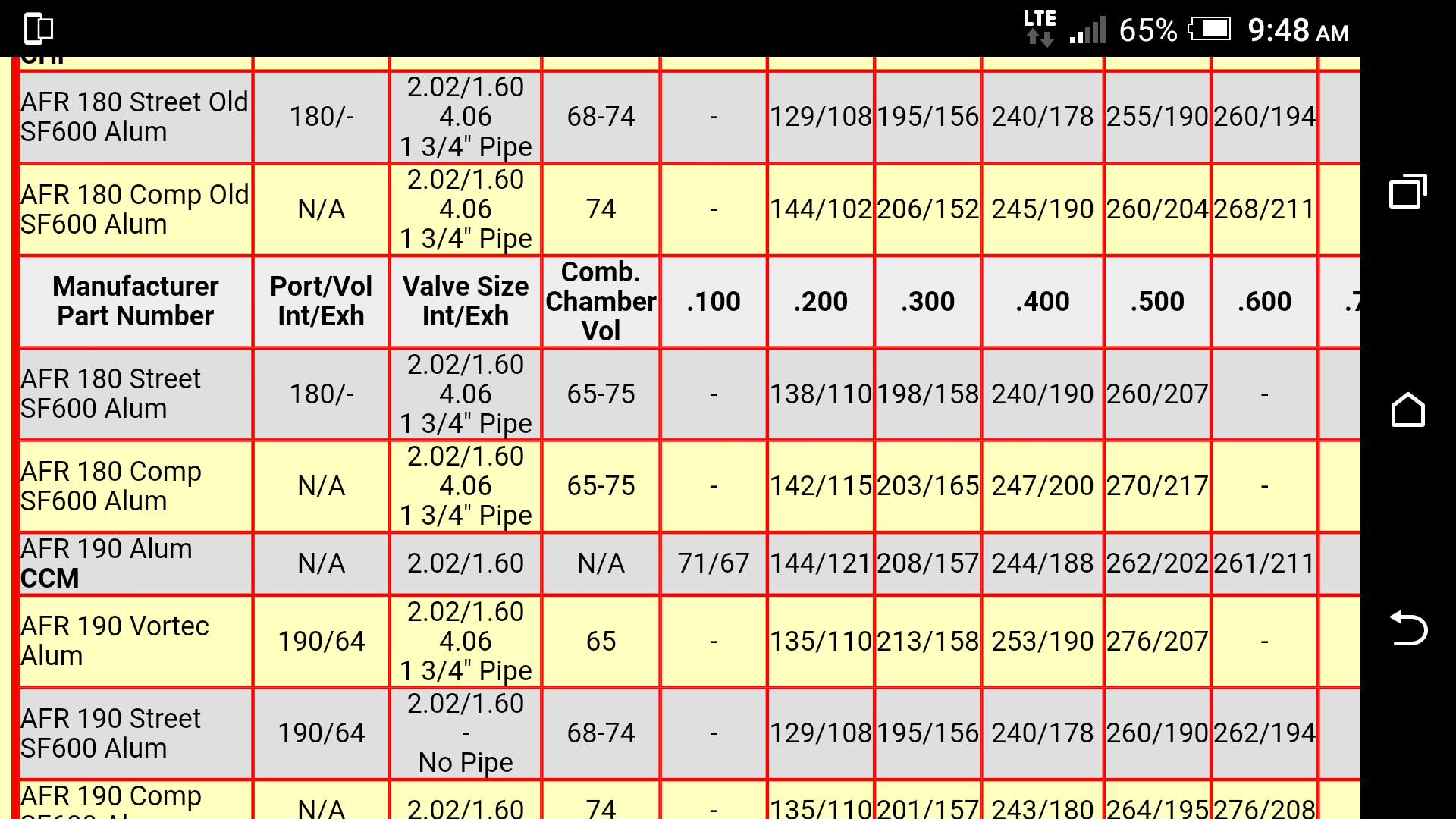

AFR 195cc from their website.
Street Head Flow Chart
.200.300.400.500.550
Int146 201 247 275 280
Exh119 166 197 213 218

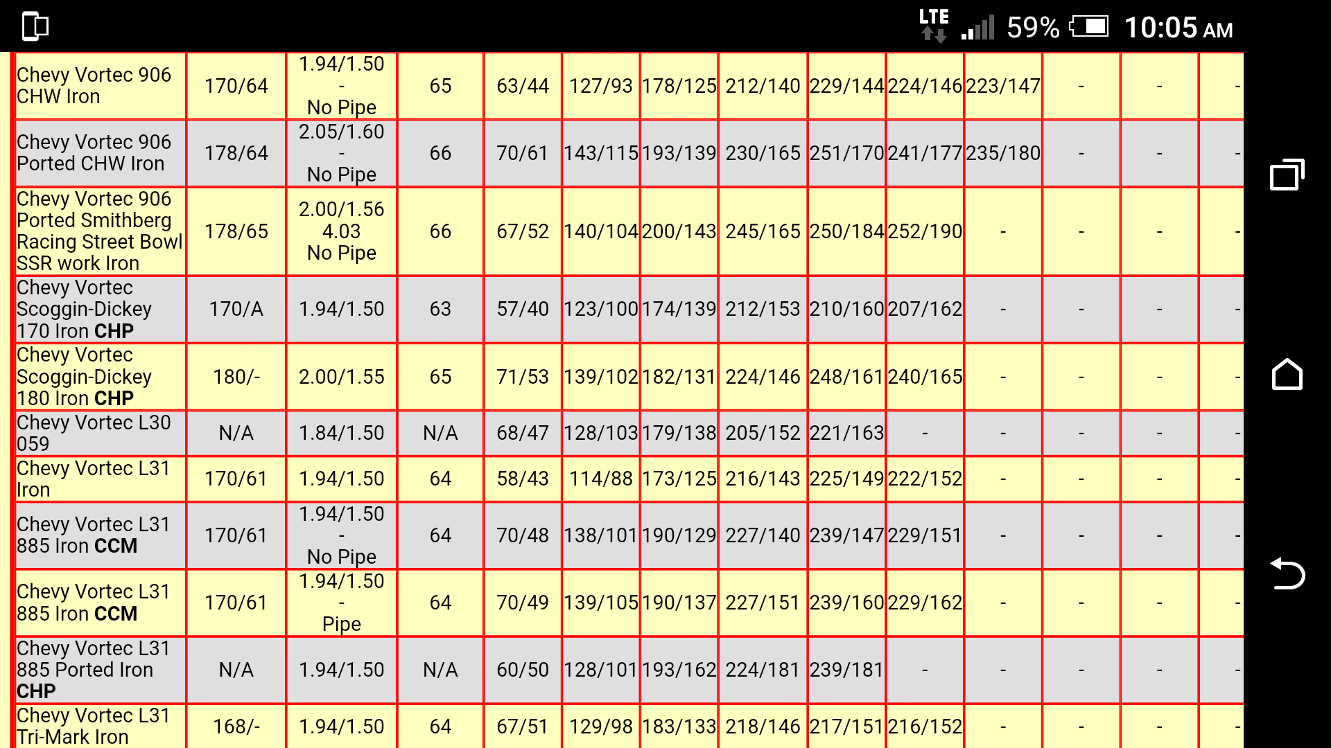

Lift (in.) Intake (CFM) Exhaust (CFM) Exhaust w/ pipe (CFM) 0.100 70 48 49 0.200 139 101 105 0.300 190 129 137 0.400 227 140 151 0.500 239 147 160 0.600 229 151 162.
(Will organize this better when I get home from work. Hard to do on my phone.)
From l31 coalition.
At .200 and up the AFR flows better.

Typical of AFR not to post their below .200" numbers.
As for the AFR 180s,
That list is from Stan Weiss' website. You may find some interesting reading there.
http://users.erols.com/srweiss/tablehdc.htm

Plenty of L31 data although you have to watch for the testing methods. Particularly the fixture bore size used. 4.03" vs 4.10", etc.

The FIRST manifold is primarily designed for the pre-87 bolt pattern heads (which is why I got the AFR 195's because if anything, it will fit better). But has the ability to bolt and seal to a Vortec. Any port misalignment (I'm sure there was some) was not noticeable either during assembly or on my dyno numbers using stock Vortec's. I think the variation is minor.
As for the low lift flow on the AFR's..... if it is in fact worse than a Vortec it doesn't seem to show up in any of the dyno charts comparing the two that I have seen. They seem to act almost identically till you get up higher in the RPM where you need that extra flow and then the AFR's just keep climbing while the iron Vortec falls off.
