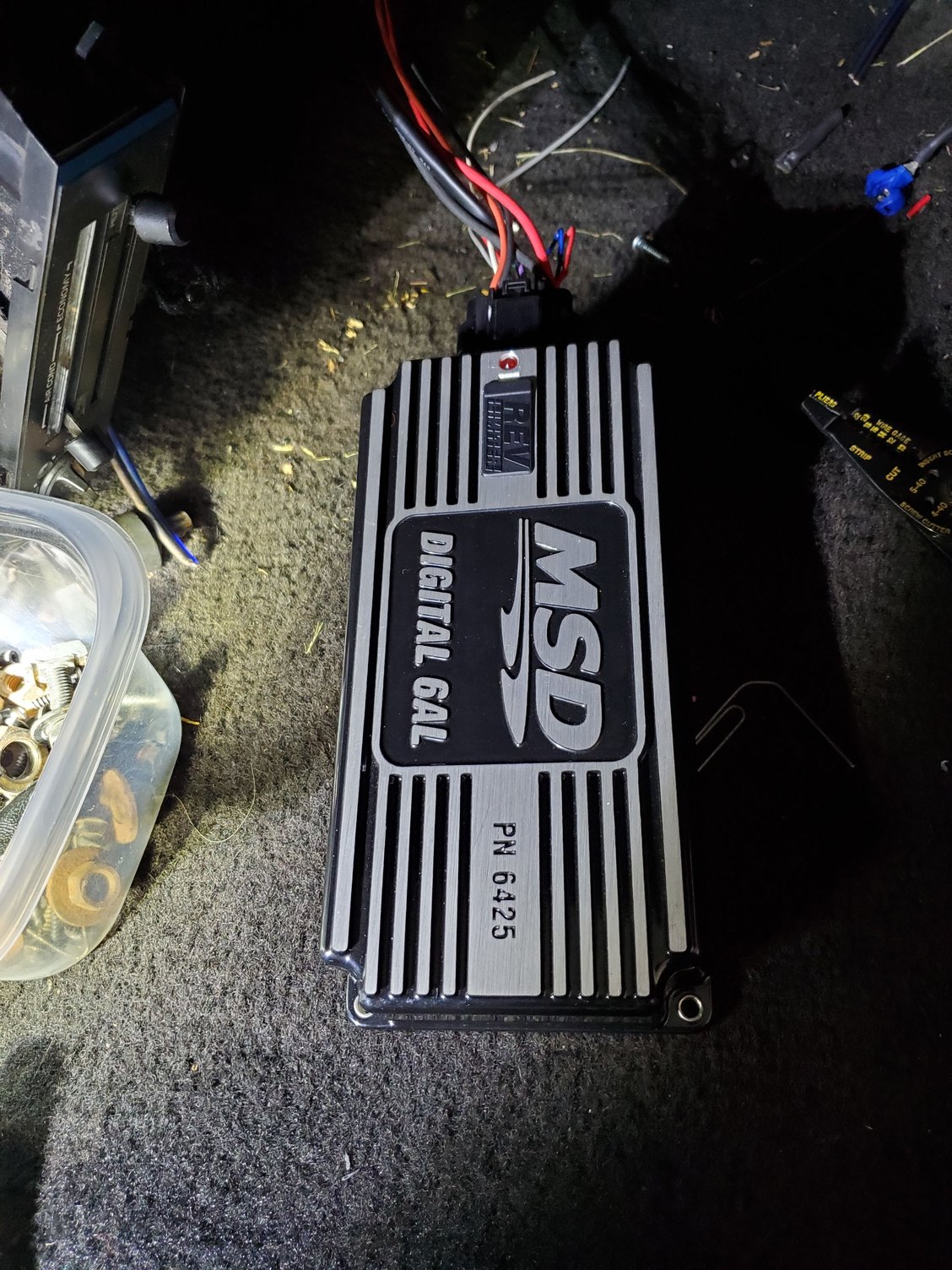

Huh, that’s a odd spot for a icm without a heat sink.

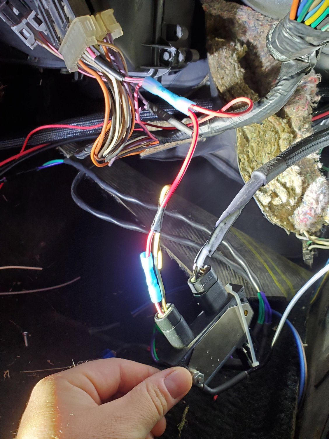

Check you positive and negative connections battery, starter and block. The injectors get power from the fusebox. Through c207 the connector in your picture and out the passenger side kick panel to injectors.
looks like the injectors power has been spliced into.

The injectors are getting powered thru that spliced ICM. It was the only way my mechanic could find online when installing an MSD unit on this engine, so thats how we did it. Ive tried 2 diff batteries, they both do the same thing. One is an Optima Red top that i bought new last fall, and i had zero issues with, and had it tested at advanced when this all started, and they sold me a Diehard battery that doesnt even have an hr worth of run time on it and stays fully charged and it does the same thing too. My friend that fixed the wire connections, used his voltage tester on all the connections and everything was good.
So the fuse box wire goes to the connector, then out to the injector? I have no idea how to even begin to check this stuff. This all may seem obvious or easy to alot of you guys on here, but literally I'm learning as I go.
Just doesn't make any sense to me how it was fine til i pull a transmission and touch nothing else besides a starter swap (which is easy and i've done many times b4 in my mechanical past)...Now it wont work lol

I would be cutting out that MSD box and have things wired properly.

I'd start buy pulling out everything MSD and putting the ign system back to stock. I've tossed so many msd coils it's not funny.

Yeah the MSD stuff is crap and entirely unnecessary. It won't make a single more HP over stock anyway.
You have a huge rats nest of a mess on your hands. Put the ignition system back to stock and perhaps you have a chance of troubleshooting it if that doesn't cure the problem on its own.
