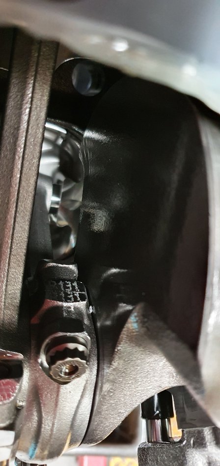

Bought an engine off a supposed reliable shop and i paid for a scat 4340 rotating assembly,
This is what i got,
any idea as scat dont have this number anywhere.

Does it have a part # engraved into the face of the front counterweight like the picture I posted in your other thread?

OK i will go to the shop and check but i just got an email from scat saying it is a cast crank.

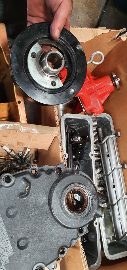

The rods and pistons are No name and the plastic front cover was rubbing on the balancer and melted the cover and the thrust washer had the and broken off .
the engine has poor cylinder pressure and the cam is a stepped nose job and no adjustment.
i also got no name lifters and a single row timing set thats non adjustable,, its got a comp cams 510 lift cam that comp cams runs on you tube in a 350 with simmilar parts than mine it made 403hp, that same cam in a 383 is less effective.
To change the cam most of the bits in the photo will be brushed aside as the plastic cover is melted, the stepped cam and lifters will go, the timing set is useless on a new solid cam and the front cover will need to be replaced.

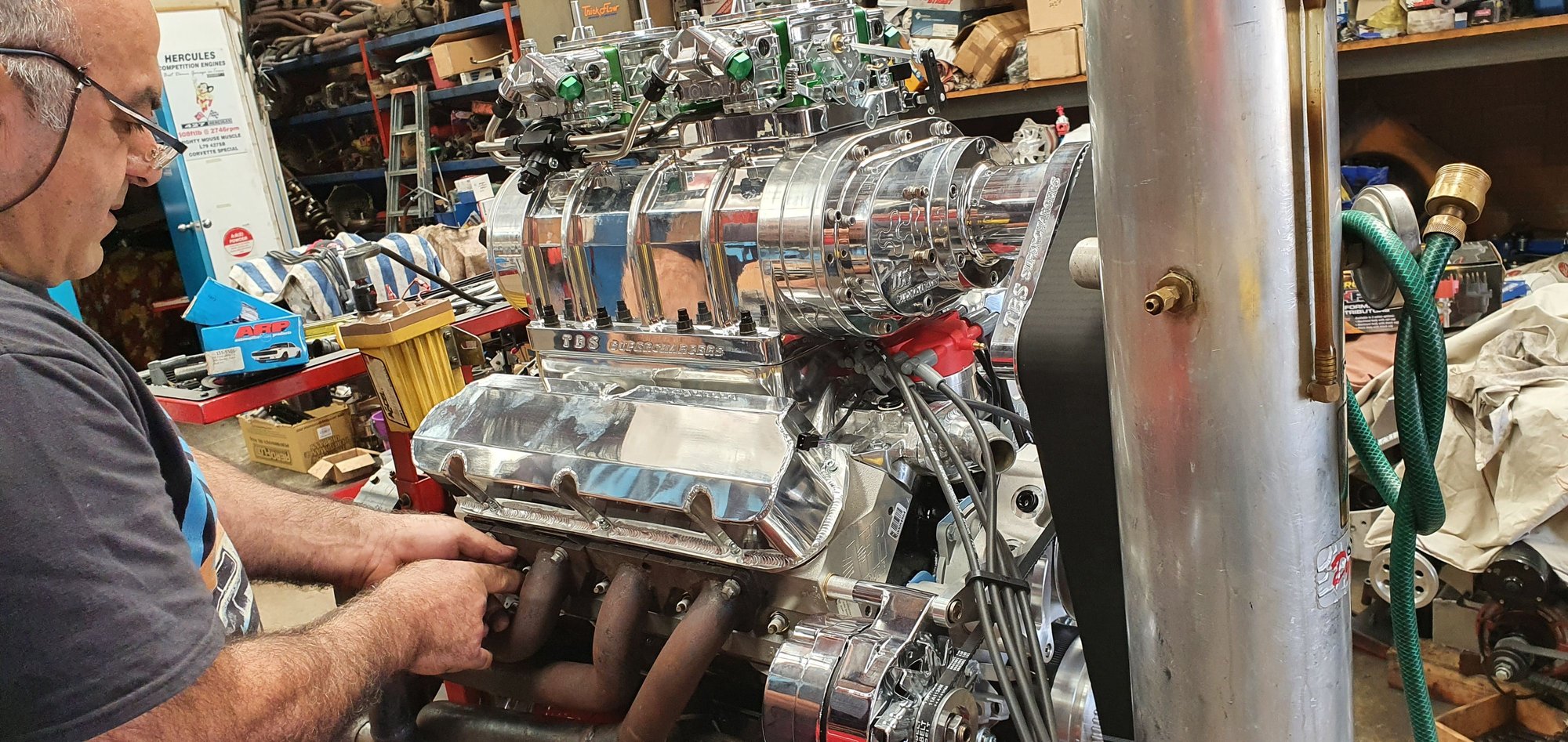

i bought from the shop in phoenix because engines in australia are about 25% more expensive and my friend in the photo with the blown 351 windsor doesnt really do 383,s much and i didnt want to get him involved.

The engine on the stand is not mine,, but the internals are visable and accountable and all listed in the build.
my friend with the blown 351 is building this for a customer.

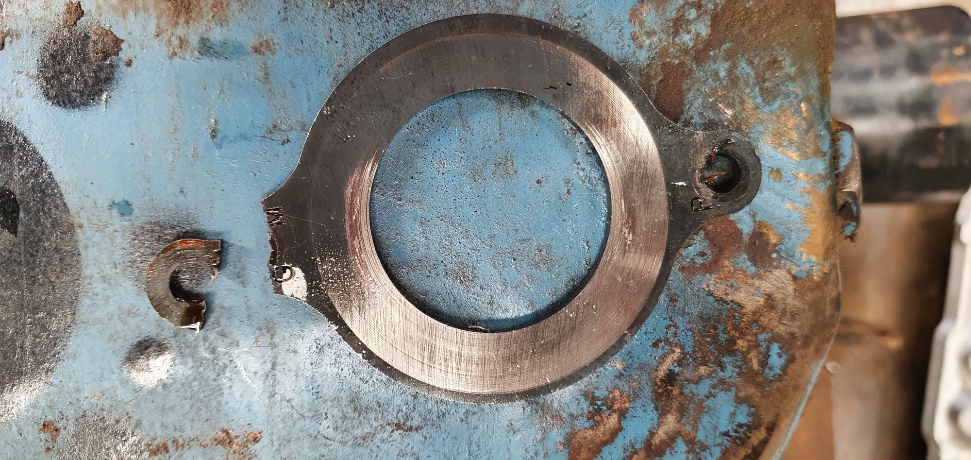

The broken thrust washer was in this new motor as in the photo.
