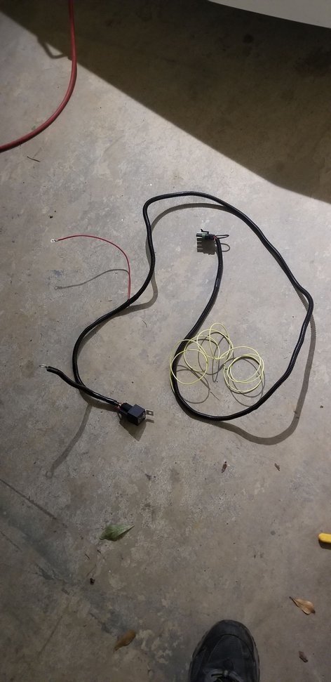

Almost complete harness
New 02 harness complete with terminals and wire loom.

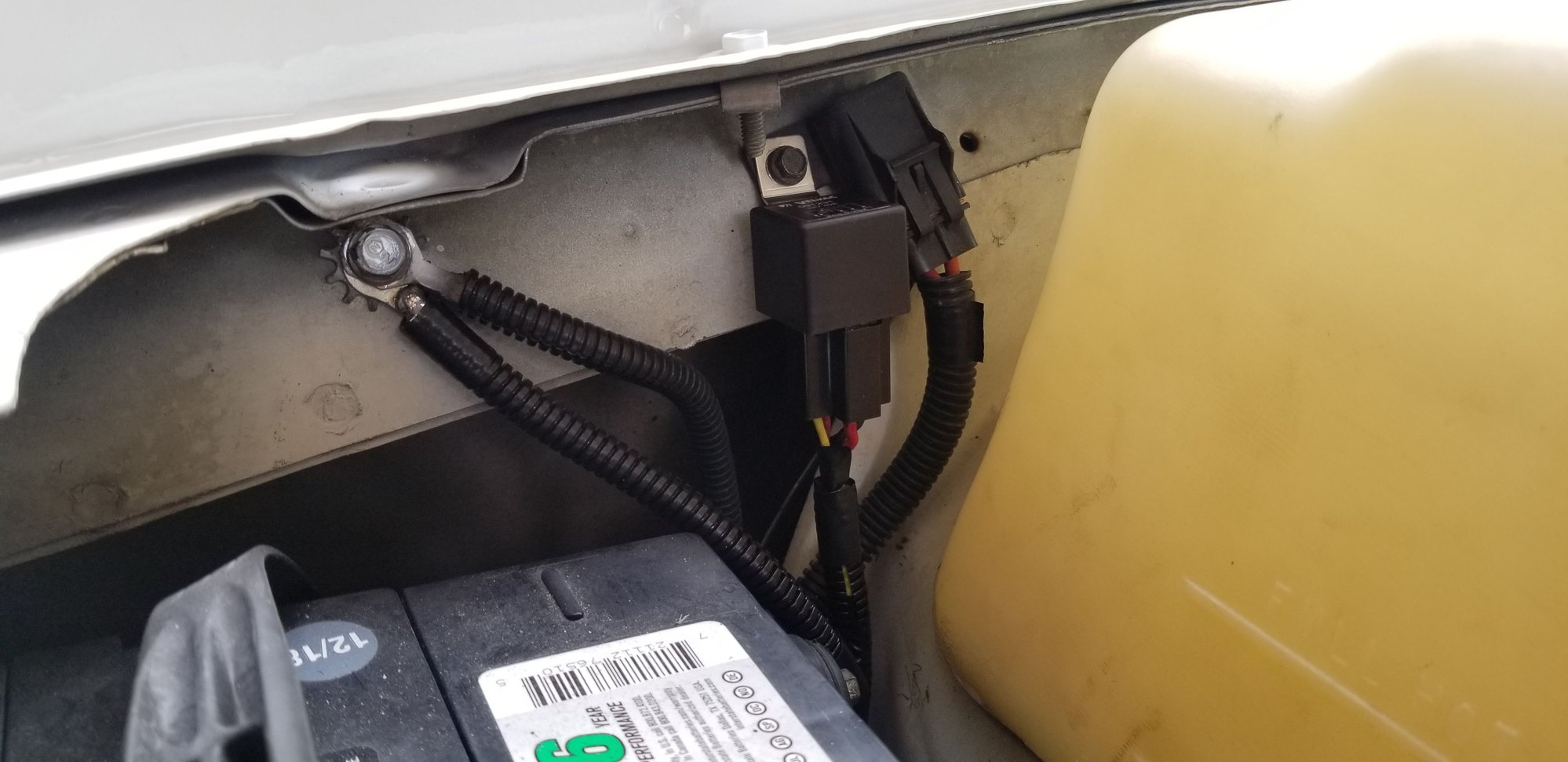

02 sensor for heater and signal ground are going to body ground on the left, 02 sensor relay in the middle, that fuse is factory i believe for the fan.

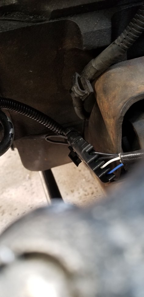

O2 sensor installed in factory location
O2 sensor side of pigtail.

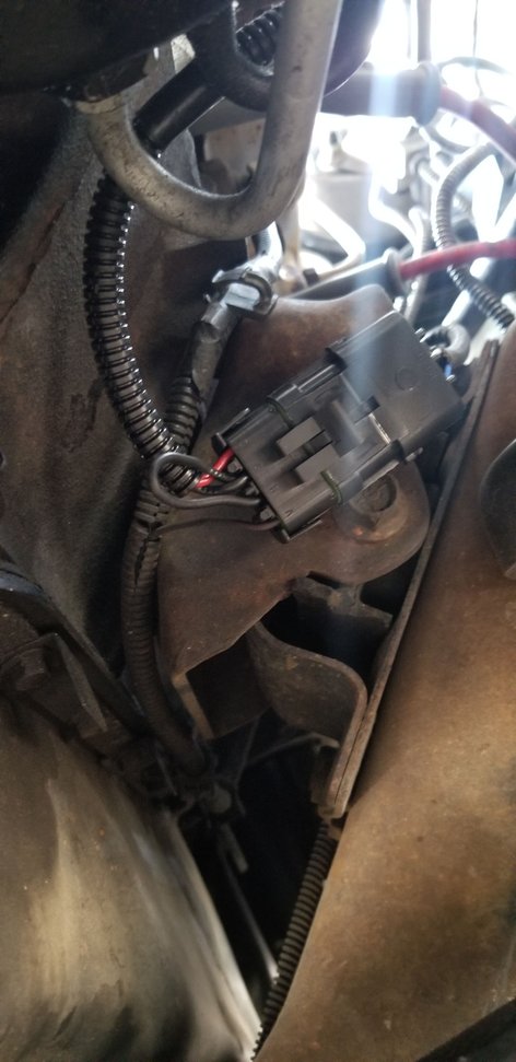

Car side of harness, with factory 02 wire plugged in (brown wire).

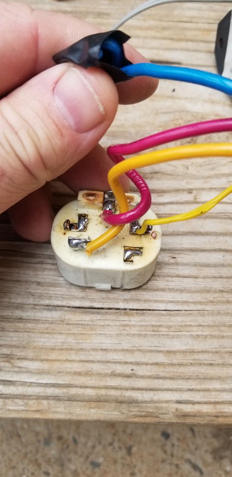

Fan relay, this is a dummy relay for my Hayden fan Controller, it allows the fan controller to be ran from the factory car harness. Small yellow wire is 12v ignition, which where i ran my 12v signal wire to for the o2 relay. Solder joints have been fixed better than imaged once 02 relay signal was installed.
