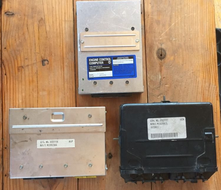

the mention of no maf could be a 1227727 or 1227730 a picture of the ecm would help.

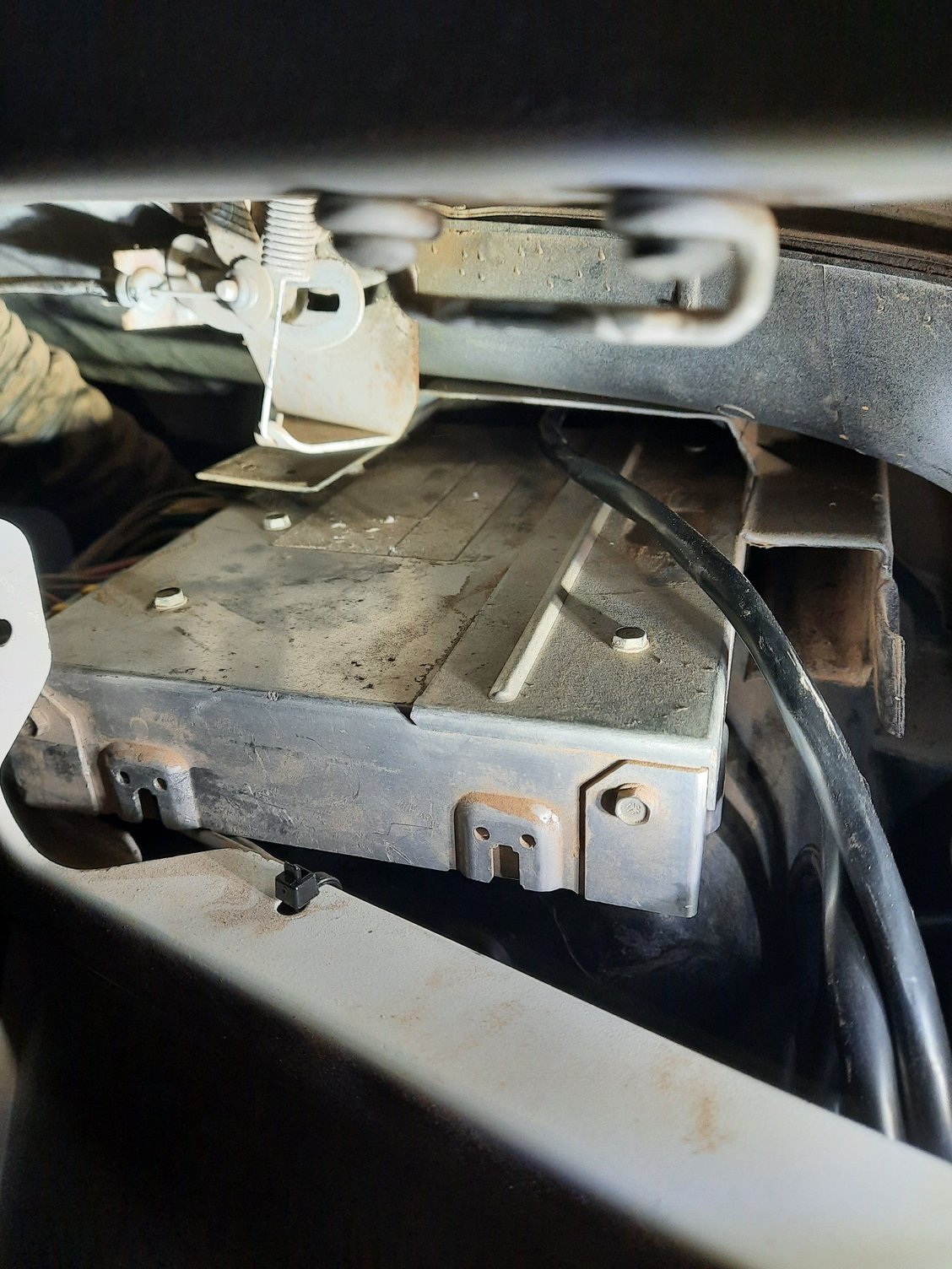

Old Feb 22, 2021 | 11:38 AM
JeepingDrake's Avatar
Joined: Feb 2021
Posts: 19
Re: Code 43, elusive Knock sensor

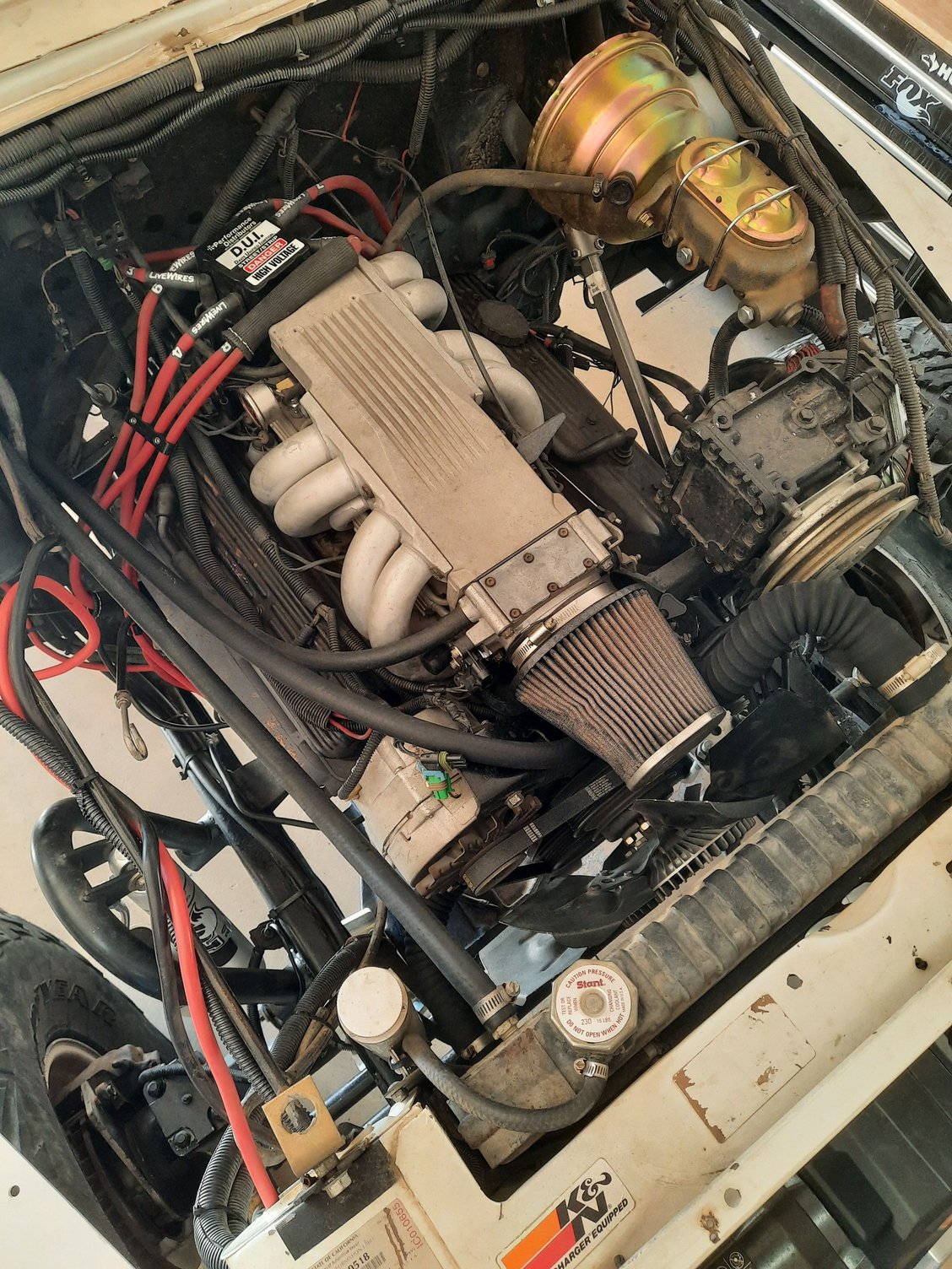

Old Feb 22, 2021 | 11:39 AM
Joined: Feb 2021
Posts: 19
Joined: Feb 2021
Posts: 19
best I could do without surgery

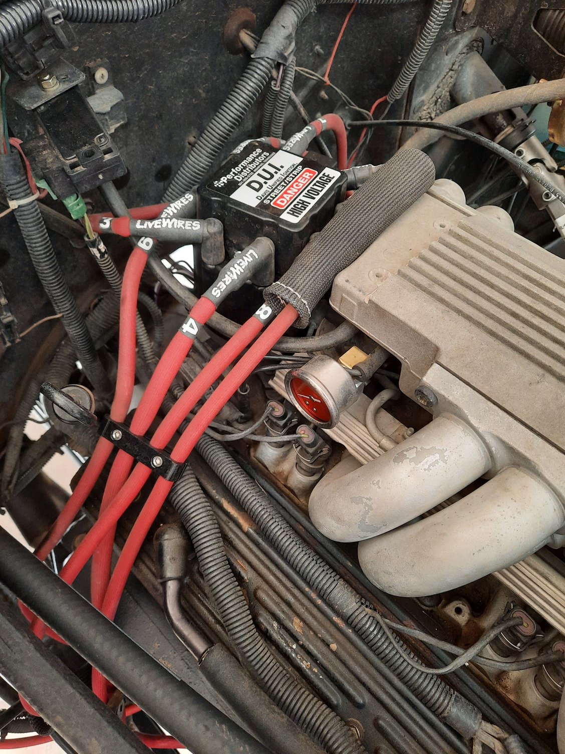

Old Feb 22, 2021 | 11:40 AM
Joined: Feb 2021
Posts: 19
looks like I have the bottom left
Old Feb 22, 2021 | 11:45 AM
Tuned Performance's Avatar
Community Influencer
iTrader: (94)
Posts: 16,754
Likes: 996
From: Mile High Country !!!
Car: 1967 Camaro, 91 z28
Engine: Lb9
Transmission: M20
That’s a 1227730 90-92 speed density ecm.

Yup. That harness and ECM is from a 90-92 F-body. You're intake might have come from an 87, but your electrical didn't.
As Tuned Performance suggests - you need to interface with the ECM and find out what it's doing for fueling and timing, etc. You can't effectively troubleshoot computerized fuel injection without considering the computer and finding out what it's doing.

Old Feb 22, 2021 | 12:27 PM
Joined: Feb 2021
Posts: 19
Old Feb 22, 2021 | 12:28 PM
Joined: Feb 2021
Posts: 19
Just a 10 ft. view

Most of the parts are the same actually. The knock sensor wouldn't cause your main issue. The 90-92 does have a MAP sensor and perhaps that has an issue but it's really hard to know till you understand what the computer is seeing.
I don't think it makes any difference what the engine is as far as year or what it came from. It's a small block with center bolt valve covers so it's an 87+ roller motor.
It is odd that the intake doesn't have the bracket for the MAP sensor.

Optical illusion or is the tps disconnected?
Old Feb 22, 2021 | 09:26 PM
Joined: Feb 2021
Posts: 19
It was disconnected in the pic, I was in the middle of a multi meter test
