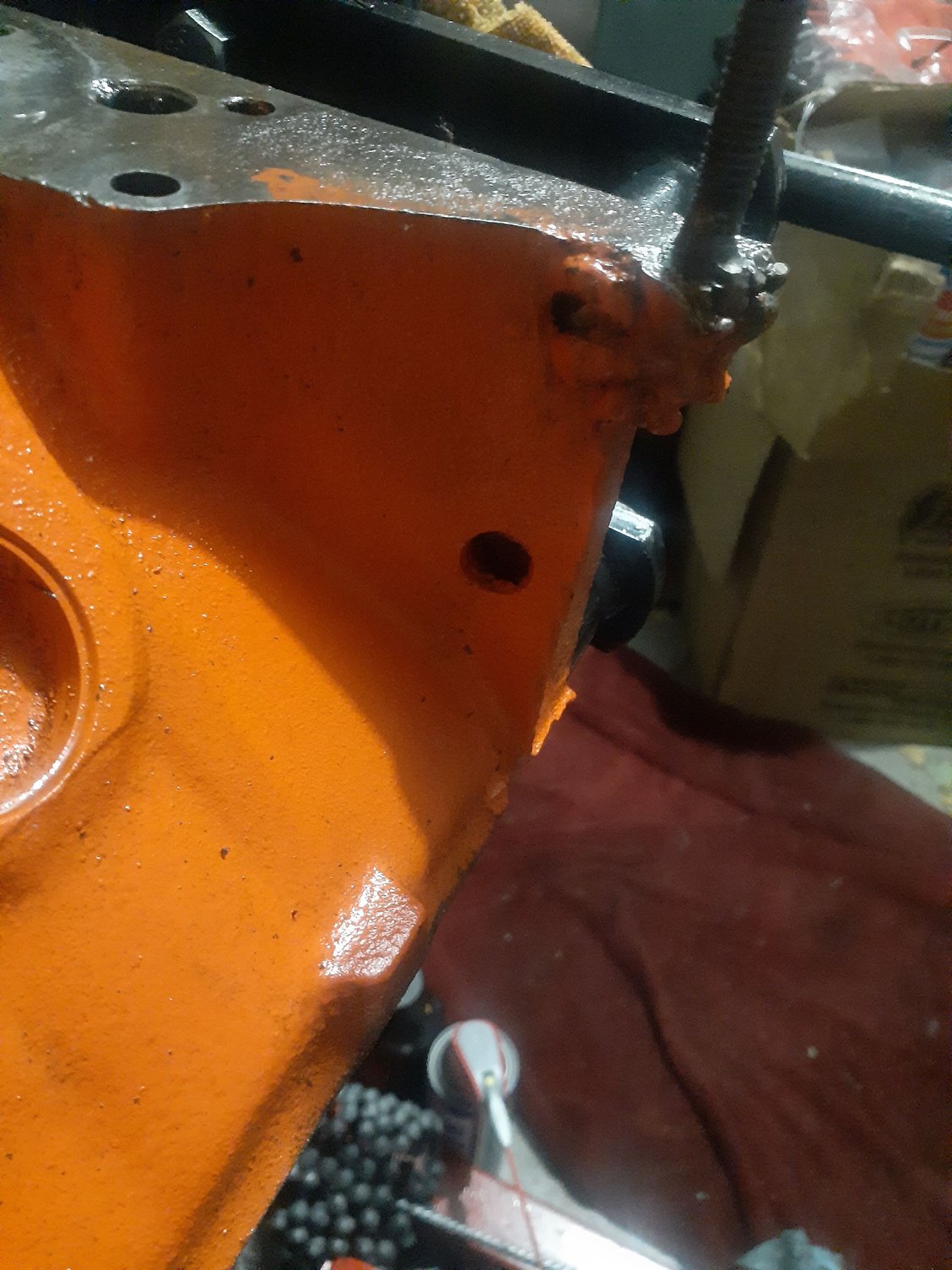

Post a pic of the mess at the starter and I'll see if I dare to guess how much of a future it has.

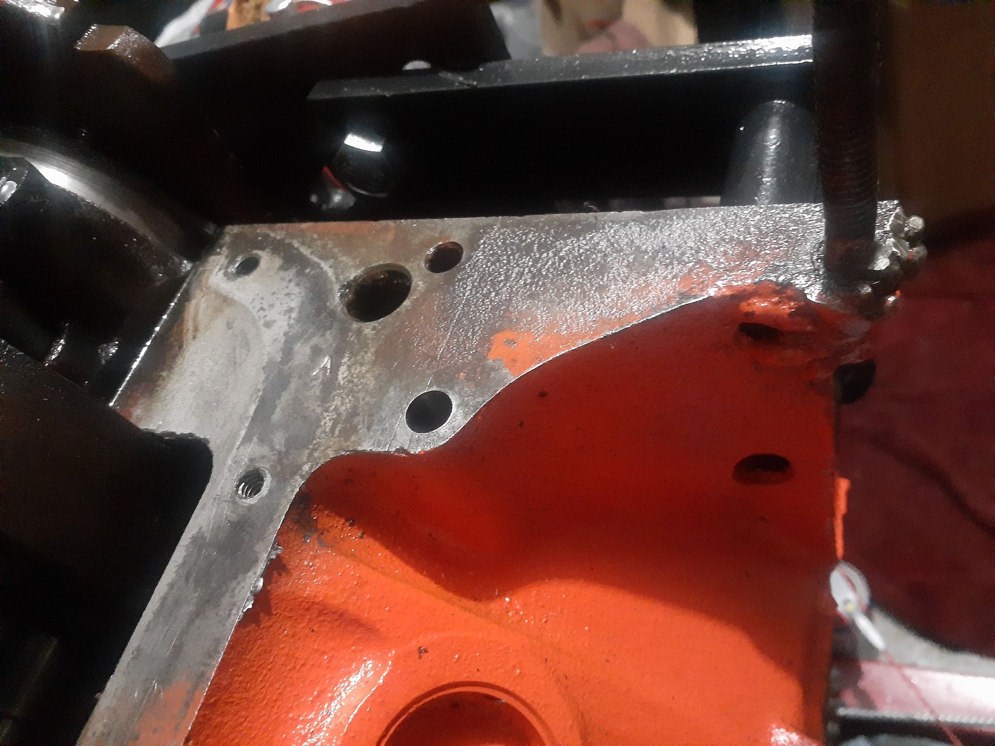

Alright heres the carnage lmao it's ugly. Why I asked if theres anyway I can just cut and grind away this stud and use the other two starter bolt holes? Supposedly the starter was fine like this in previous owners 60 something Camaro. they even had it mounted up but I don't how reliable this is lol. This was the same pic they sent me before I bought it. I just figured it wouldn't be the end of the world to fix something like this but you tell me. I've been reading up on it some other guys were saying to just cut the stud then grind it down, drill, and tap it.

This block is basically trash unless you can find a better way of "fixing" it. Proper starter bolts are NOT generic threaded rod.

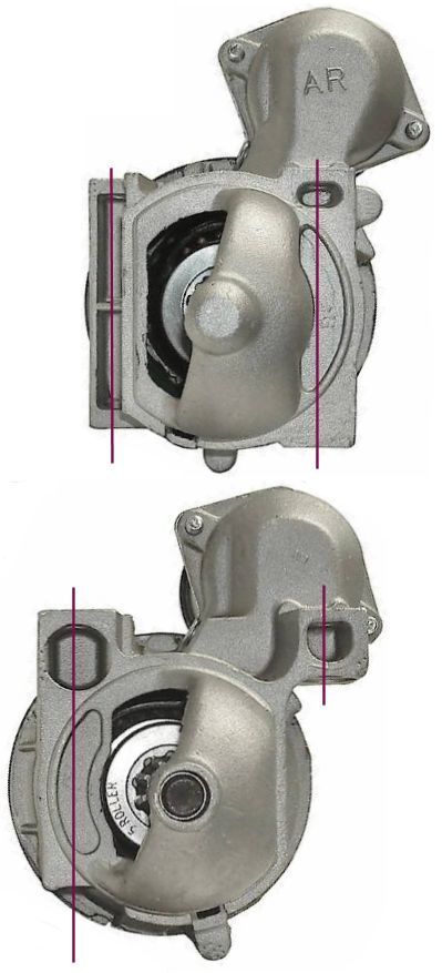

You mentioned just using the other 2 bolt holes. That's a problem because both configurations (straight and diagonal starter mtg) have that outer bolt in common --- both use the outer bolt.

That block is GARBAGE as far as I can see. That starter hack job is not likely to be satisfactory in any manner way shape form or fashion. In fact I'd bet that's why you got such an otherwise desirable block for such a good price: it's trashed, and wouldn't start dependably, and d00d got sick of it. Not sure if that can be properly repaired or not, but I'd recommend doing that FIRST before spending ANY money on any internal parts, lest you end up with a whole pile of REAL EXPENSIVE garbage that you can't actually drive.

I'd really like to try and find a way to fix the starter bolt problem. I'd hate to trash this project because of that alone.
I'll do some reading and see if theres anything I can do about it. You're both right I'd hate to put this thing together just for the starter mess to be the biggest PITA later on.

Problem is, there's no "extra hole" that can work for this. If it was one of the inner holes that was buggered, then yes, that might be available as a solution. But that one is critical and irreplaceable.
All the same, solve that problem FIRST, before spending A DIME on anything to go in it that can't be used for something else. Be ready and willing to scrap it if it can't be made whole again. There are few things worse than a motor that can't be reliably started; maybe cheeeeep headers, but I can't think of much else.
Blocks are indeed easy to drill & tap; but a block with a weld blibbet mess including a piece of threaded rod down in it, is gonna be pretty damn repair hostile. Imagine trying to drill out a piece of wood embedded in butter: that's about what you're facing. If Cletus and Billy Bob hadn't already got hold of it, that kind of damage isn't all that hard to repair. But that's REALLY botched.
This is one of those times when a post about "should I buy this" instead of "I just bought this" would have been wise.

Yeah it is botched hella bad not gonna act like it hasn't been on the back of my mind since I bought it but I guess I was naïve in thinking it wouldn't be the end of the block im so used to just finding ways to make something work so I saw it as not impossible.
Gotcha so leaving the crank and different heads aside for now I'll focus this weekend on the starter issue. I can tell this is gonna take some time to do it right I don't wanna make it worse than it is lol.
Gonna get it flat and then get the hole properly located and try to drill it. I'll check back in with you guys in a few days, appreciate the help.
So doing something similar to how you guys did it would I at first start with a slightly bigger bit and drill in a bit to accommodate the larger shank area snug and then use a sleeve that fits up in there and use a smaller bit through that to drill and tap for the threads further in? This is along the lines of what was explained only as you said I'm dealing with a weld mess and a big *** rod shoved up in it. lol

I know it sounds defeatist, but I'd suggest not attempting to repair that at home.
The surfaces of the block, both the starter pad and the BH flange, need to be absolutely flat and in the correct plane. The starter bolt hole needs to be in the exact right place. You get exactly one try on the bolt hole: if it's not right, it'll near impossible to repair again. You'd have to fill it with something, grind it flat again, and start over. Decking that surface flat is best left to someone with the right machinery for ... decking a block flat.
The way to drill a precise hole is, first mark it; then center punch it; then make a drill bushing for a very small bit like 1/16" or so out of something sturdy like a piece of bar stock, and clamping or bolting it to the block, such that it CANNOT move; then drilling. Then enlarge the hole in your bushing piece to maybe 1/8" or so, and repeat. Keep increasing the drill bit size until you're at the one for either a 3/8"-16 tap or for the Heli-Coil of that size. Then drill the entry portion of the hole. Then tap, and if it's your plan, install the Heli-Coil. Keeping in mind of course that the Heli-Coil uses a larger bit than the threads, and if it's too large, then the entry portion of the hole will be too large as well, which would be a serious flaw. I can't recall what the diameter of the starter bolt shank is but you can go to the parts store and just buy one and measure it. The Heli-Coil drill size for 3/8"-16 thread is 25/64" if memory serves.
Drilling is going to be a challenge no matter what. You've got a piece of threaded rod in there, which is MUCH harder than cast iron; as you drill, if the bit slips off of it, it's going to go off to the side and start making a new hole in the wrong place. That's the reason for drill bushings, is to unconditionally locate the bit in the right spot. You have the possibility that wherever the hole belongs, the crap that's there now is off to the side of where it needs to be; you might get it all the way drilled, and discover you've got a little "fingernail" of leftover material of some kind, that then falls out and leaves an oval instead of a circular hole. You might break that ear off of the block again. (if it's even the "ear", and not just a blob of some kind of metallic spooge) There's ALOT of ways it can go wrong. Best to leave it to a pro.
The BH bolt right next to it there needs to be made right as well, although that's not near as critical.

I've fixed a few broken/cracked starter bolt ears, but have always had the broken piece. I TIG weld it back together using stainless, (high nickel), rod.

Not sure whether the original ear is under that blibbet up there. Might be but I can't tell for sure.

It's partially there but it's still was busted pretty bad from the looks of it.

I am one of those guys that fixes anything. And I wouldn't waste my time with this block.

The old cast-iron nosepiece has 3 holes, but they are not those same 3 that are in that block.
See the photo up in post #13. The 3560 nosepiece has the inboard in-line hole at the intersection of the 2 cyan lines, appropriate to a 14" flywheel. Here's a fairly good photo of one. https://myautovaluestore.com/genco/p...arter-gnc-3560
The 3rd hole in that block is an incompletely finished backyard-added late-model hole, missing the critical feature that makes it a starter bolt hole, in the place where the hole in the magenta circle in my photo is, for the 77-up 12.8" wheel. AFAIK no nosepiece exists that uses both that hole AND the one that's not in-line, because those 2 holes are for 2 different size flywheels.
As far as I can tell, the offset hole in that block is OK. Can't really see down into it though.
That "repair" looks worse from this new angle than it did from the others. It's completely unusable as it is. There's not enough material built up around the little chip that's all that's left of what broke off, to properly drill. That needs professional help. IMO that's the best solution to the whole situation. The cast iron Powerglide adapter is a considerably inferior solution and probably will end up costing just as much in the long run, if not more, and will cause other constraints (like requiring a 14" wheel) that may be unacceptable. Unfortunately that turns a "good" price for that block, into an above market price. I.e., the seller washed his hands of a problem, and the buyer (emeraldsun) gets screwed. A tough introduction to motor building for sure.

Before i spent any money or time on that block, i think it would be wise to have it checked over at a machine shop to see if its a usable core. Then get an estimate to have the block machined, cleaned, repaired, etc. The block is the foundation of your build.

Might be wise to consider, that the 3rd hole that the block's PO added, might or might not be in the right place. That one should be checked, and might have to be redone as well, if a 12.8" wheel is in this motor's future; which minor details like header fitment might require. The 50s starter will be farther out and lower than a correct 12.8" one (part # 6316 for example). That's easier though: it can be drilled larger, filled with a steel pipe plug, ground flat, and re-drilled, with little or no added risk. Just expense.

Here's a view of the 2 starters. Sorry, didn't quite get em perfectly lined up.
Top is the old style for 14" flywheel (part # 3510 for SBC & BBC w/ PG, Turbo 350 & 400, 4-speeds, etc. - I could get a better pic of the aluminum version, but the cast-iron 3560 has all the same bolt spacings).
Bottom is 6316 (for 83 T-5, 12.8")
The right-hand bolt in each is the outer one. Think of that as the "fixed" point of reference for comparing the pics; the hole that emeraldsun's block is fornicated. Note how the inner bolt, to the left, is much farther over to the left, on the 6316. Different spacing. Has to be. That's because the motor shaft and the drive are about .600" over to the left, to mate to the 1.2" smaller wheel.
It's not obvious from the photo, but the 6316 also has a smaller body than the 3510 or 3560 as well. Overall it's near an inch tighter to the side of the block (header fitment, anyone?) than the 35xx.
In fact on emeraldsun's last 2 photos you can see a witness mark where the old starters were; they left a straight line mark where the nosepiece met the block; the other in-line hole for the 3560 is at the same relation to that line mark as the offset hole. That other in-line hole in his block is at or near the location for the 12.8" starter requirement. Looks too close to the BH flange to my eye but I don't claim that my eyeball is that well calibrated.
It's also EXTREMELY obvious from that 6316 photo why there's NO WAY to use the offset bolt hole with that starter, or any other starter with the shaft in that location: you can clearly see that the inboard bolt would then have to go RIGHT DIRECTLY THROUGH THE MIDDLE of the starter drive. I cannot begin to count how many times I've told people that, and had idiots try to tell me all about how you could use this or that "dual pattern" starter and it would work. NO. There is NO WAY that ANY starter can possibly mate to the 12.8" wheel and have a bolt in the early location, because it's not something that the starter determines. It's a result of the FLYWHEEL (which forces the location of the starter motor shaft & drive) and the BOLT HOLE. The ONLY way a starter will work with the 12.8" wheel, is if it has the late-model bolt hole. No matter how many patterns it will work with, if the block doesn't have THAT pattern, the starter cannot work.
Actually there is one way, but it's too complicated to explain. Somebody has actually made it though. But it's a $200 solution to a $2 problem, and thus suitable only for Vette owners who don't actually DO anything to their cars but instead just whup out the credit card to pay "shop" to indulge in their hobby for them.

Well I've been thinking about it the past two days and you guys have pretty much convinced me that I either take this block to the machine shop and have the works done as well as fix the bolt hole problems or just use it as an anchor.
I hadn't even considered that the the hole itself isn't positioned properly but now that it's brought up...considering how the stud was put in like that then it would makes sense. Ugh...this is a huge let buzz kill but I guess it's good I don't have a bunch of brand new useless speed parts sitting in boxes in the garage lmao. I'm so ticked. Thanks for your help guys.
One thing I'm confused on though is the starters you guys have shown and the ones I've been looking at don't appear to be the same? The 3 bolt bellhousing mount style doesn't have the three side bolt mounts shown on the ones you guys have posted. It uses the 3 bolts for the bellhousing mount plus a mounting tab. Would this one still not fit properly in place?

That's the old cast iron Powerglide (and older) starter.
Only works with 14" flywheel, and sits lower and farther outboard than the block mounted type. Much farther in all directions from the engine, than a 12.8" starter, maybe as much as a full inch. All bets are off as to exhaust compatibility in our chassis.
You still face the same kind of risk: a big pile of $$$$ parts you can't drive. I would not go that route until all other options are exhausted.
