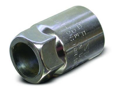

A short spark plug (SP) socket may work. I've cut down the length of a SP socket, then used a box or offset box wrench on the socket. They usually have a hex section on the end where the 3/8" drive goes.

Interesting, but as you can see from the photo, I can't go around the spark plug fully. The left side is blocked by that bolt.

Hes saying to cut a portion of a short spark plug socket away. If it starts to spread or break when trying to loosen just put a hose clamp around it to keep a tight grip on plug. Then you wont have to grind bolt down.
This is example pic

Ah. I had the same idea today when I saw those specialty sockets online so I went ahead and made my own. It fit the plug fine, but the plug is too close to that bolt and I couldn't do it because I can't turn it. If I turn it, it pops off a little. I'm already starting to strip the plug so I'm going to stop. I spent all day modifying the plug and a wrench I had. I'm just going to take the headers off. I was going to take some things off to give the engine a good cleaning anyway, so I might as well just do it! Thanks everyone for your ideas!
