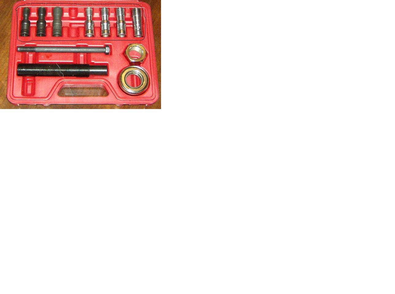

Re: Harmonic Tool stuck in crank.
First picture shows the adapter in the crank. The seconded picture shows the other adapters in the box, one is missing because it’s stuck in the crank.
If I use an easy-out is it possable to screw up the adapter with out getting it out? If that could happen knowing my luck it would. Could I leave the adapter in the crank and use a differnt bolt for the center bolt?
