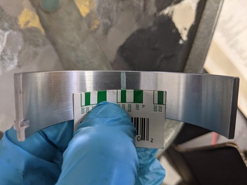

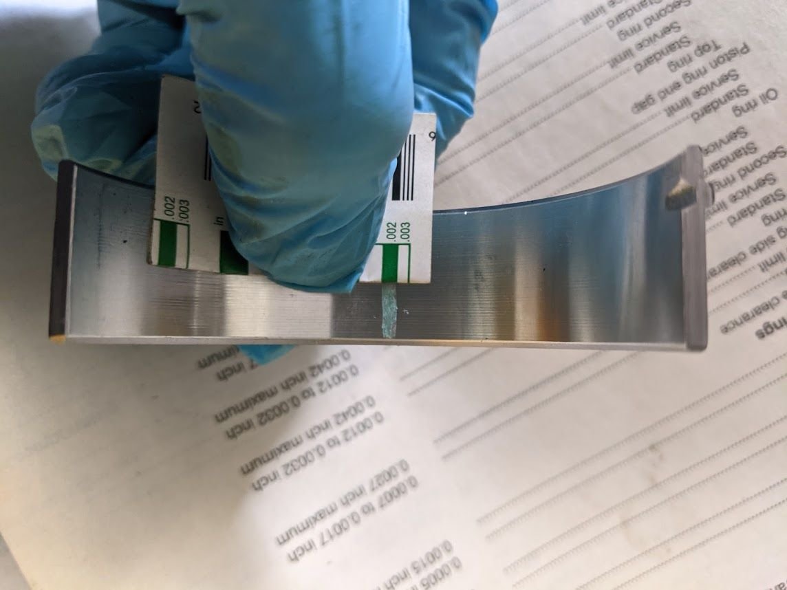

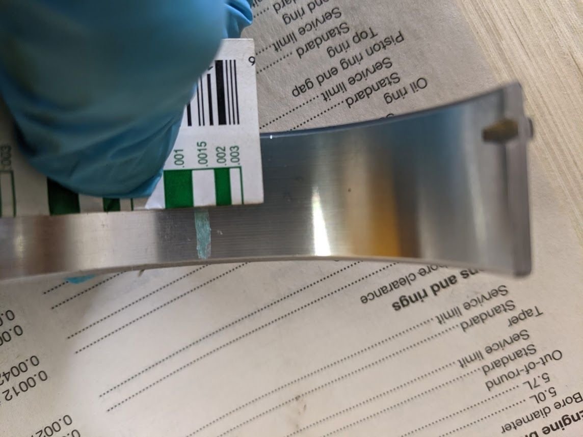

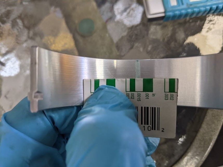

I want to clarify that I checked the crushed plastigage against the scale on the crank mains. I just used the shells for pictures as I had put the crank back in the box for storage....
This first image is checking the clearance with a STD bearing against the .0015 scale. It is narrower indicating greater than .0015 clearance.
This image shows checking clearance with the STD bearing against the .002 scale. It is slightly wider indicating not yet at .002 clearance.
This image shows checking clearance with the STDX bearing against the .0015 scale. As you can see it is almost identical to the STD bearing.
This image shows checking the STDX clearance against the .002 scale.

I also read that as .0018"
Its not. Invest in a micrometer. The money spent now is cheaper than a ruined motor. Plastigage is the cruel mistress of engine building. It may seem convincing, but it can lead you astray.
I agree. Plastigage IS NOT a substitute for proper and accurate measuring tools.
What I said was, from the picture he posted, that it reads .0018"
The fact that he got the same PG reading with STD and +.001" bearings shows that PG is not a measuring INSTRUMENT.
Misunderstood you. You are correct.
