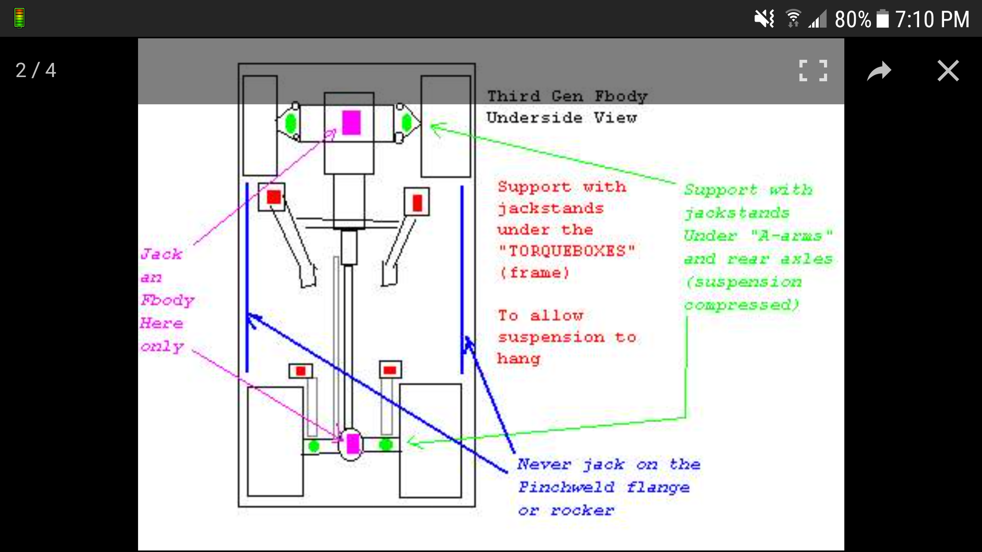

Ben, in all honesty, your messages here usually aren't all that easy to understand, hence my "English to English translator" comment in one of your other threads.
Now, as to your question, I know I may take some flak for this, as with everything else (What oil to use, Chevy VS Frod, Ginger VS Mary Ann) there are two fairly entrenched opinions regarding it;
I am firmly in the camp of NEVER jacking a car up from the "pumpkin"
I'm old enough to remember the big land yachts of the 60s and 70s, and I saw a few rear ends bent from someone doing exactly what you want to do. Yeah I know, our little 3 thousand pound cars are WAY less likely to get a bent rear axle VS a 5 or 6 thousand pound behemoth, but I've never saw the benefit of risking it outweigh the reward of the easy lift.

If you feel unsafe and/or the car is up in the air and feels wobbly then STOP!!! And get somebody in the garage with you that knows what they're doing.

Bottle jacks are the wrong tool. Bottle jacks have small bases and can tip over really easy. Stuff will slip around on the teeny little pad too, or tear a hole through whatever you're lifting on because contact stress will be so high.
Jack stands have wide bases for the purpose of stability. I use 6 ton jack stands. Bigger the better.
What I do is remove the shifter and slide the transmission under the car on a piece of cardboard. It slides easier and won't scratch it to heck. You'll have a lot more room once it's under the tunnel. Get it up on a jack and very very carefully raise it up into place. Two people with hands on the transmission is best. Auto trans it a lot easier since it can be balanced. Manual trans doesn't want to balance and you have to get it up in the tunnel before it's safe to take a quick rest.
Taking the bellhousing off the trans will make it a piece of cake sliding under car. You can mount the flywheel housing to engine, and then mount the trans to flywheel housing. That's what a lot of people do because it's so much easier to get to the bolts that way.

You can get a thirdgen plenty high enough. I've used the pumpkin to get it up in the air before, but only in so far as a stepping stone to get stands underneath either the axle on each corner, on the control arms if I needed to remove the axle. You can get the car pretty high from either end. Just make sure the car is supported correctly and you'll be fine. NEVER USE THE PUMPKIN as the final jack point. Intermediate is fine to get stands under other parts of the car, but NEVER by itself. Its far to easy for the car to slip off the pad.
