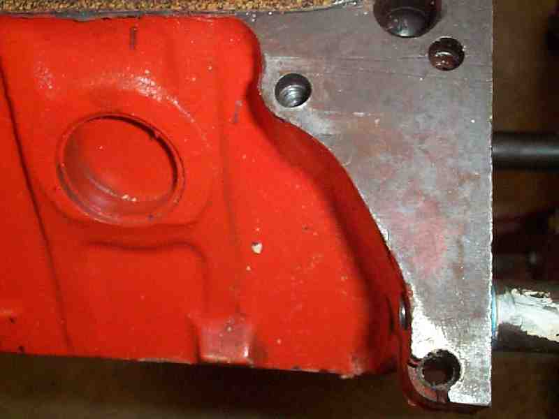

Some causes for a grinding starter can be,...cracked flexplate, wrong starter bolts, incorrect clearance/shim, or worse yet,...the dreaded cracked outer starter bolt hole in the block.

One nice feature of their 9000-series starters is the full-contact flat surface at the top of the mounting flange. That can help resolve issues when bolting a starter up to a block with "the problem" in the starter mounting pad area.
