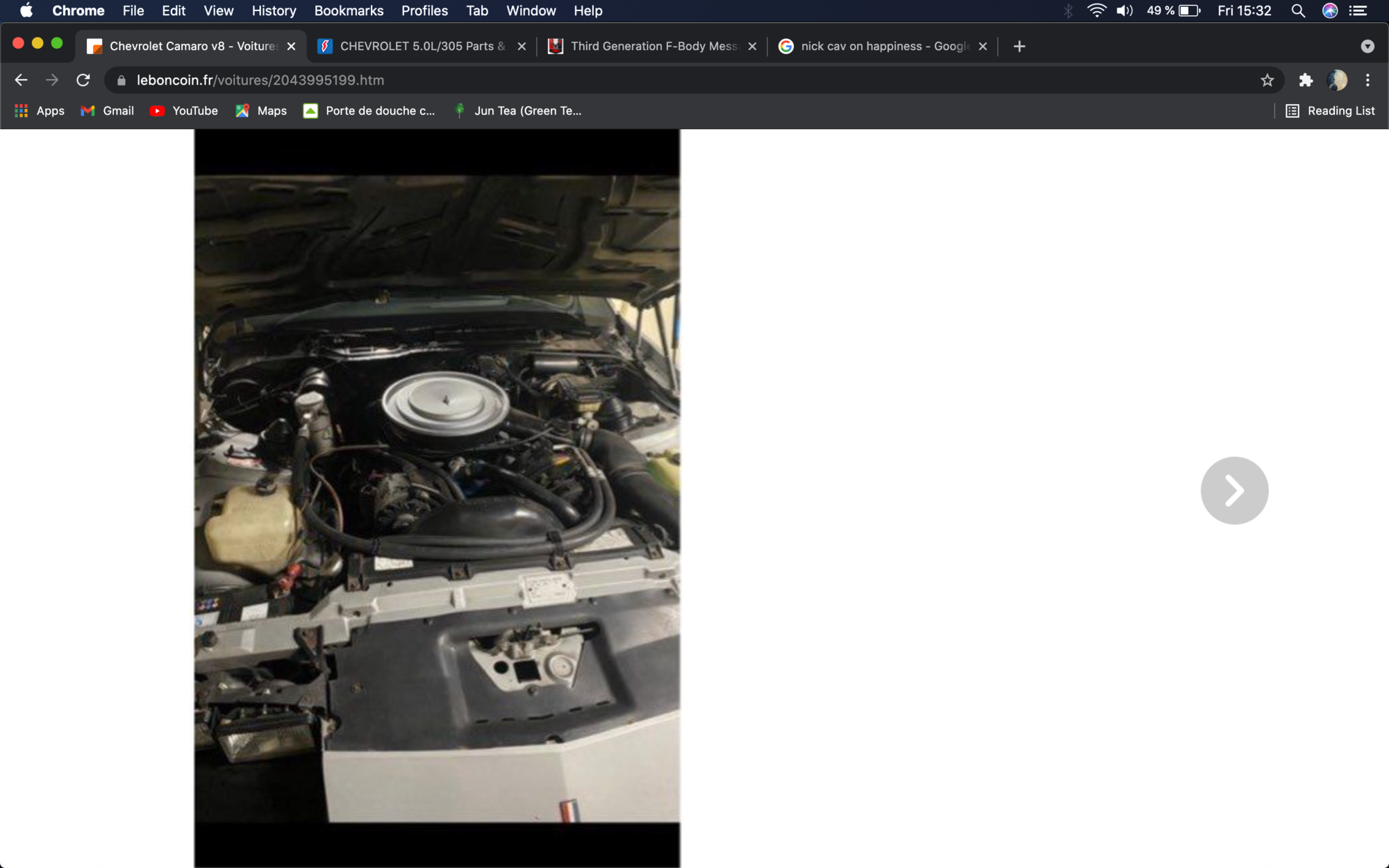

Engine bay. If I'm not mistaken there was a Euro V8 spec!?

congrats on buying that z28 If it is z28-E version,it came with non-CCC carb and no catalytic converter,but an engine oil cooler was added-rated for 165 HP instead of 145 US rating.LG4 is responsive to the usual SBC "hot rod"tricks and getting around 220-230 HP is very easy without having to do anything to the heads or pistons over 300hp can be had using the stock shortblock,but at that point might as well swap in a mild 350 or 383 for some tire-smoking moderate RPM performance. I think screaming high RPM is wrong characteristic for these cars Speaking of WW1,US army's first tank was almost direct replica of the French FT17.
