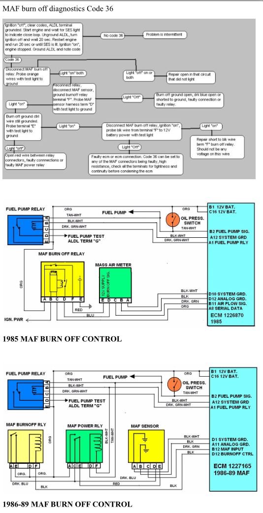

I have it on
it it possible to have on after the valves are adujted
I have a mass new 2 years ago that did have the burn off in it and Scott hansen deleted it
And now tuned performance chip and I told them but I don't think he did it
engine light is on full time

Like I mentioned have had issues with disabling code 36 in conjunction with vats.
not sure if it’s a tuner cat issue or what. Regardless you still need to datalog tune your car and the flag can be
unchecked at any time. You pleaded for a starter tune. That’s what you have if you need a refund for labor send me a message.
it's not vats

Based on $6e mask so yes
well maybe you thought it was
I told you repetedly over email it wasn't

it’s apyp based $6e, since you seem to know better I’ll send a refund for labor.
nothing but complaints , not sure why you mentioned you got hit with import tax
