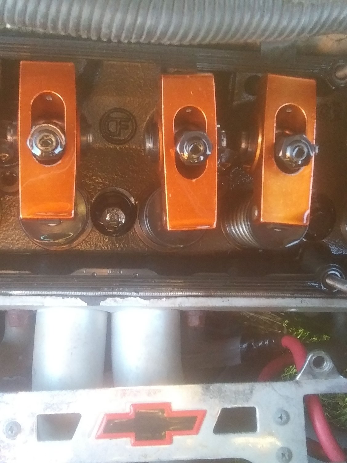

Cylinder heads?
88 iroc tpi 5.7... I know these aren't Factory heads because they are perimeter bolt set up, can anyone possibly tell me what they may be without having to pull the drive belt accessories...<br /><img src="https://cimg0.ibsrv.net/gimg/www.thirdgen.org-vbulletin/2000x1504/16331283315643838932929618101838_5df2fe2fd8b8fad7fd17033a69e93fc4b69807df.jpg"></img><br /><em>Lt (drv) side head</em><br /><img src="https://cimg4.ibsrv.net/gimg/www.thirdgen.org-vbulletin/2000x1504/16331283734687464557097771573507_3b9664ef7a344ce5133ee1a84a8f3da6a4df9d77.jpg"></img><br /><em>Perimemter bolt</em><br /><img src="https://cimg5.ibsrv.net/gimg/www.thirdgen.org-vbulletin/2000x1504/16331283959186219819041749724918_d959c9d2dbaee1fc608b7f96daa3900b6235b132.jpg"></img><br /><em>Rt(pass) side </em><br /><img src="https://cimg6.ibsrv.net/gimg/www.thirdgen.org-vbulletin/2000x1504/16331284353496520933391590722358_c497a9b4469576c15e912029c26c30ad54945bc1.jpg"></img><br /><em>Drv/Lt by acc. drive</em>

Take a valve cover off and look for identifying marks. Those pictures don't show much other than they're iron...or at least painted aluminum.

Yes, there should be casting numbers to see (depending on how much oil is currently under the Valve-Cover) if they are GM Cylinder-Heads.

Thx yall, will do this wkend... I was raised by the markings on front of the heads...didnt think about pullin v/c. Get back with more pics.

Gotchall some pics... Anyone know make of the rockers too? No branding. Summit's brand if i had to guess
C - circled
007
#1.... Cuz chevy is
R1

Guys, am I seeing a big problem here? There is no method of guiding the rocker arms.
1/2" drilled holes, no guideplates, non self-aligning rockers.
SCARLETT-IROC, you now know why a picture is worth 1000 words.

that's definitely a huge problem over what brand the heads are. Some of those rockers are half off the valve tip.
Considering the casting marks, they're typical looking aftermarket iron heads. The cf is maybe the foundry mark. World heads seem to have a S/R marks. If you can sneak a mirror behind the head you may see a product line branding.
But none of that matters now. INSPECT those valve tips and rockers. Make sure you don't have metal shaving in the oil pan. Don't run that thing any longer without something to align those rockers.

i do,n thanks for your eye, ive recently acquired this graciously (for most part) molested but "og" car and bottom end. Ive seen couple small issues but my need really is in identifying those heads, world would be my guess.

most definitely,its my project, not a driver... Yet... I do appreciate yalls input. Not going anywhere soon i assure yall. Ill try to to get a picture of the back of the head.

I agree with everyone so far...
-Not GM Heads.
-Harland-Sharp (the creator of Roller-Rocker Arms) Rocker Arms.
-Those Rocker Arms require Guide-Plates.
Can anyone see if the Rocker Studs are Pressed-In or Threaded-In???

thanks on the info... I did some research and the heads are from what i found, either dart eagles or worlds.. But still not definitive... But dart 007 does yield results with online searches...
oh yea the studs should be threaded, the studs have hex on them where meets the boss.

World Products heads do have a CF cast into them. https://www.enginelabs.com/features/...for-dirt-oval/
Identify World Chevrolet cylinder heads. According to World Products, the Sportsman model casting number is "I-037" and S/R model casting number is "I-052." Standard S/R heads have the casting mark "S/R' above the casting number, while S/R Torquer heads have "305" above the casting number. The Big-block Chevy Merlin head casting number is "I-043," followed by a "B," "C" or "D" indicating the port size. Merlin heads are also stamped "World Merlin" on the outside of the cylinder head, above the exhaust ports.
Determine the casting date of the World cylinder head. World uses two dating systems, the first is two numbers separated by an "X," with the numbers representing the last two digits of the casting year. 1988 is identified by "8X8." The other is used on S/R Chevrolet heads for Chevrolet engines, where "AV8," indicates January 1998. S/R heads were first cast in 1990.

If the above is all correct...
Installing Guide-Plates will be a piece of cake!

Bill Mitchell (World) and Dart probably share a casting facility for some of their products...

Dart Iron Eagle 165/72cc heads
https://www.competitionproducts.com/.../#.YVpBrJrMKUl

Roller Rockers appear to be Harland Sharp or imitation.....
https://www.summitracing.com/parts/csp-s1004-150

def where i started but was leaning on "dart side" since it has "DD in casting. But world is dart now after acquisition
