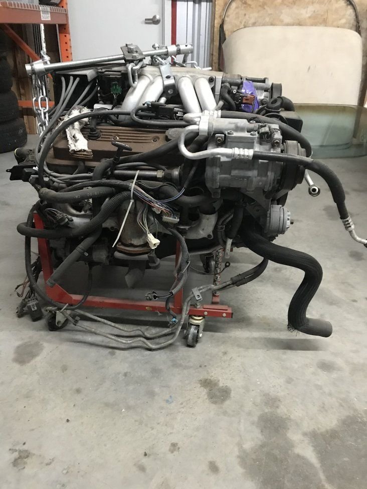

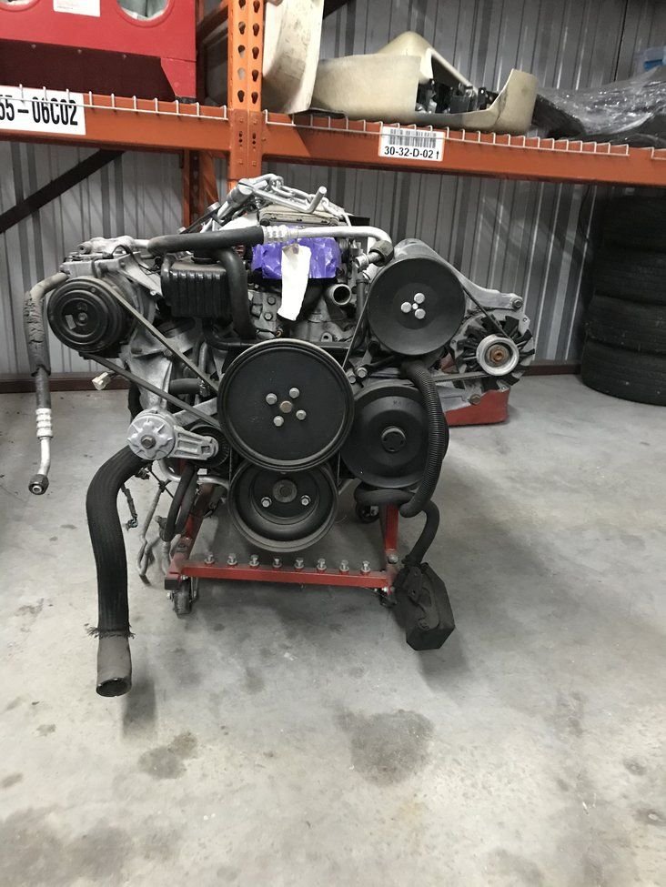

This is the L98 What's it worth? Supposedly 91,000 miles. I'd probably pull the heads, inspect it and reseal it, at the least.

I don't see any trans fluid cooler lines on it. Of course, absence of proof is not the same as proof of absence.
As far as what it's worth, I have no clue. Looks absolutely complete though, and in pretty decent shape. Not sure what the demand is for such things but the supply is rather constrained. Might be a couple of $k, as relatively uncommon as such a thing is becoming these days.
