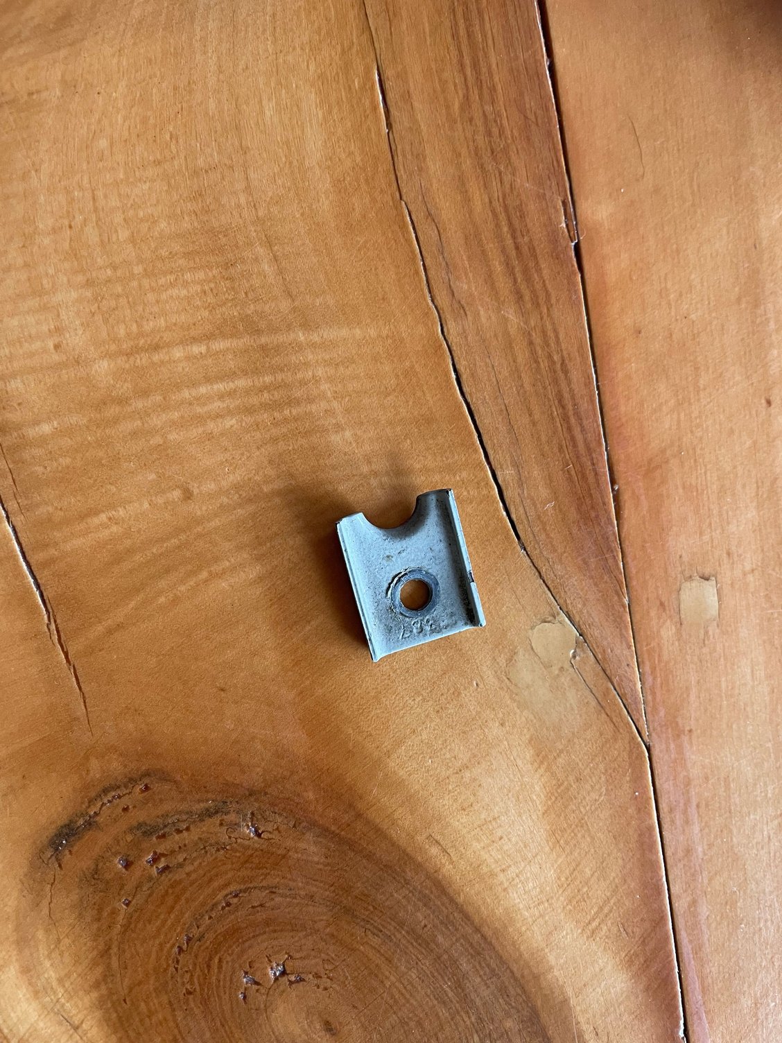

Hey everybody. Well here's an update my fuel leak was not coming from the fuel pressure regulator which was what i was hoping but it looks like it's coming from the fuel rail where the cross tube that go's in to the fuel pressure regulator housing so the O ring must be bad. So today i took apart the upper part of the motor and removed the fuel rail and found out one of the what i would call i guess a locking plate that holds down the cross tubes for the fuel rail was missing. So i was wondering dose any body know were i could get one from with out buying a whole other fuel rail just to get one small part off of it and dose anybody sale the down tube bolts that go in to the intake . Man they are a pain to get out.

Re: Fuel pressure regulator housing screws
https://www.ebay.com/itm/85-92-Camar...-127632-2357-0
standard motors sk24 from
amazon. I might have the missing one I can check to
pm me which one it is
I
only have this you can have shoot me your address. I don’t have any extra screws

Hey thats cool. I can find a screw. I'll PM you my address.

Hey everybody. Here's a small update thanks to Tuned Performance a great guy by the way .He hooked me up with the missing part i needed for the fuel rail that some clown left off when they worked on the car before i got it. So now I'm just waiting on the O rings for the fuel rail to come in and then i can clean and rebuild the fuel rail . O yeah and thanks again to Tuned Performance i got a new set of replacement screws for the fuel pressure regulator housing which came in the other day. Man I'm glad i found this form you guys have been a big help.
