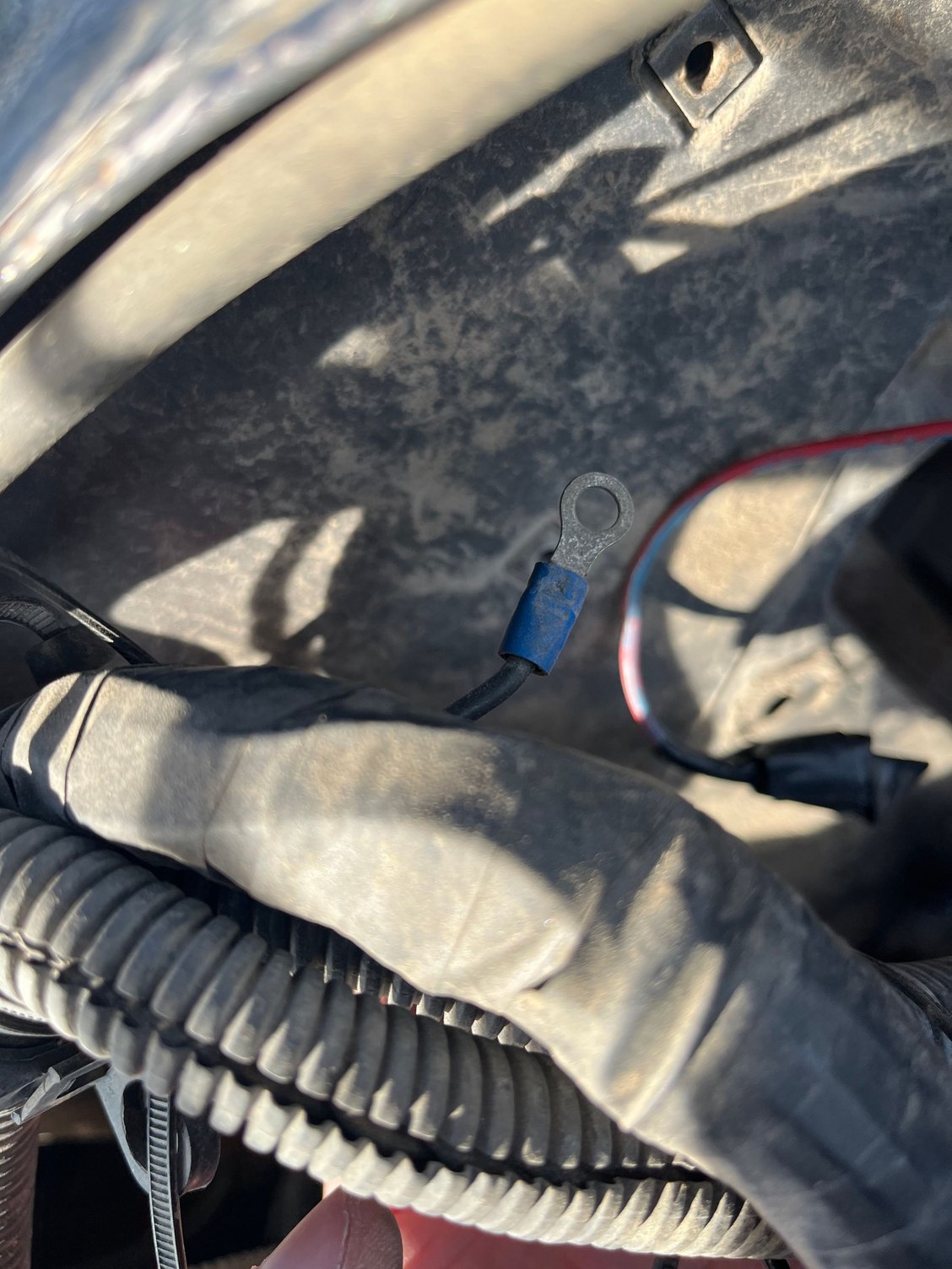

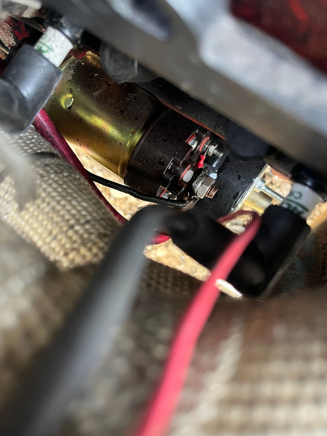

Okay, I got some pictures of my wiring ans its a bit of the mess.
one of the terminals or whatever it is called on my starter wasn’t hooked up and the other one had a pretty crappy looking wire.
i think one of the fusible links isnt hooked up (?)

Yup, all of that stuff is bad news. Splits, breaks, cracks and all un-heatshrinked connectors are not doing you any favors. Try to trace back that open connector and see what it's going to. The factory service manual has great wiring diagrams. There are also some available here:
http://www.austinthirdgen.org/?pid=19
If you've got extra slack, chop out all the burns and breaks and either solder or use a butt connector AND heatshrink to repair the damage. If that would make the wire too short, get replacement stranded wire in the right color and size. At this point I'd go over all the engine bay wiring and see what else needs doing, as once you're there with all the connectors and equipment, the chopping and splicing goes pretty quick. Disconnect the battery first, of course. If you don't have good crimping and cutting gear, Klein Tools makes some nice stuff, and there is a difference.
