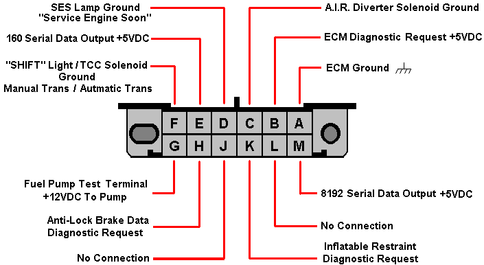

Just for verification, the ALDL terminals are arranged like this, as viewed from the face (open) side of the connector:

For some reason it worked today. It threw a code 21. High voltage from the TPS. I tested it and it was 4.75 volts with the throttle closed. Didn't change at all while moving the throttle. So I'm assuming the TPS is toast and would explain why its running like ****.
However, My fan is not working and according to the FSM it should be running when I jump A&B. ( And I remember the fan running in the past when I checked for codes) Where do I start when figuring out why my fan isn't working?
