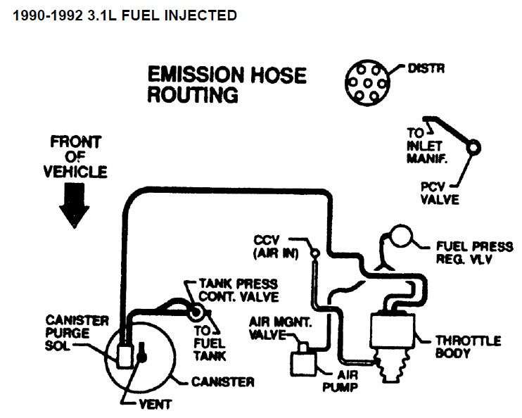

Hi Joiner, In reading your post two things struck me about your problem.
#1, Never, ever, is there supposed to be fuel on the vacuum side of the regulator. If there is, then it's leaking, even if it's a new one, and that has to be addressed before any real troubleshooting can begin.
#2, You talk of vacuum line weirdness, as if perhaps some previous owner messed with it. If each and every vacuum line is not as shown in this diagram, you must also correct that before attempting any further diagnosis.

I apologize, I never saw any notification that there was a reply to this thread. Update: replaced the idle air control valve, replaced the throttle position sensor, corrected vacuum lines. The vacuum line was sucking gas up through the vapor canister and that's why I had fuel in the lines to the FPR. This also caused lots of gas to be inside the vapor canister. Engine currently starts up and goes to 1500 rpms, slows down to 800 when warm and has a slight stumble. After heated fully the idle drops to about 700 and gets rough. When put in gear it will eventually die. Replaced the EGR valve. I replaced the O2 sensor today. We also pulled the distributor cap and found 5-6 degrees of slack on the timing chain. Double checked the new FPR by putting a vacuum on it. It held 17 in Hg for 20 minutes with no additional fuel coming from the vacuum line. We found small holes in the EGR tube from arcing the back of the alternator. Patched those today. No different. The idle of 3000 rpms earlier was from a loose throttle adjustment screw, replaced that. One of the vacuum lines that wasn't hooked up at all was the air pump, hooking this up stopped backfiring. Also attempted plugging the vacuum line to the brake booster and no change was found.
