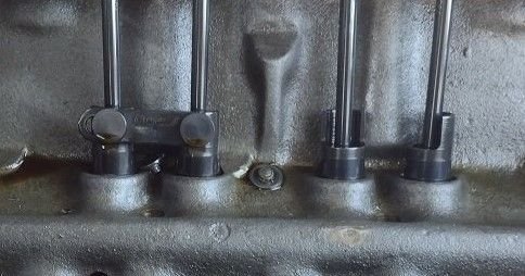

Originally Posted by Slow'86
How is the reliability of the link bar lifters? I've seen reviews on the Howard ones being pretty noisy.
Anything will fail if you lean on it hard enough. Below are what remains of my COMP tool steel short travel lifters. It's difficult to say exactly what happened but it appears a link-bar rivet let go. RPM and end of service life are probably the causes.
But by and large, we've had tens of thousands of trouble free miles racing and cruising using the retro-fit lifters.
As for noise, the lobe profile is the biggest contributor. I ran the same set of lifters with an off the shelf COMP XR276HR and also with a custom grind using COMP's XFI lobes. The XFI cam was noticeably noisier.
