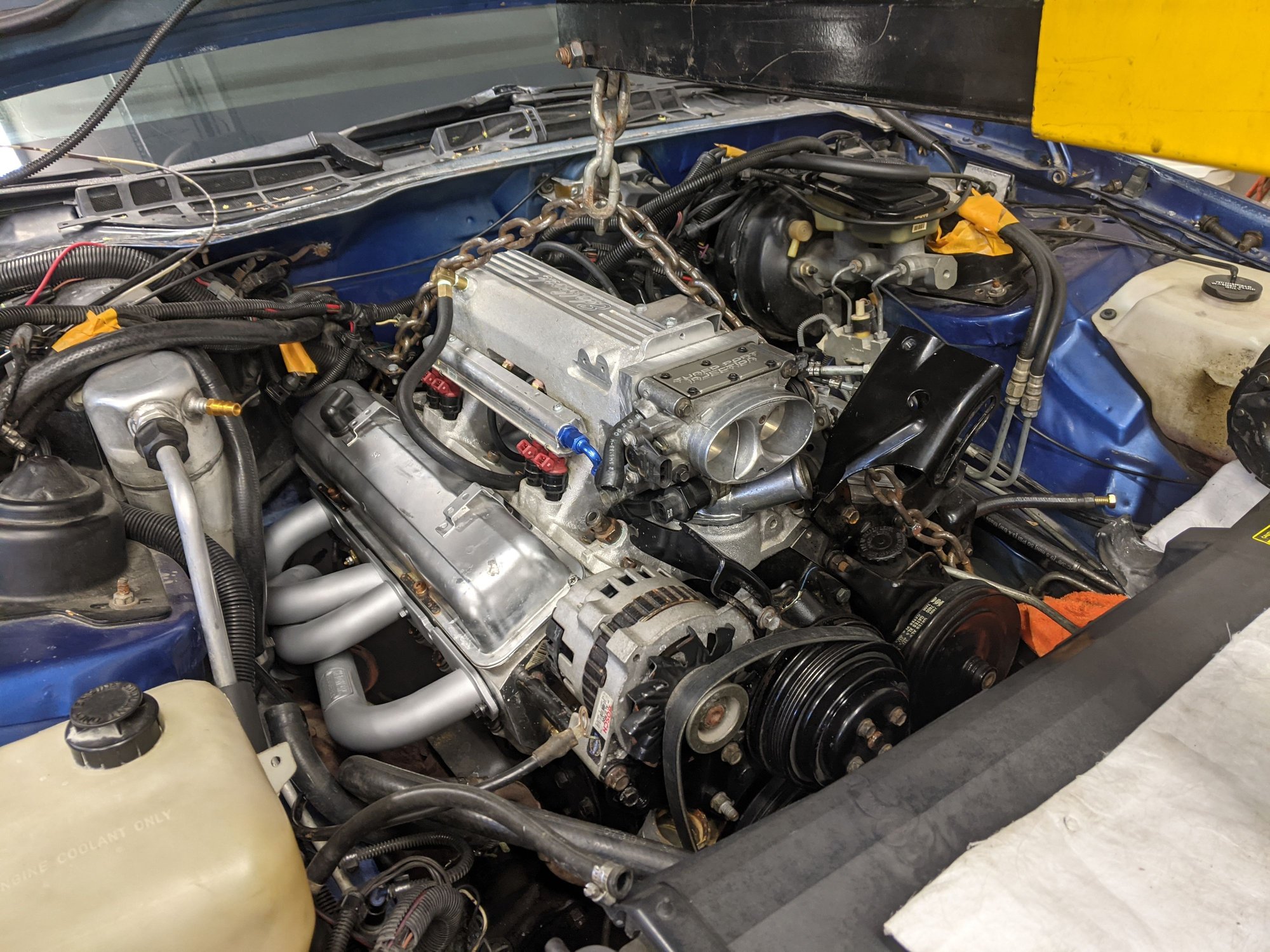

I've started my R&R of my recently installed 383 and new 700r4
Last year I installed the 383 and instantly got a oil leak from the front cover. It is a cheap 2 piece chrome cover from summit. I used one on a 350 tpi years ago had didn't have a drop leak out. This one seems to be leaking from either the pan gasket or the two-piece design the front seal is not leaking.
I feel like I could probably get this two-piece cover to seal or should I just buy a stock one piece replacement?
Since I have the transmission out to install the probilt street strip I figured I might as well pull the engine and fix the oil leaks.
I'm trying to be as clean as possible. I sucked all the coolant out of the rad, hooked the suction up to the cooler line and got as much out as I could. Hopefully when I disconnect the rad hoses and start pulling the engine no coolant more spills out.
This will also give me a chance to reseal an intake bolt that's leaking oil into the intake valley and I am going to install a milling 10551ST HV oil pump. I have close to .0030" main bearing clearance and only get 18psi at idle, which I know is enough but I already have the pump.

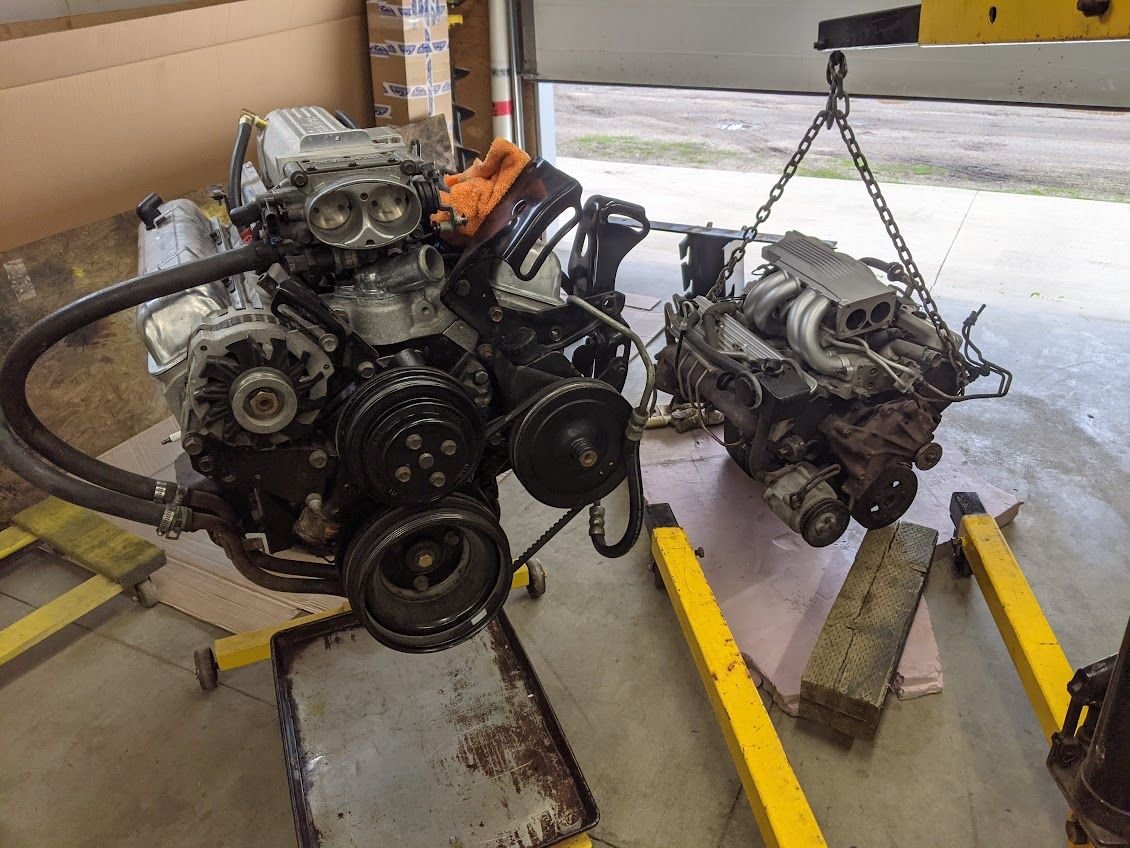

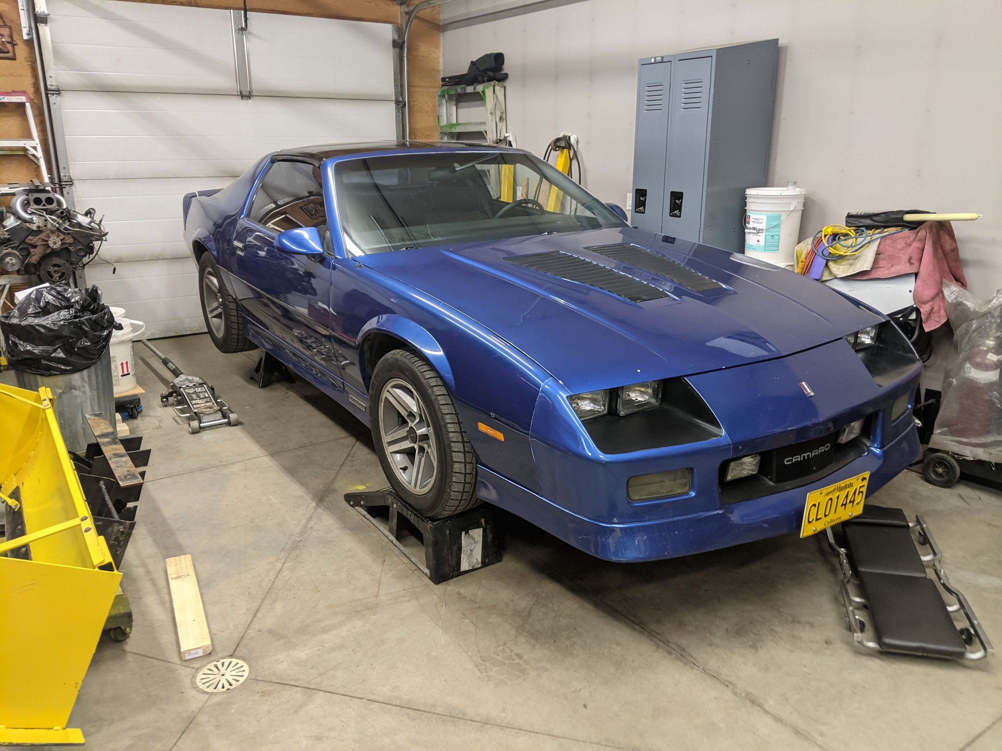

I got the engine pulled this evening. I need a few things eventually but I think I can get the work done and it back in without too much delay.
I pulled the trans and engine separately because I originally was just going to do the transmission. Going back in how difficult would it be to put the engine and trans in as 1 unit?
Old May 30, 2022 | 04:53 AM
aliceempire's Avatar
iTrader: (14)
Joined: Nov 2008
Posts: 2,105
Likes: 181
From: Milwaukee
Transmission: T-5, TH350, T-5
Re: R&R 383 and Pro Built 700r4
I found that in or out while together to be way more work. The down angle required and open space doesn't make it as easy as older model vehicles. It can and has been done.
Old May 30, 2022 | 06:18 AM
89fast5oh's Avatar
Joined: May 2012
Posts: 705
Likes: 95
From: Manitoba, Canada
Car: 1987 Z28 IROC
Engine: 6.2L
I seem to recall trying to install a engine/trans together in a Mustang 20 years ago and remember that it didn't work because of the angles. Looking at the Camaro it would be even harder to accomplish.
When the time comes I will install both separately.

I found the source of the front oil leak. Before I pulled the engine it was almost dripping and after parking it would make a 6" wet spot every time. I used a cheap 2 piece timing cover, I used one on my last Camaro and it worked great. This one was leaking between the oil pan gasket and the timing cover seal groove. When I put the engine together, being a 1997 vortec block, it didn't have timing cover dowel pins. I didn't think anything of it at the time but now i think the cover wasn't in the exact right spot and was causing the leak. The machine shop pulled a stock cover off a engine for me. It looked like it was never off so the sealing surface is nice and flat.
Wire wheeled it up, painted, and new seal. Good as new!
