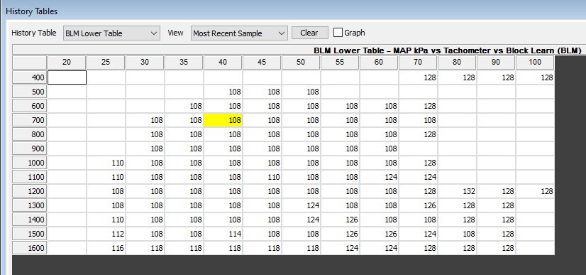

To give myself a fresh start, pulled & charged battery. Well, since battery was pulled no codes should be stored. I hit the highway, somewhere between 45mph - 55mph she really bogged down, no SES light though. Arrived at my destination, stopped logging, and this is what I've found. #1) when reviewing the log I can see the EGR being commanded, but #2, she seems to be running rich. I also stood at the rear, and while no White/Blue smoke I could surely smell fuel.
What does the screenshot tell you?!?

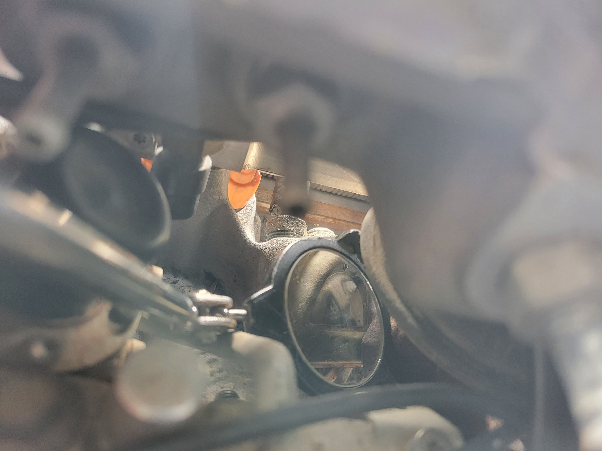

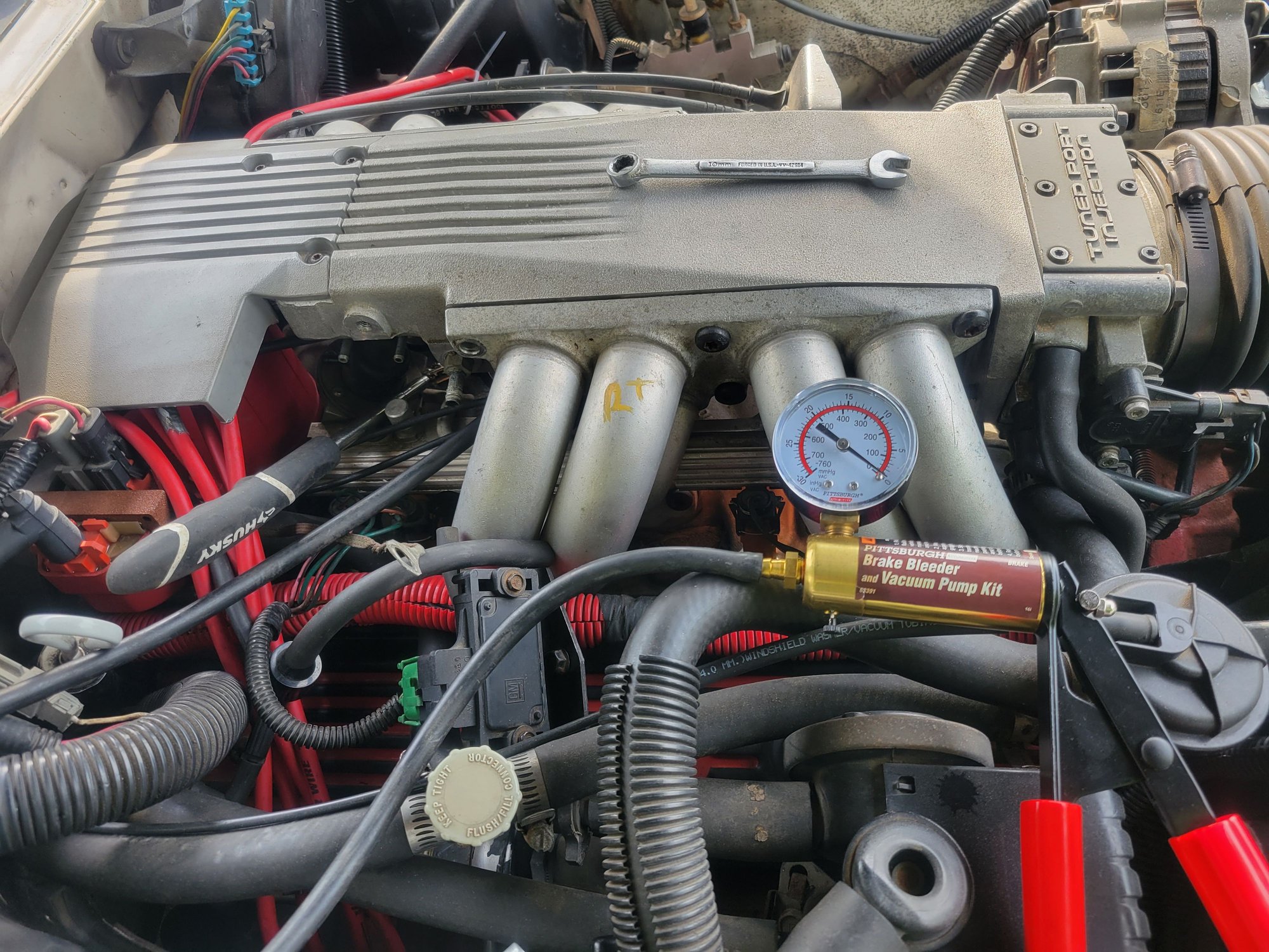

Reporting back as promised. I think I did the test correctly BUT I got ZERO movement from the diaphragm, even pumped the HELL out of my handheld pump and the needle on the Vac Gauge would move like it was trying to pull vac but just wouldn't actually hold any level of Vac. Does the size of the hose from Vac Pump to EGR matter? Example, the vac line off the EGR is a super thin plastic with the boot on the end, the vac line I'm using is "standard"? Pics below on my efforts...
Old Jul 24, 2022 | 09:09 AM
aliceempire's Avatar
iTrader: (14)
Joined: Nov 2008
Posts: 2,097
Likes: 177
From: Milwaukee
Transmission: T-5, TH350, T-5
Re: Help: Code 13 & Code 32 Only @ Highway Speeds
Does the vac hose fit snug on the egr nipple? If yes then you've likely got a bad valve. The movement is quite clear when working.

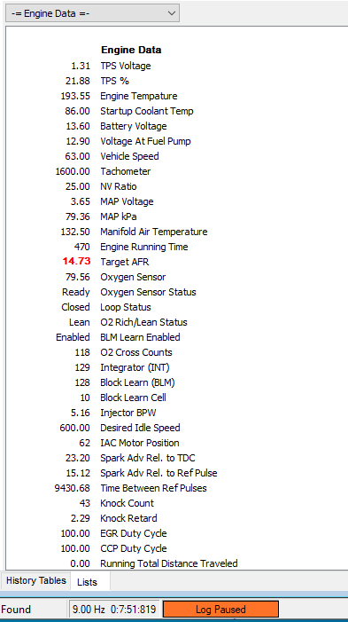

I was lucky, was able to pause the log while EGR was being commanded, at the MOMENT the Code 32 set... see anything here that I should be alarmed by? How about the damn o2 below 100Mv in closed loop! Excuse my ignorance but is o2 voltage determined by incoming air? If yes, how do I balance the air / fuel mix?
