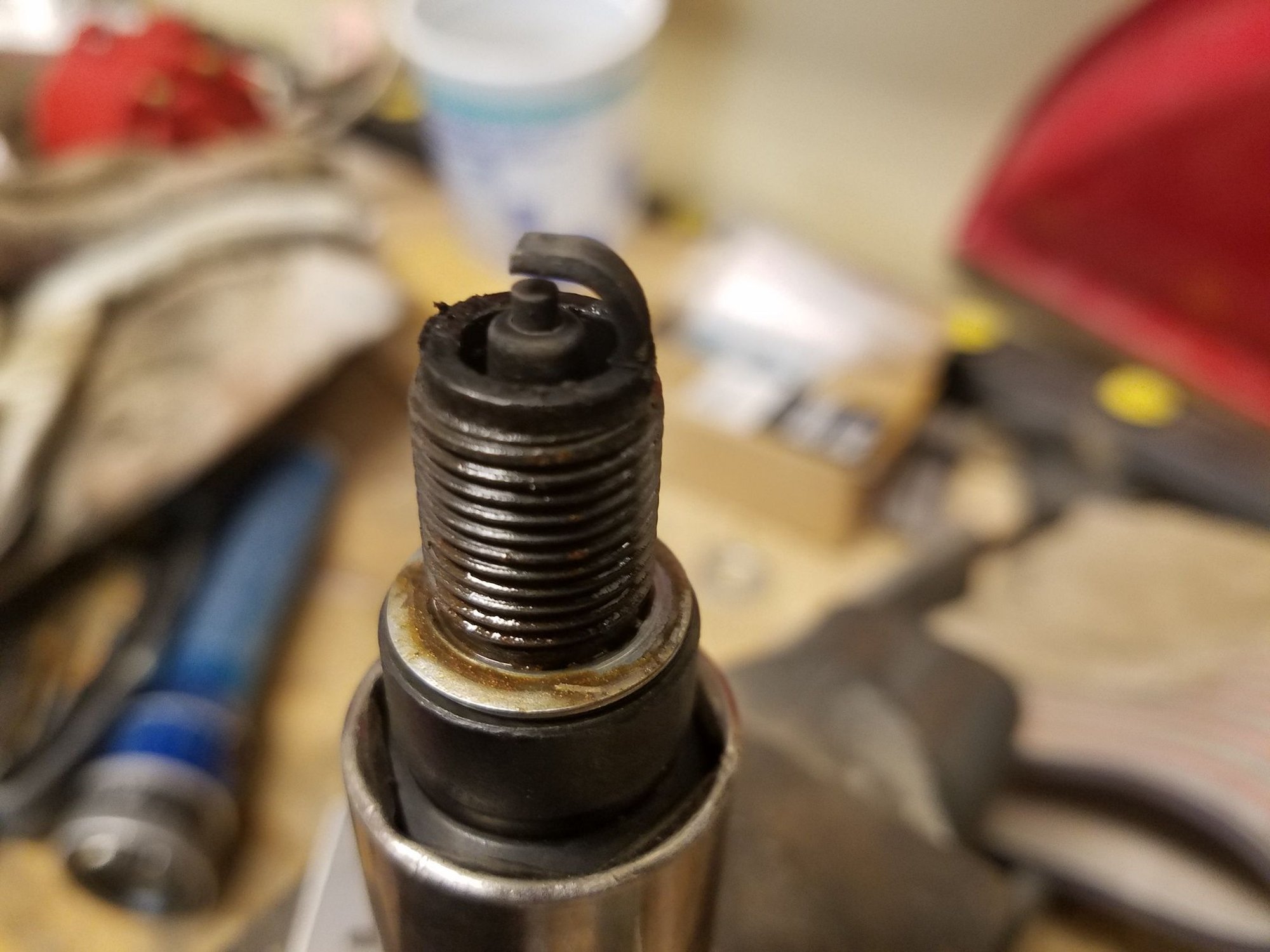

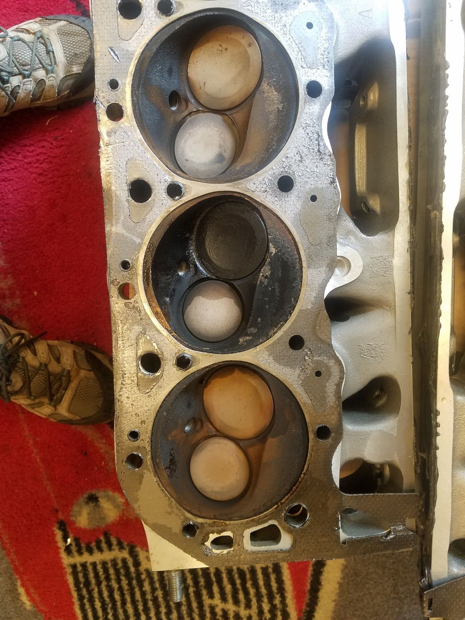

I have been attempting to tune out an issue that has prevailed since I rebuilt the engine about a year ago. I installed a new short block from GM Performance, rebuilt Brodix heads, same 91 Camaro TPI from before, new MSD 8366 Distributor, new plug wires. Engine is 502 Gen VI. Trans is 4L60. Rear end Lincoln Versailles 3:70 gears. Rugged idle all along. Some surging at cruise in the 45 mph. range.

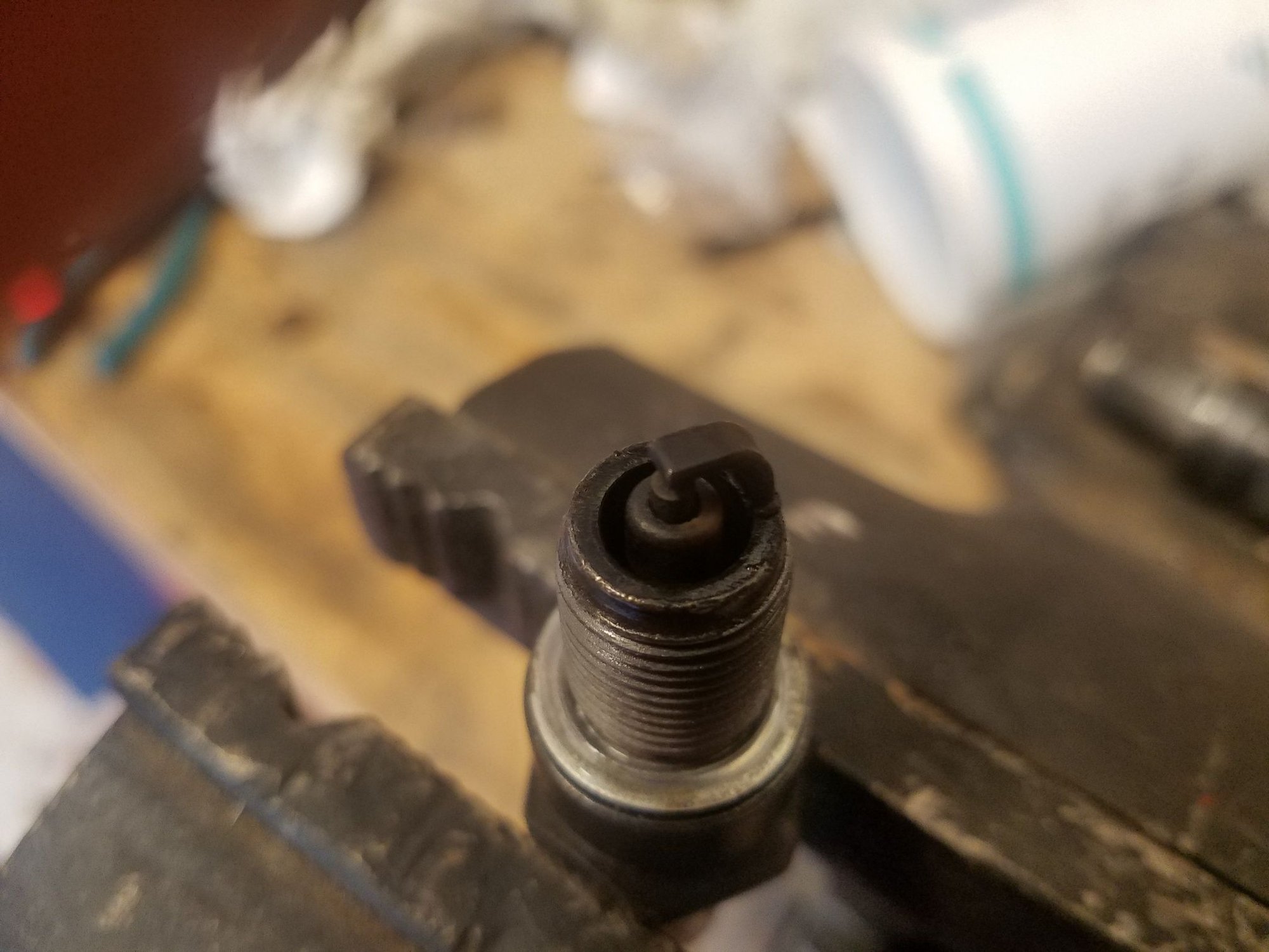

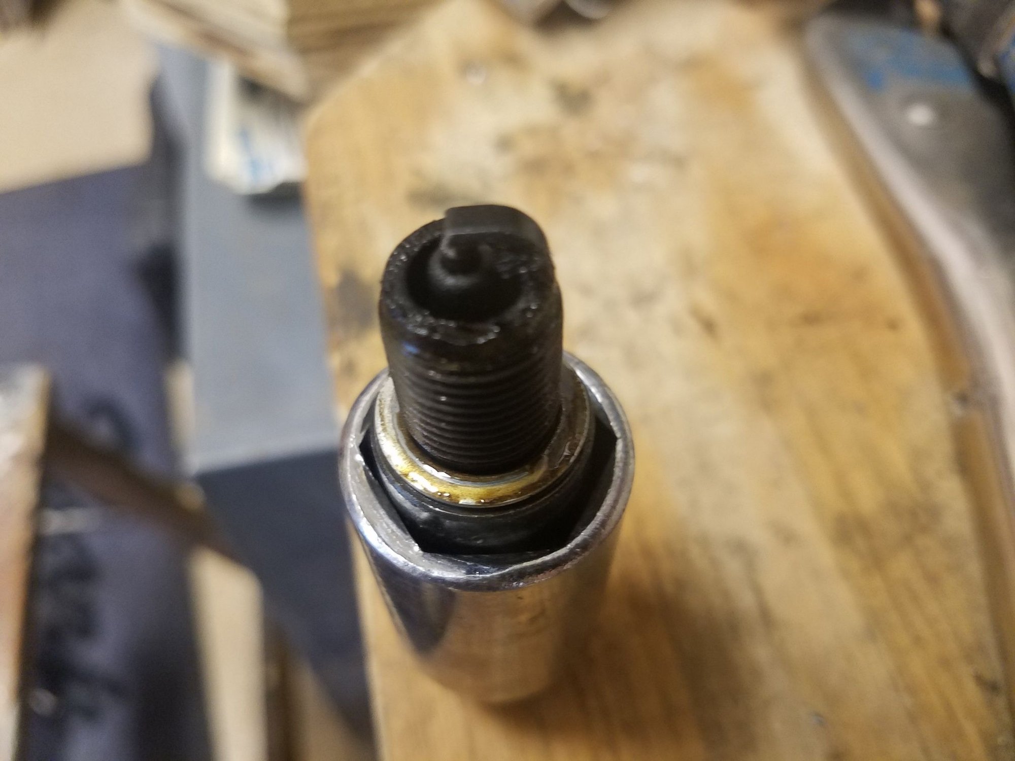

Since the rebuild, I have pulled the plugs three times. Every time I have pulled the plugs, all the plugs look great except Number Six. It has always been fouled. The first time it appeared to be fuel fouled. No oil smell and a dry black appearance. I did a cylinder leak down and compression and readings were excellent. The leak down held into the next day. I installed new Bosch injectors and put on a new plug wire for number six.

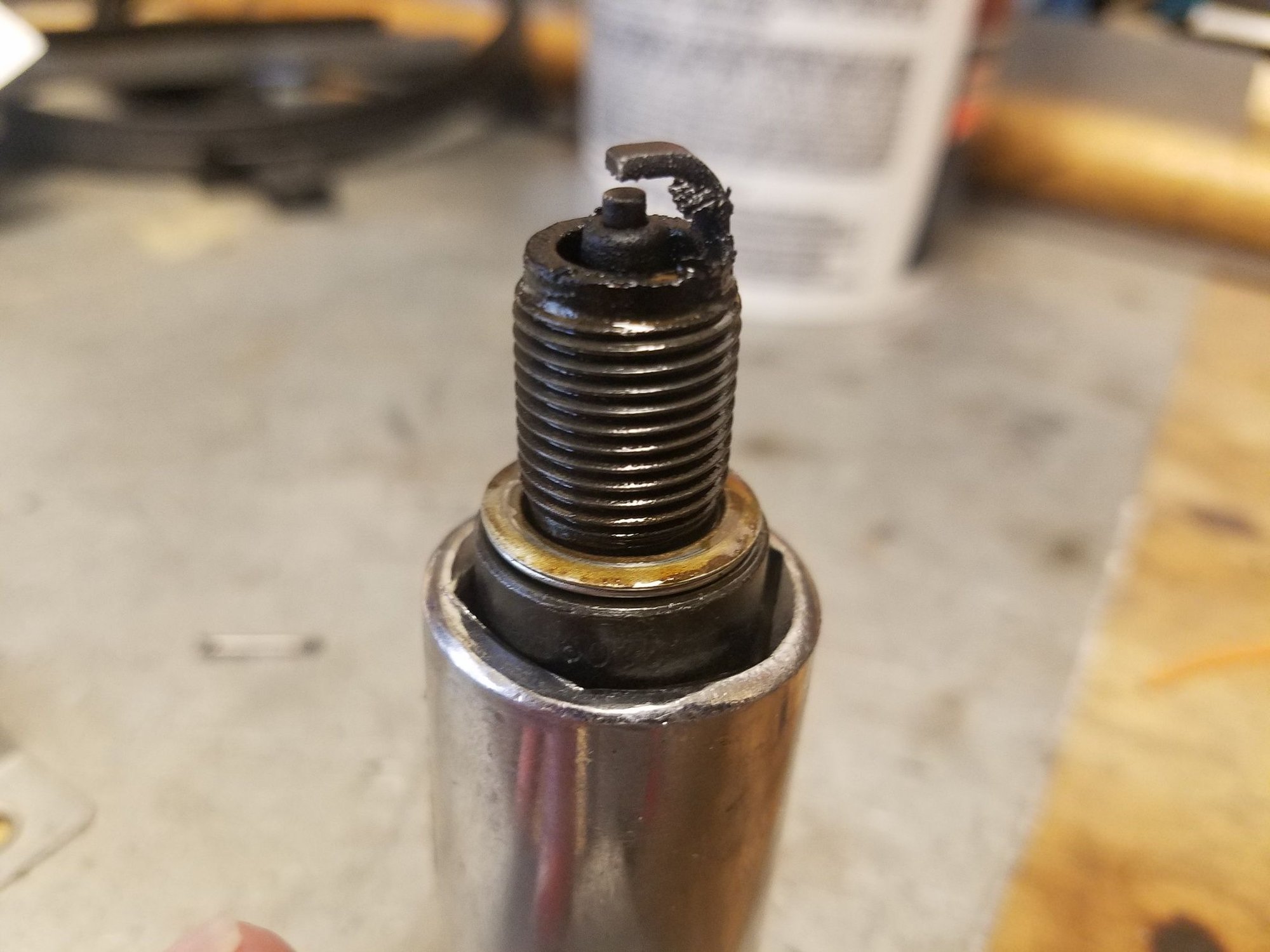

A few days ago, I pulled number six plug again. Black and wet. No smoke on start up, so suspected oil from lifter galley being sucked up past a bad gasket. I pulled the intake manifold.

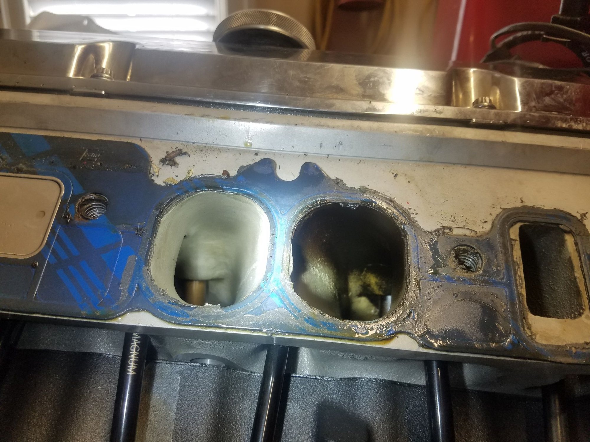

To my surprise, the intake runner for number six was pristine clean. Absolutely no evidence of that cylinder ever being fired. The other seven have black on the upper surfaces of their intake runners. Never firing led me to the distributor. The number six contact post on the cap of the MSD was black. All the others were bright brass. Removing the boot on the number six wire (both new and the replaced one) resulted in the contact clamp under the boot was corroded. Removing boots from Adjacent plug wires resulted in new looking clamps, no corrosion.
I have been around engines a long time. This almost appears like something wrong with the MSD that would cause it not to fire on one cylinder. But I cannot imagine how that could be with the magnetic trigger in the distributor. I also notice that the MSD appears to be out of phase. The rotor is well past the location of the cap contact when the trigger is aligned.

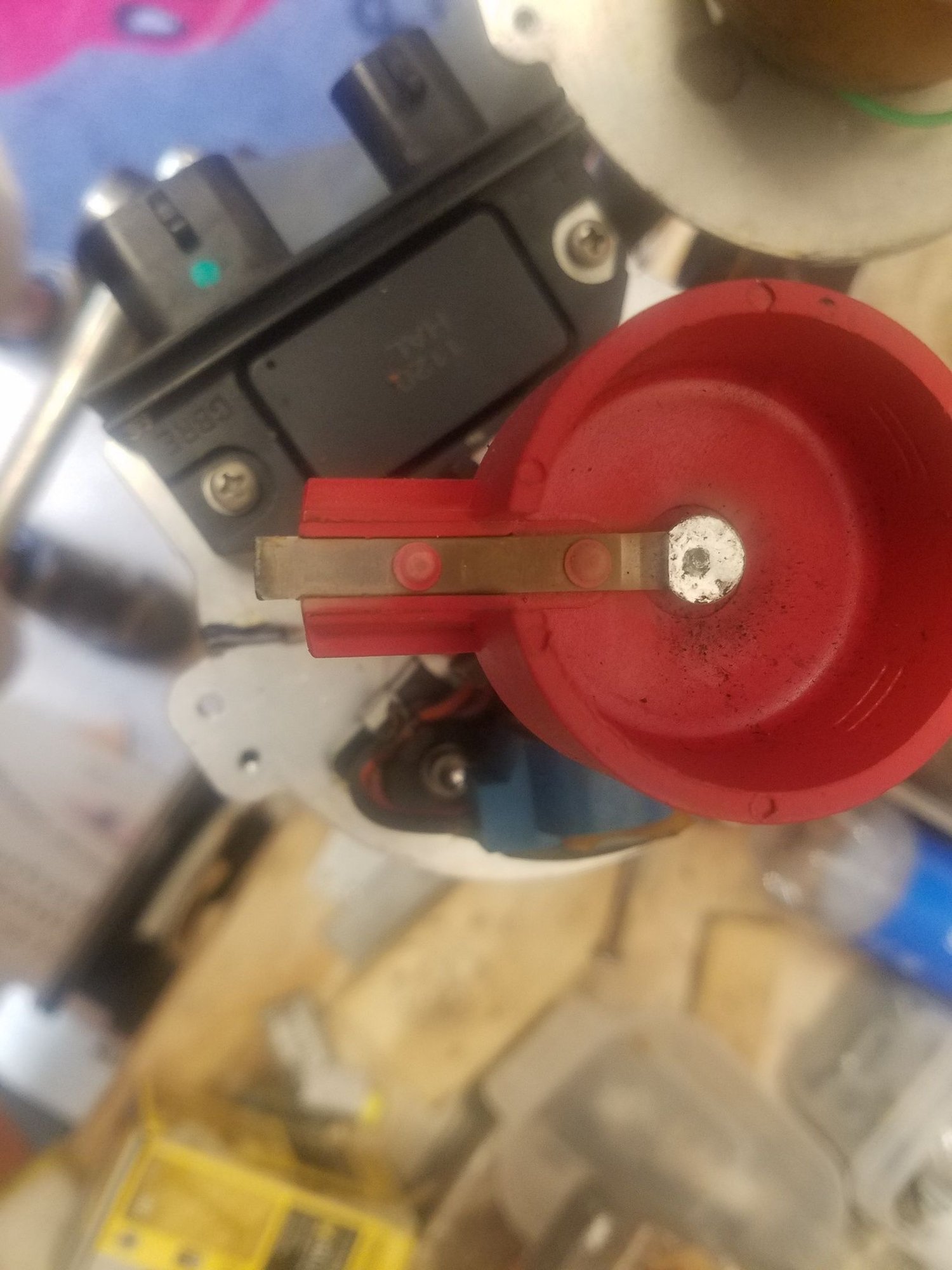

See pix. Photo of Intake runner for 2 & 4. Photo of intake runner for 6 & 8. Photo of MSD (Red) phasing. Photo of OEM (Black) phasing. Photo of cap and photo of plug wire end.

Replace the distributor/cap/rotor with a GM small cap along with a GM coil. Replace the #6 spark plug wire. Check/replace the valve stem seal on the #6 intake valve. And of course a new plug on #6.
If that doesn't fix it, then need to do things such as compression and leak-down tests.

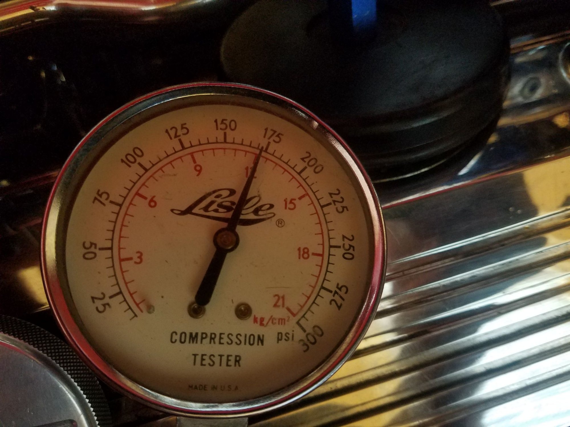

Cylinder leakdown was in the good range at 9% and held until the next morning. Compression dry was 175. I have changed the plug three times, the number six ignition wire once and changed fuel injectors once. What I haven't changed since the rebuild is the distributor, the distributor cap, the rotor or the coil. The OEM distributor is about $600 new. I have my original one that was working when I did the rebuild. I replaced it with the MSD 8366. I am going to put the old OEM distributor back in with new cap, wire and rotor.
What is baffling is the absolutely pristine clean number six intake runner and the apparently burnt post on the distributor cap (number six only).

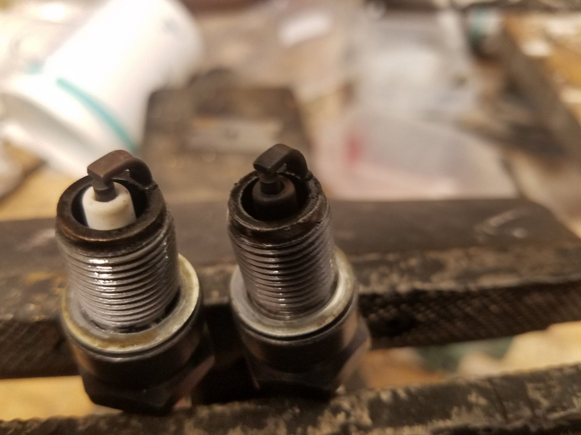

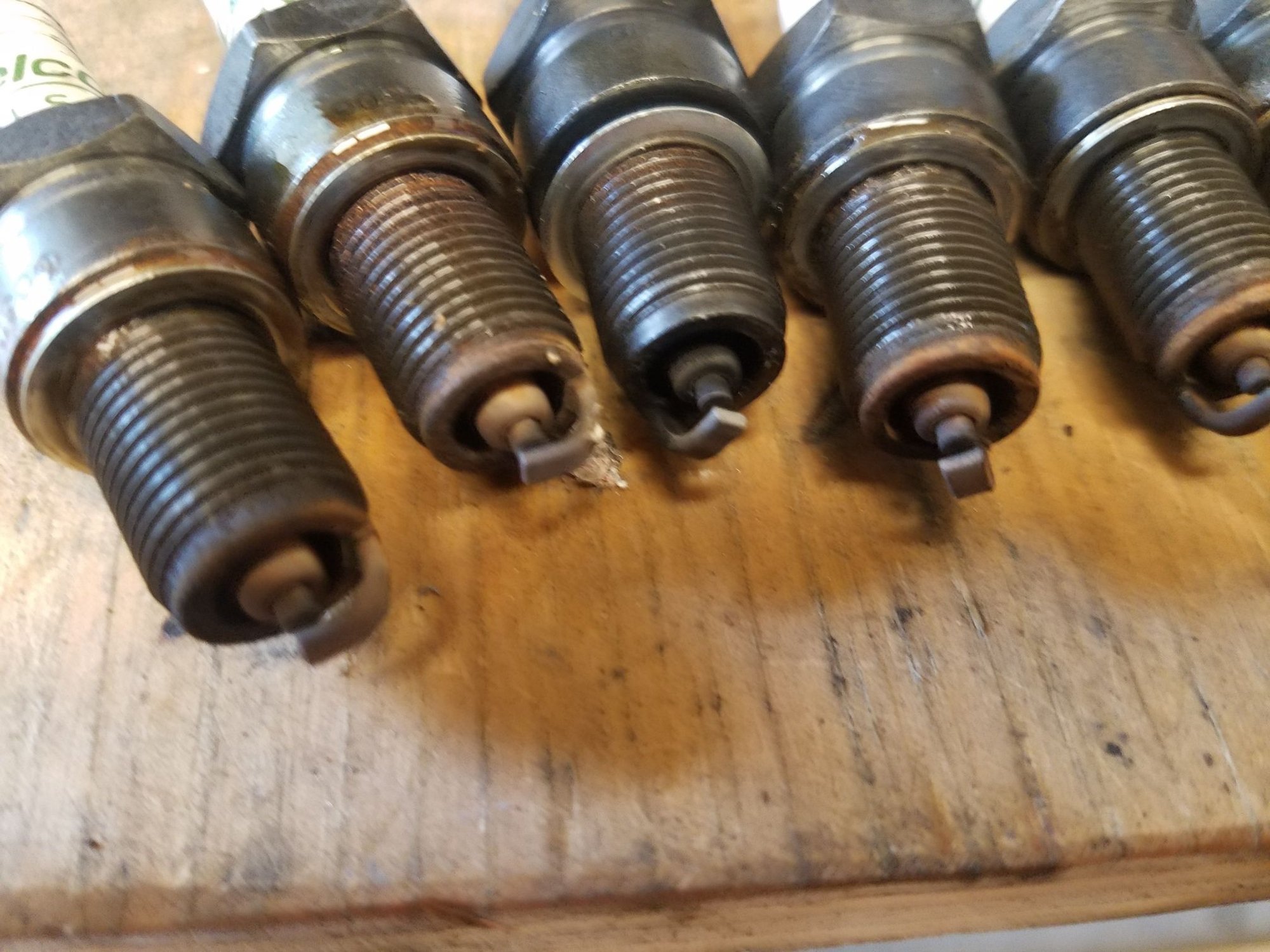

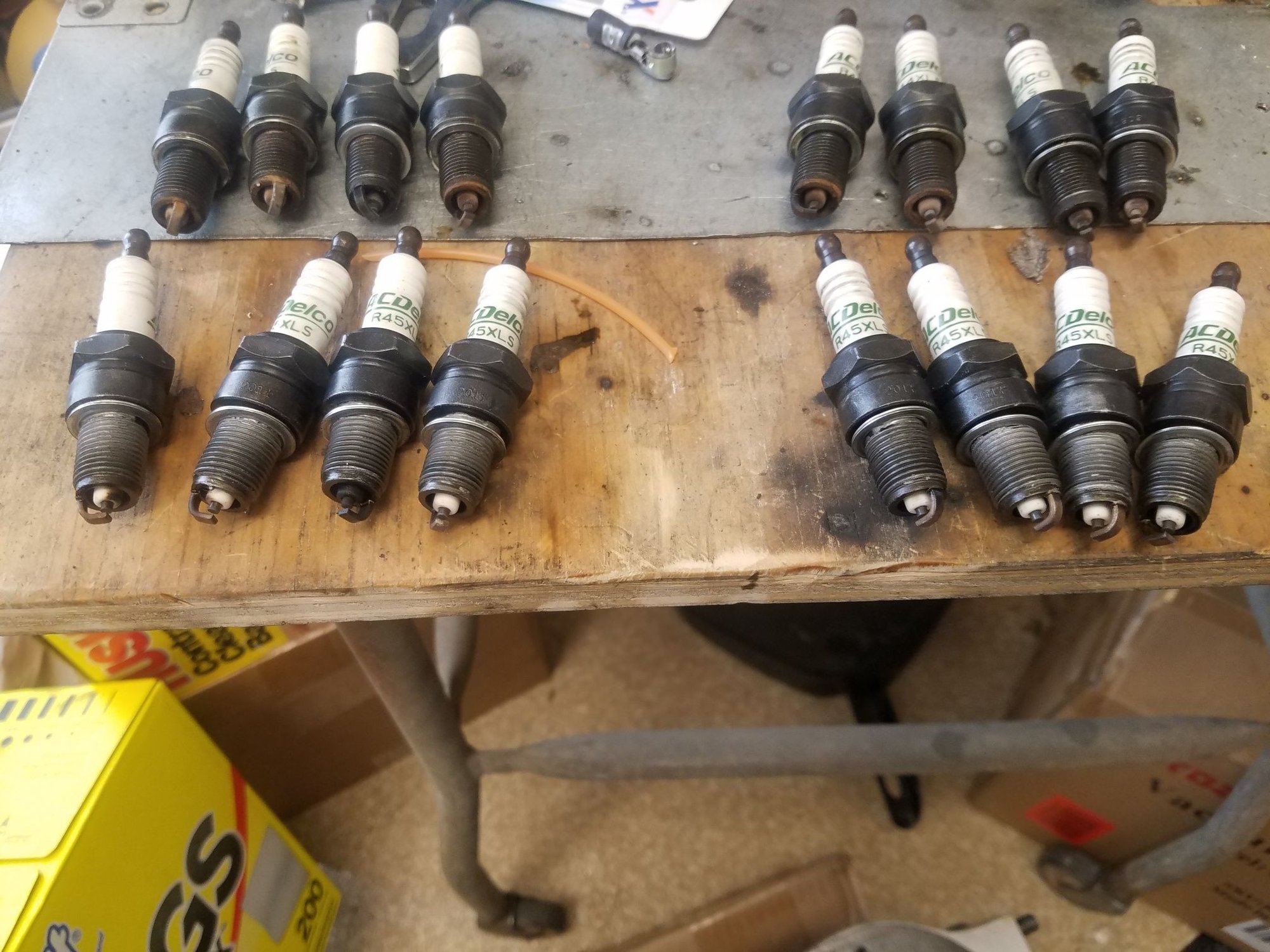

Put back together with new Edelbrock intake manifold, new rotor, new plug wire, new plug, new distributor cap, and the OEM GM distributor. After startup, all cylinders running close at 400 * F at the exhaust port on the headers. Prior to this, replaced original injectors with Bosch units.
About 200 miles later, pulled the plugs.
Number six is the dark sooty looking plug. From left to right 2-4-6-8 7-5-3-1
7730 ECU batch firing
Looks like number six is really fuel fouled, but not sure how that can be happening.

For 200 miles they all look awful. I'd expect them to be near new looking. Is 6 getting oil fouled?

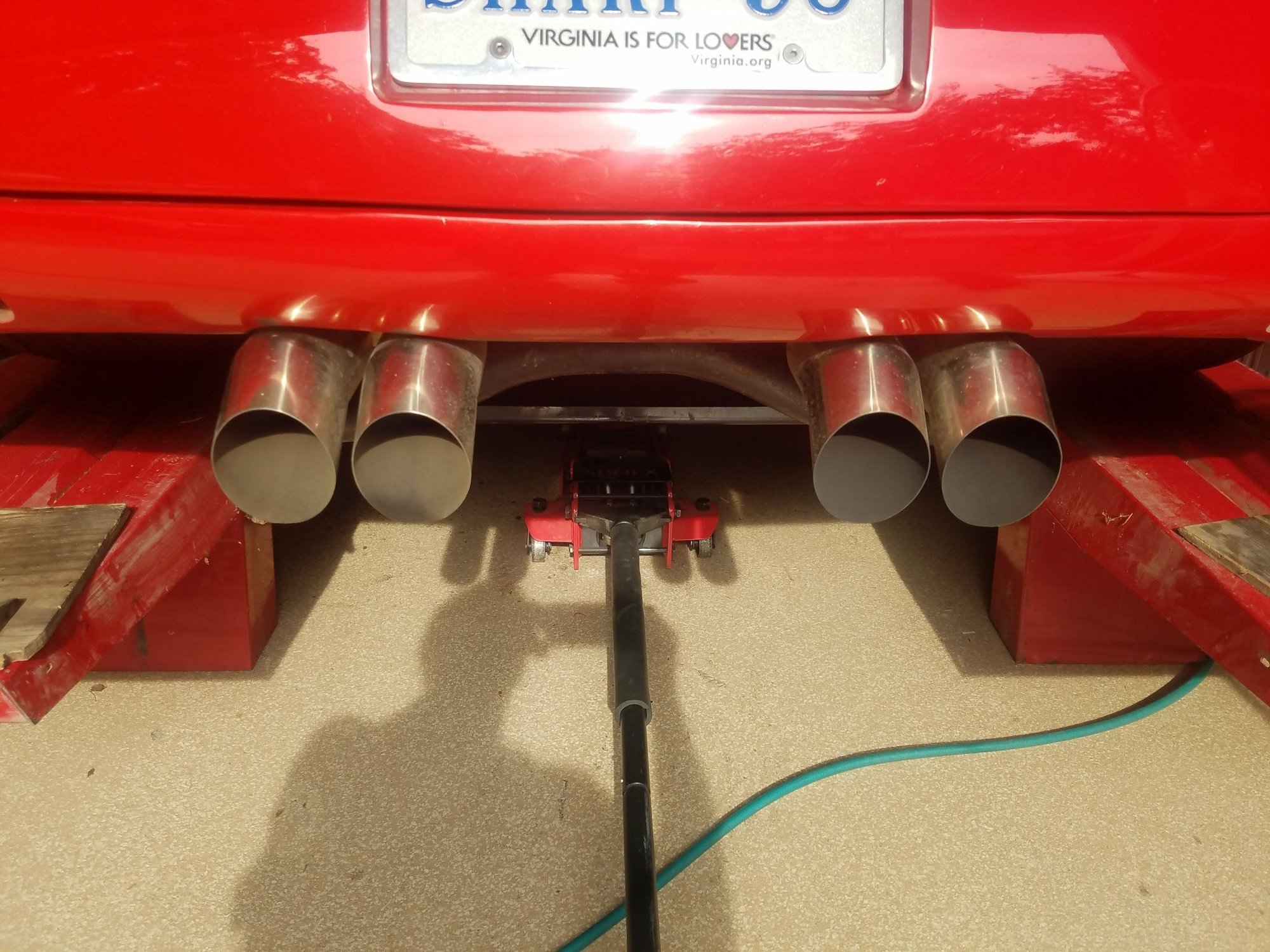

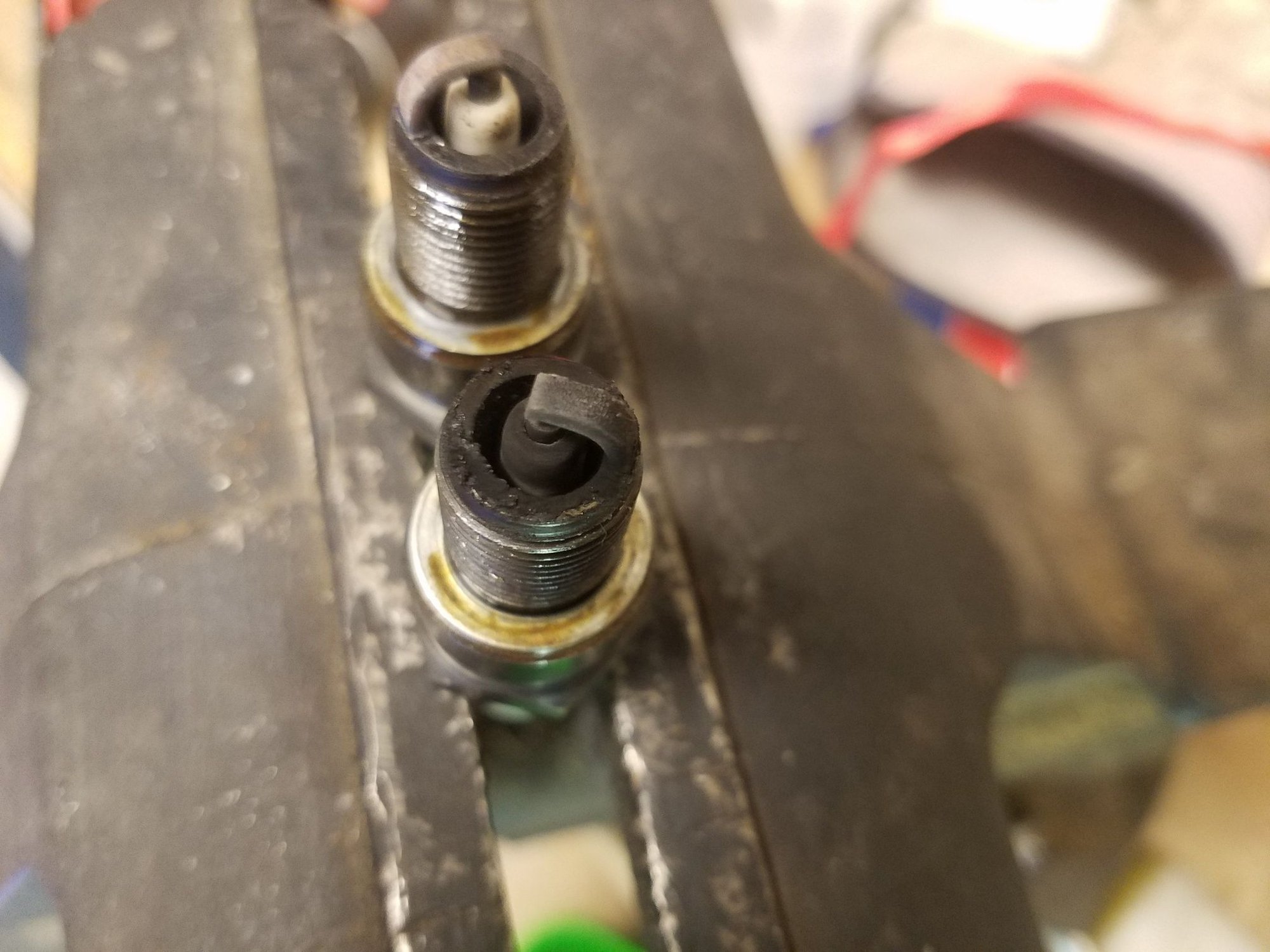

A little more history. I had an exhaust header leak in July. The plugs are almost impossible to change on the BB due to the shorty header. Took advantage of removed headers to change plugs from the rebuild done six months before. Number six was black. See photo dated 220714. I suspected a leaking fuel injector. The injector in it were the Bosch 028150945. I had had those cleaned and flow tested before the rebuild. Regardless, I forked out the cash for eight new Bosch 115 V injectors.
Ran for month and pulled number six again. This time it was terrible. Looked oil soaked. I have no smoke at start up so suspected a leaking intake manifold gasket sucking oil from the lifter galley. But, when I pulled it down, found all sorts of issue with ignition, including a burnt post on the distributor cap and corroded wire on number six (heat). Those photos are at the beginning of this thread. Number six plug photo from 20220821.
After all those corrections, you have the September photos of all six plugs.
Prior to this, I only changed the number six plug, the other seven are original from the rebuild. The look to be cold to me
I think it unlikely to be a bad injector since I have swapped them and the problem followed the new injector in number six. The wiring harness is the same. Batch firing, even side all firing at the same time. Physically, the harness to the injectors looks in good shape.
No Cross over pipe in the exhaust. You can see the discoloration in the exhaust tip

I'm inclined to say it looks like oil fouling on 6.

How's the valve spring on intake #6? Pushrod? Yeah that intake runner looks very peculiar.

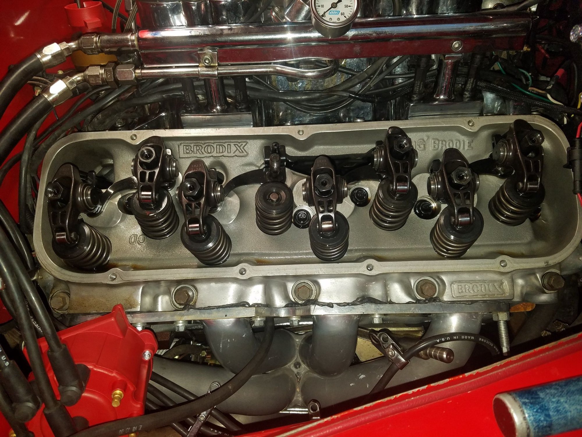

I have rotated the crank and observed the intake and exhaust valve opening and closing on Nr 6. The block is a new short block from GM Performance ZZ502. I have seen no evidence of metal in the oil through three oil changes. Suspect the cam / lifter to be ok. Full roller rockers for Compcams. I have new Brodix oil seals coming and will remove the spring(s) on the valve and change the seal. These are Brodix BB1 heads
There is something definitely weird here, beyond my experience, so really appreciate others insight.

none of those plugs look particularly good for 200 miles. The orange rust color is indicative of water, not sure how else you may form that color in such short a time. Oil fouling and rich/misfires #6 creating those deposits. #3 and #1 have excessive deposit accumulation around the ring which should be only a dark unbroken smooth carbon appearance.

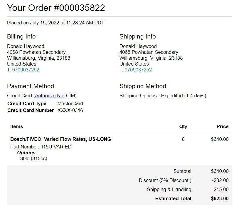

Where did you get your 'new' injectors? There are so many counterfeit bosch there could be part of your problem right there. It causes these random fueling issues you are having for starters.

I would start by questioning the quality of the injectors, honestly. Get that sorted 100%. SBC always have a bunch of sorting out to do... ignition is tough to keep up with. I still have header fingers from 1998.

2. The injectors were acquired in July from Five O Motor Sports. Theoretically, bonafide Bosch units. Certainly cost as much.

5. I had a single spring compressor from my small block days. These Brodix BB1 head have multiple valve springs. I ordered a stud mounted spring compressor and Brodix seals. Thing that I HAVE NOT changed regarding number six are the injector wiring harness, valve seals, valve train and rings. Compression and Leak down are great. I will know more after I look at the valve seal.

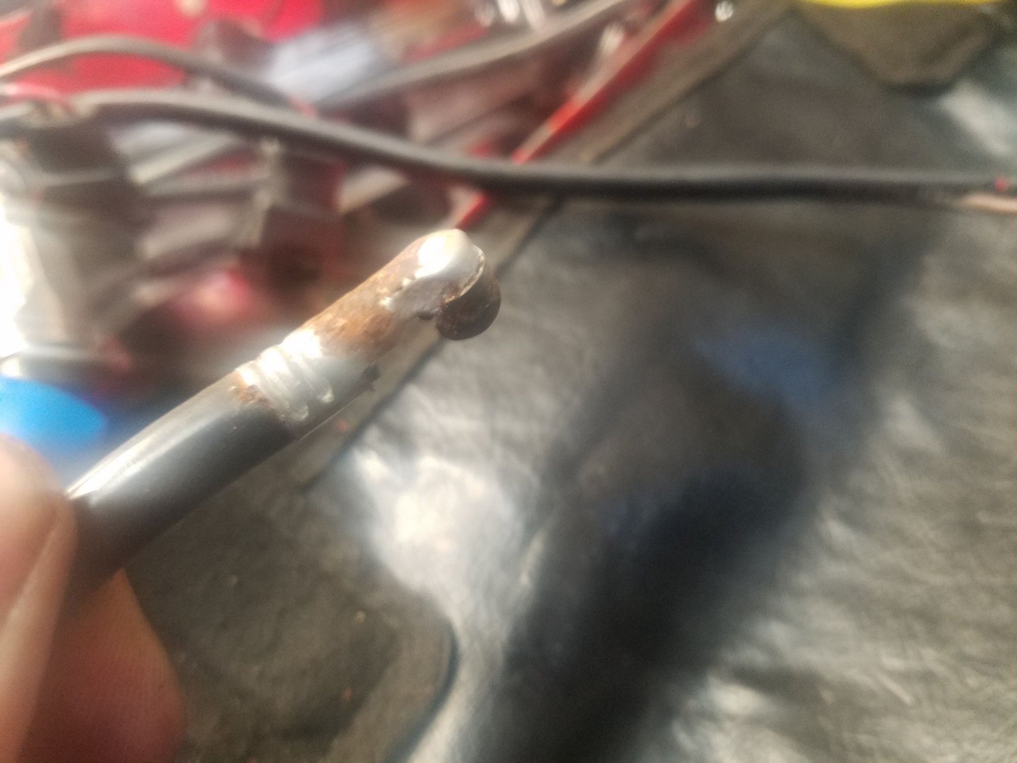

In looking at the wiring diagram and the physical wiring harness (25 year old harness), even side fires at one time. Without taking off the sleeving, it feels like, two wires split to two wires (6-8 and 2-4) then splits again for 6 vs 8 etc. The diagram would indicate that the injectors are powered at 12v and the ground side is fired from the computer. I thought about a bad insulation causing a ground short and firing the injector out of time, but all four would fire, not just six.

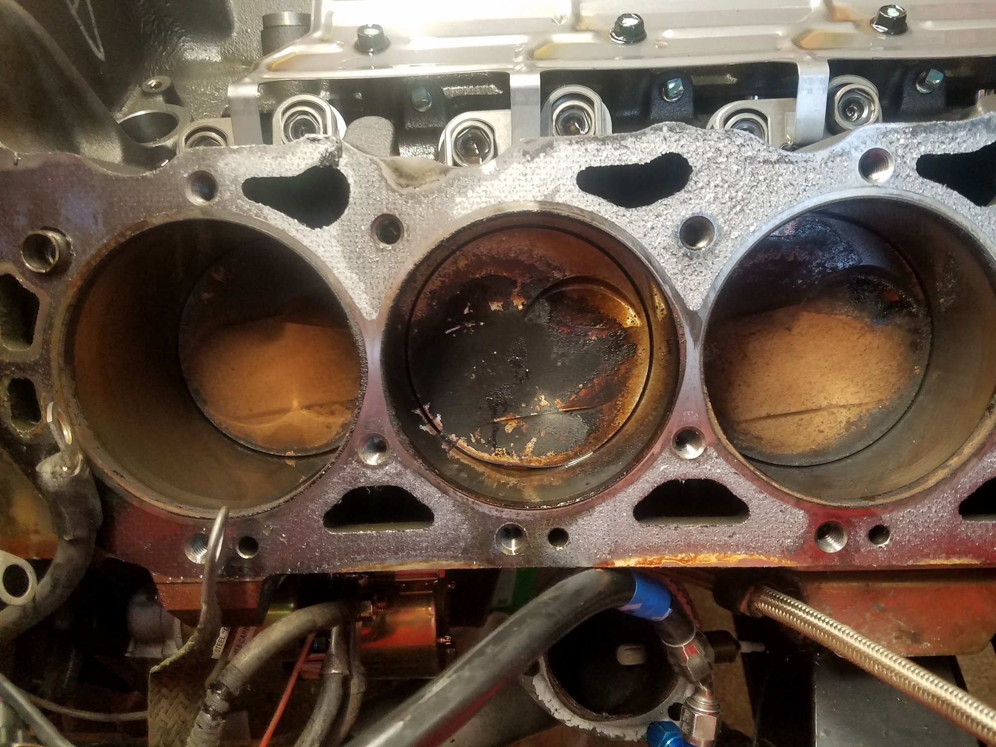

Fed ex is supposed to deliver the spring compressor today. I am hoping to pull the valve spring and check the seal and will report.
I find the photo at the top of this thread the most disturbing. The one I am referring to is the pristine clean fuel runner in the cylinder head for number six. I have racked my brain trying to diagnose what would have caused that single fuel runner to be clean when the other seven were not. That particular situation is when I felt the plug was shorted out (the photo of the really nasty wet looking plug) and caused the distributor cap to arc at the top post and heat up.

SO you say number 6 has a super clean runner? How do we suppose the other runners get 'dirty'. Likely during combustion some carbon blows past the valve into the intake ports?
If the runner is clear perhaps the cylinder is misfiring. This would allow fuel to soak the plug and create deposits.
Otherwise how can carbon coat the runner?
Any PCV hoses attached nearby or to #6? The PCV is integral to engine cleanliness. It will have dramatic influence on oil quality.
next, orange coolant, and orange crud on plugs, that is a coincidence too much for me. I think you may have heads with leaking valves and leaking coolant? Wrong head gasket could explain the coolant but not the valves.
Maybe valves are being held open? Wrong lifter or pushrod lash or some adjustment there? I would recommend a degree wheel, perform the camshaft rotation with no lifter (remove the pushrod) to determine base circle first, then perform the degree with comparing KNOWN base circle to the proper adjustment you are using. You may find the valves are open when they should be closed. This would explain why the valves check out fine at the machine shop but blow dark carbon into the runners.

The photo of the two plugs attached hereto resulted in changing the Injectors. The plug looked fuel fouled to me
A month later, I pulled number six plug again and found the plug in the single plug attached hereto. I did not have smoke at startup, so concluded the oil could be coming from a bad intake gasket sucking oil form the lifter galley. In pulling the intake, I found the clean number six intake runner. The plug looked really fouled, perhaps completely shorted. I think that is the reason the post on the top of the distributor cap shows evidence of heat. You can also see the MSD seems to be screwed up on phase compared to the GM OEM distributor.
I am going to check / replace the valve seals on six. I will double check valve function and lash before installing hotter plugs.
The photo below this was the same cylinder after replacing the intake manifold gasket and ignition. This one look dry carbon

A '7730 only has one injector driver. So all eight injectors fire together at the same time.
The clean runner is due to the plug not firing (fouled and shorted). So no combustion gases/carbon to blow back past the opening intake valve. And the injector spraying fuel keeps the runner clean from when the plug did fire.
To me it appears that there is a lot of oil on the spark plug threads and indexing washer. Last time I had an issue with a single cylinder the valve stem seal was riding the valve stem. No longer attached to the valve guide.
RBob.

Not that it guarantees a thing, but the block is a new short block from GMP about 16 months ago
I am using the brown looking anti-seize on the plugs which may contribute to the "oily' look on the threads of the plugs, etc
Leak down and Compression

With a leakdown it can be difficult to tell where the air is going. The sound is "coming from everywhere" we often assume 100% is passing the rings but it could be that some say 25% is really going up through the valve stem past the valve seal possibly. Usually when we do the leakdown we are not having the valve cover off and submerging the valve seal to look for bubbles but I suppose that could be done in the future? On the other hand, leaking up is not the same as leaking down, i.e. the valve may seal air from leaving but not oil from dripping down. So its one of those things where our diagnostic tools are either unappreciated fully, limited use, or tell us only one sided information.
I think the right thing is on the track of replacing the valve seals on that cylinder to rule them out.
That would leave rings for the case of oil induction, if the intake port is clear from oil. It has to come from an intake port, rings, or valve seal amirite?

I still wonder about the orange coloration on the other plugs and the fact some are forming deposits as well. Perhaps more than one cylinder is leaking down oil. Or has some oil related issue.
They should never form those kind of deposits. However maybe I am spoiled with modern engines which leave perfectly clean plugs, I just dont know about those old engines anymore for comparison.

Okay, the anti seize is a huge problem if done excessively. We need to talk about that real quick.
FIrst, it makes diagnostics very difficult. We are not sure now whether you have oil inclusion or simply anti seize over-use. See what I am saying?
When you apply anti seize, first, use the gray stuff so you can see some gray colors in the future, possibly identify it.
Next, Never apply it to all the threads or near the plugs tip. Antiseize over time will OOZE and work it's way to the plug tips.
ONLY apply a very tiny dab of anti seize near the upper part of the plug, say about 7 to 10 threads up the plug away from the tip.
Over time it will ooze towards the tip. The goal is: You NEVER want the anti seize to reach the plug tip.
If antiseize reaches the plug tips, it will form deposits , hot spots, hard conglomerates like what we are seeing. It will look similar to burning oil. It will ruin the plug, make combustion inefficient, it will ruin the way the engine runs. It will cause misfires.
You must keep the plugs clear from anti seize on their tips where the business end is conduction and combustion.
Over time some oil from the cylinder will develop naturally on the threads anyways, acting like anti seize, so you don't really need much if any at all for that engine.

Did you measure the distance from distributor pole piece to the pickup when the distributor is pointed @ #6? Vs the rest of them?
If there's to much gap, it won't fire.
I've see that happen b4, machining issues on the pole piece not triggering the pickup on one or 2 cyls.

There's a photo in the beginning of this thread showing a red Distibutor (MSD) and a black distributor (GM OE). The black mark is aligned with number one the cap. The rotor in each photo is aligned with the magnetic pickup on the distributor shaft for firing the coil. The MSD appears way late in phase for firing relative to the cap. The MSD was installed with I had the wet number six plug, corroded wiring and heat discoloration on the cap connector post. I have not looked for a difference between the rotor contact and the cap contact.

Cap and rotor should be fine.
I was thinking more along the lines of the distance between the pickup coil and the trigger wheel on the dist shaft.
Think of a 8 point star with one leg to short. If it spins and all the legs are close to a pickup but one, you'll have 7 sparks.
​​your cap reminds me of 80s-90s coil pack cars when they stop firing, the terminals looks nasty like that.

Old valve stem seal removed and replaced. I could see no obvious issues with the old seal other than what looked like oil inside the seal. I guess oil could be sucked up from the spring seat.
The old seal was a Brodix seal, identical to what I had acquired for the replacement. Heads were new in 2002. I sent them to Brodix in 2021 for a rebuild. They disassembled them and gave me an outrageous quote. I had them reassemble and send back to me. I doubt the changed the seals. I then sent the heads to a local machine shop (in Colorado). He said he replaced the seals. Unless he used Brodix, I don't think so.
Anyway, waiting for new plug harness to test it out. The flash gives the oil a reddish orange look, but clean oil.

I will know shortly. Manifold is off. Pull the headers next. Pull the plugs. Rotate the engine and watch valve train. Pull valve train. Pull heads and cross fingers.

OK, here's what I found
1. After pulling all eight plugs and aligning them with the prior set, number six in both sets is fouled. The other seven are in various states of being OK
2. When I pulled the head, the cylinder number six has a little pool of oil at the bottom. In the corner on top of the piston. Above the piston ring. No signs of scouring on the cylinder walls.
3. The intake valve for number six is very wet and oily looking. The exhaust on six and the other valves look ok.
My thoughts are that the oil on top of the compression ring, along with the good compression and cylinder leak down, gives me some comfort that the problem is in the head. After running and shutting off the engine, now sure how oil could come from the cylinder and get on top of the compression ring. Has to come from above. The black and wet intake valve looks to be the issue. I put a new seal on it, but may be a different problem or the clearing is too much even with a new seal.
I am going to take the heads to an automotive machine shop and have them evaluate number six. If they can find the issue, I won't pull the piston. I will have them completely re-do the heads.
Any thoughts
Don

ULTM8Z's Avatar
Posts: 4,655
Likes: 319
Re: Rebuilt constant missing on number Six
Yeah at this point I'm also suspecting something in the head. There was also the symptom of the sparkling clean intake port too.
It's good you bit the bullet and did the tear down. These GM short blocks are expensive. But they're good quality too (I got the HT383 short block).
It'll be good peace of mind when the head is fixed and you know your short block is solid.
