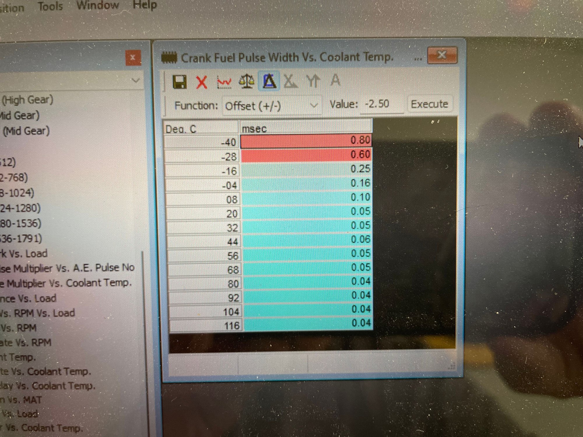

Try adding to this table dependent on what coolant temp your startup is.

The offsets are probably changed i don’t recall. Might have to experiment with the table posted. Honestly don’t recall do you have a burner is it a updated 27sf512 eeprom or stock prom in holder 2732
So do the fuel parameters need to be adjusted to take into account not having the cold start injectors? If so ill fill out your form on your site and have you do it, I dont have the equipment

Usually going from 86-88 tpi maf changing to 89 tune takes care of this issue.
85 I haven’t fooled around with much to refine cold start cranking . I do have a few of these older chips to try. Just need information like what temperatures it’s stalling at and I can try to add fuel to effected areas just not sure how much so it may or may not be an easy fix. Send me a email and I’ll try to assist. I’ve updated my website had a current problem but will help when I’m able.
