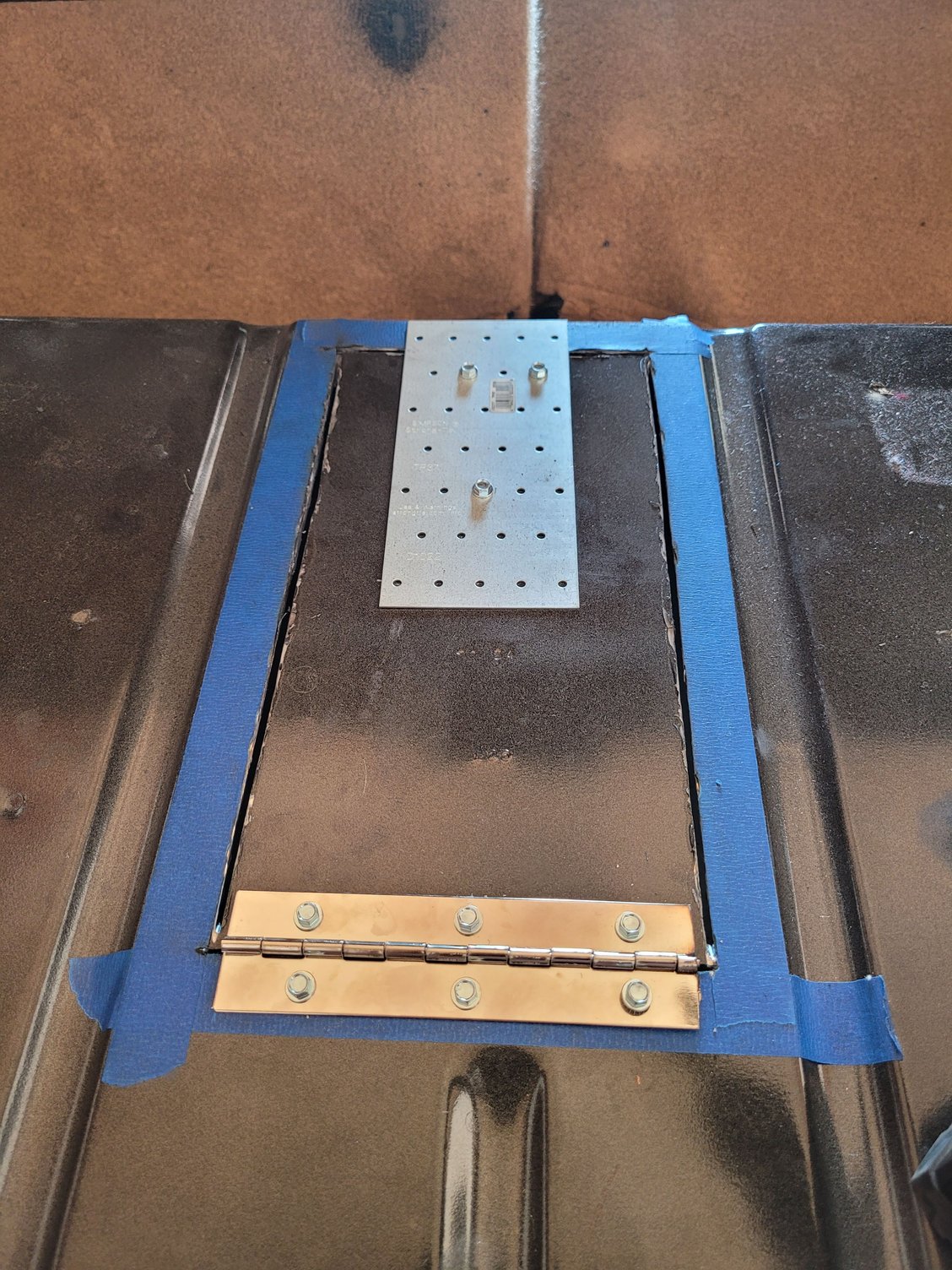

This worked for me.
Old Dec 28, 2022 | 12:39 AM
Bishopts's Avatar
Joined: May 2022
Posts: 191
Likes: 19
From: South dallas
Car: 1988 gta
Engine: 5.7
Axle/Gears: 3.27 posi with discs
Re: I want to remove old gas from tank
Pulling the fuel feed hose off and jumping the relay is what I would do if I hadn't already made an access panel.
my level sender was doing what you described and since I have really easy access to it now I ended up just pulling it out and cleaning up the contact grid with fine sandpaper. It works better but the spring tension in the contactor is pretty weak so I'm sure I will get a new sending unit to fix that.

I think that's a hardline. Might be easier at the filter

Bold move posting a picture of an access panel. Brace yourself for the verbal flogging, irrational hatefulness, and death threats that are sure to follow....
It was a nice thread. Oh well, all good things come to an end.
Maybe, but there are OTHER ways to deal with that, too.
it's true but I've delt with forum lurkers long enough to know what i do and post about with my car can rub people the wrong way but at the end of the day I put gas in it and it's parked in my garage so it's not their problem.
the great thing about people not being afraid to show what they have done is that it can give others an idea. Maybe do it like they did, maybe change it up a little.
