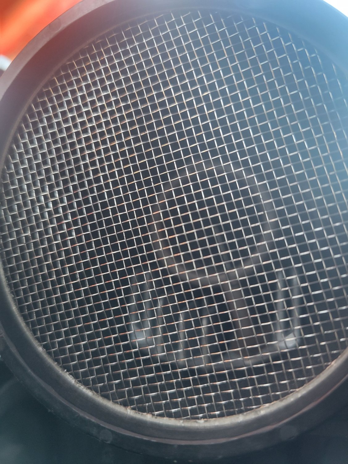

Well just picked up a Cardone maf. Now reading 5grams.
Cool!
Does the Cardone do the burn off cycle?
Asking because if it works, I'll considerer this one for replacement
Thanks
Good news, Now the diagnosis can begin. I still suspect the original MAF may be just fine, and should be stored as a good,working spare. You now know how difficult it can be to find one that works.

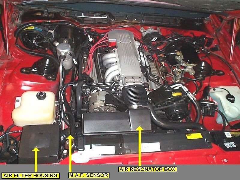

If the air inlet uses the plastic resonator box between the TB and MAF sensor, the original straight convoluted rubber duct/adapter is GM10037612. If the original installation is the duct with an integral 90° bend (no resonator box) the duct/adapter is GM 10055895, and that could be a little tougher to scrounge up.
The 10037612 straight version is very similar to the Camaro version: https://www.ebay.com/itm/383748440393

My '86 is set up with the resonator box and straight duct adapter:

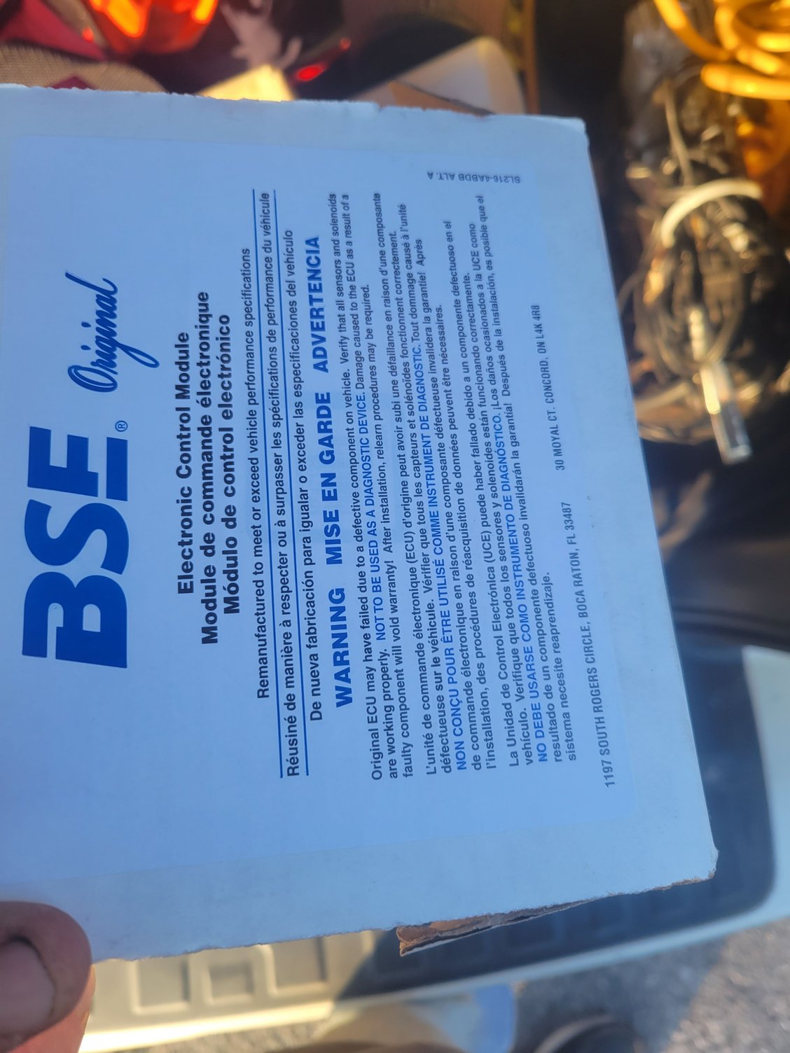

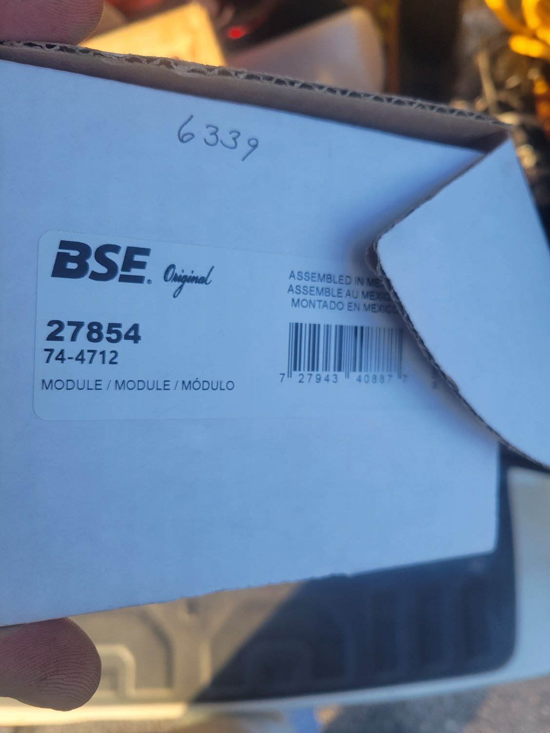

Originally Posted by SbFormula
Soooo.... which Cardone did you get?
#864712, or
#744712
Thanks
Old Mar 16, 2023 | 05:16 PM
  #62
SbFormula's Avatar
Joined: Jun 2012
Posts: 1,367
Likes: 193
From: Canada
Car: '18 Chev Camaro SS 1LE
Engine: LT1 6.2L
Axle/Gears: 3.91
Re: Maf reading
Not a Cardone?
Looks like a BSE remanufactured 27854. BSE new is 57854.
Thanks
EDITED:
To add to confusion:
BSE 57584 = '86-'89 (NEW)
BSE 57878 = '88-'89 (NEW)
Cardone 744712 = '86-'89 (Reman)
Cardone 864712 = '86-'89 (NEW)
Old Mar 16, 2023 | 06:27 PM
  #63
george88gta's Avatar
Posts: 437
Likes: 21
From: Long Island N.Y
Car: 1988 Pontiac GTA
Engine: 5.7 l98
Axle/Gears: BW 9bolt with torsen carrier
Re: Maf reading
Not a Cardone?
Thanks
they said bse and Cardone was same part # in there computer.
Old Mar 16, 2023 | 07:34 PM
  #64
Vader's Avatar
Posts: 19,659
Likes: 310
Re: Maf reading
I think SbF is correct, especially with the Bosch logo and symbol so evident. That should be a good thing, since it will act just like an original (which it probably is).

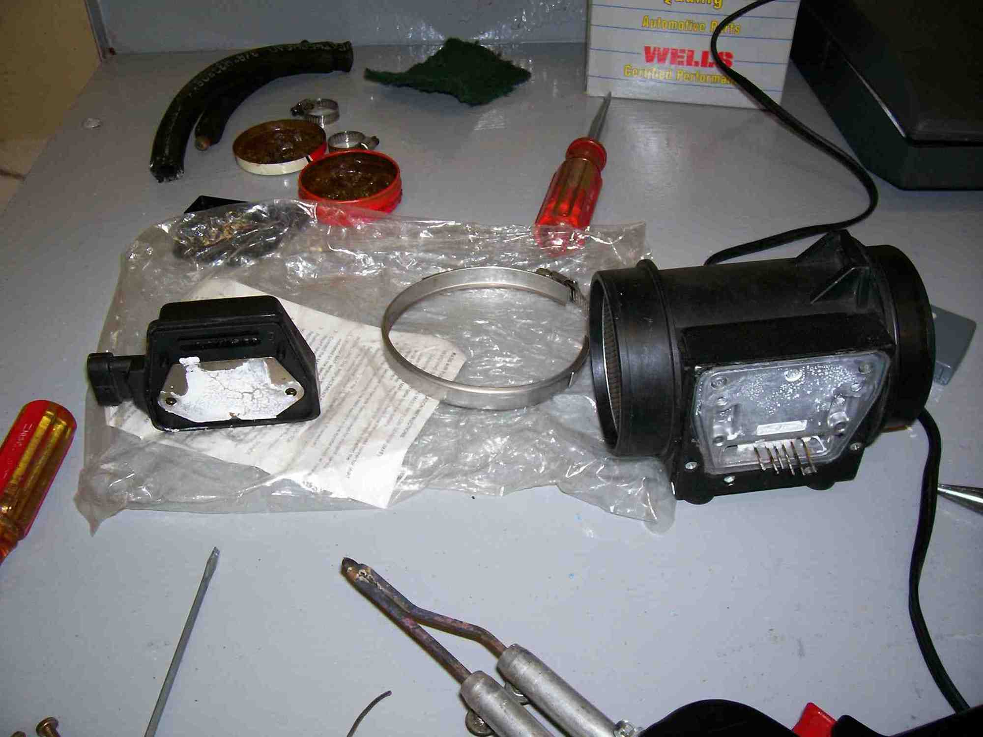

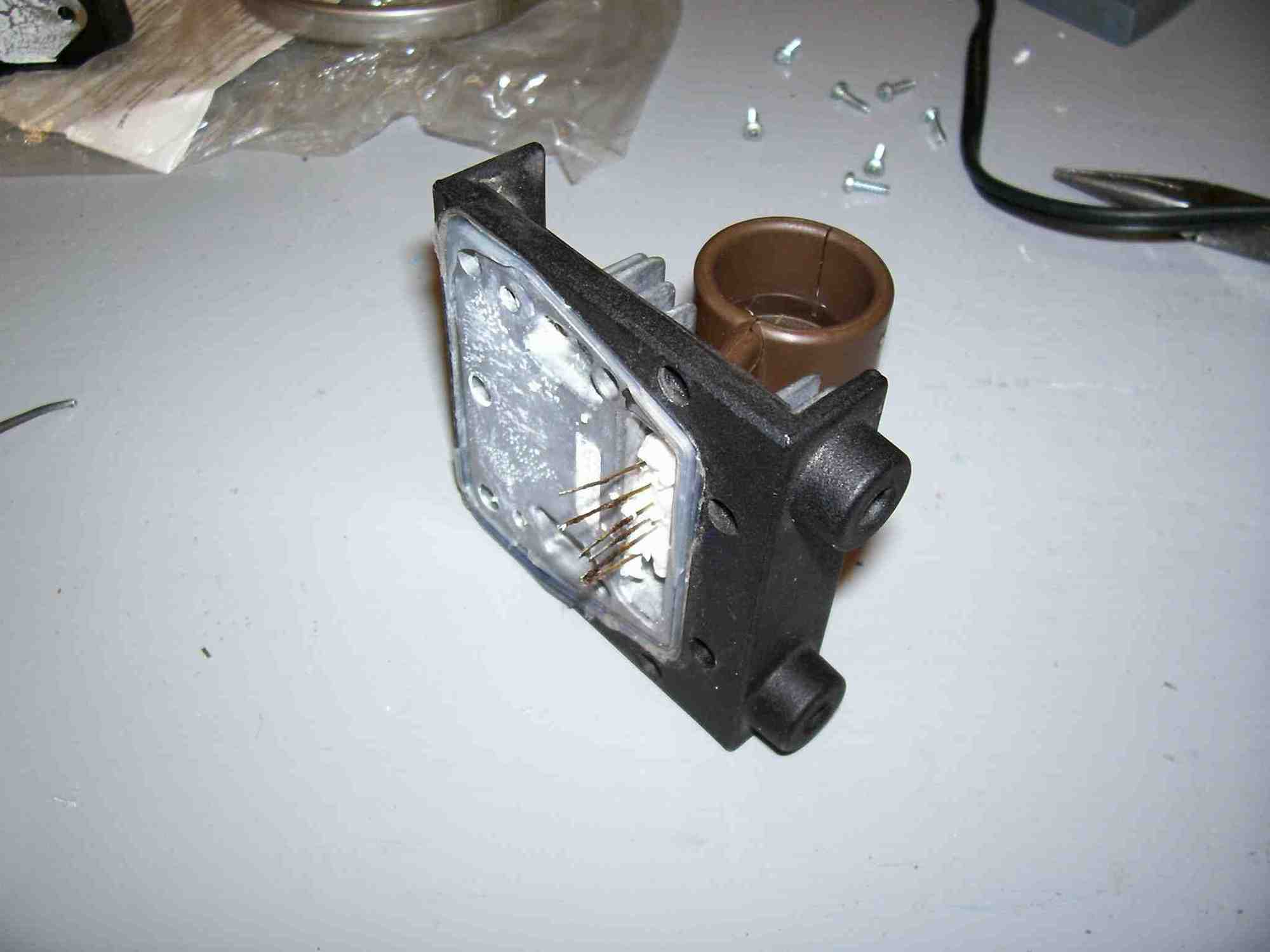

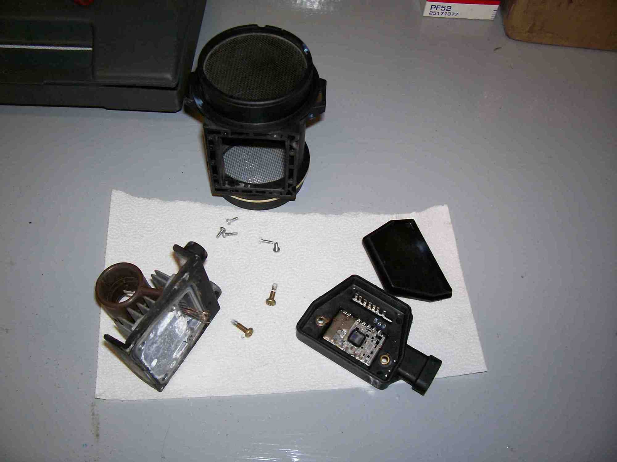

Our membership has effectively documented the recent problems with some new and some remanufactured MAFs, as well as the ongoing issue of parts databases showing the 1985 MAF (TPI verson) being the same part numbers as the 1986-up MAFs.
As many know, the typical Hitachi-style (patent 4,369,656) thermal MAF has a thermal sensor in contact with a heated element, and when in operation system power heats the element to a predetermined temperature. The current required to achieve the design operating temperature establishes a "zero" point in many meters. In some designs, the element temperature is also compared to an ambient temperature sensor as verification and precision. As air flows past the heated element heat is extracted, and the system will increase current to maintain its design operating temperature. The level of this heating current is directly proportional to the heat being removed, which is also proportional to the mass (*- not volume) of air moving through the unit.
* - This important distinction means that the sensor accommodates differences in barometric pressure and altitude, humidity, and any other variations. Vane air sensors like those used in earlier systems from Bosch, Nippondenso, and Ford could not inherently compensate to altitude, barometer, moisture, etc.
As the element heating current varies, the internal circuitry samples and maintains the temperature and also conditions that current signal level via a scalar to generate an output voltage, or via an analog-digital converter to produce a digital or frequency-modulated output at a fixed P-P voltage. The digital scheme eliminates potential problems from resistance, poor connections, low system voltage, or other conditions which could affect the output to the powertrain control computer. Thus, regardless of the communication system, most MAFs, rely upon thermal transfer/heat dissipation to measure the mass of air moving through.
Anyone reading this has probably already realized that the cleanliness of the sensing elements is critical to accurate measurement, as any contamination becomes an insulator. This is why a hot-surface sensor is subjected to a burn-off cycle periodically to shed any contamination which might accumulate on the element. There are sealed design units using a thick-film semiconductor (Stoltman-Kabasin patent 4,445,369) which are more immune to contamination, but still not completely. Cleaning is a requirement, eventually.
You may also have realized that despite the incredible speed of electrons flowing in conductors, turning on the sensor to establish a "zero" point can take a few milliseconds, and there are also delays in the powertrain control computer in recognizing this. This is yet one more reason to turn on the ignition and wait briefly before operating the starter.
As this relates to recent problems, it should be easy to understand that it is critical to accurately measure and control the element temperature and heating current, and perhaps even more critical to develop the signal conditioning to recognize the "base" levels and scale the outputs accordingly. A little bit of carelessness in placing components, isolating elements from other heat-leaching surfaces, and selecting a base operating temperature that is adequate to account for seasonal temperature variation at any lattitude would result in an incorrect signal level. I can just imagine that the A-I and "team engineering" (a.k.a., LCD engineering) would perform all the R&D in a design lab at 72°F and 35% R.H., and completely overlook the fact that the design would need to work correctly on top of a 9,800' hill in Saskatchewan in January, as well as 280' below sea level in Death Valley in July. GM managed to do that themselves, and in later working with Bosch and Hitachi.
Whether Malaysia and Taiwan managed to go that far, no on knows, but the evidence is that some of the recent offerings may not have closely controlled that to avoid 800mV signals with no air flowing.
That is some great insight @Vader . I will have to see how the new BSE works. BSE also has a reman unit. Rock Auto carries that. On Rock Auto both the BSE new and Reman Unit show a picture of the Bosh Unit.
I WinAldl and can look at the engine while running. What should I look for to know if the Mass Air Flow Sensor is working properly ?
Pete

I will post my results after I get the BSE new unit installed and running.

Well the new BSE did not work.
car will start and idle. But the second you touch the throttle, car dies. Can not get it to run. So back to trying to figure out what is going on with the Code 34.
