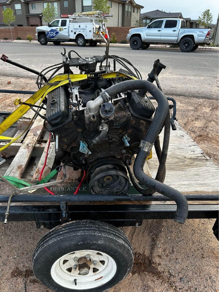

***EDIT*** NOT For sale by me. FOR SALE CLOSE TO MY HOME****Seller states "it came out of a truck. Don't know if it's 2 or 4 bolt main. I (HE) bought it from a guy who said it had a rod knock. Neither of us tore it down". $300 OBO. What say youse? L31 ? With a knock it's not worth much. I messaged seller asking if it has 4 or 6 bolts, holding the intake to the heads. Thank you!

L31 ?

Looks like an L31.

That would be a L30 305 or L31 350. My guess is L31 because I have only seen a couple L30s with the oil cooler setup and those were in 2500 Vans. Those oil cooler lines are C/K truck or SUV ones. The back of the block will have 5.0 SGI or 5.7 SGI cast in it to tell you which one it is.
Thank you. NOW I just found a seller states... "out of a 1999 Chevy truck, ran when removed, needs rebuild Vortec 350" offered for $300, in my town.

Probably worth it, as long as the heads aren't cracked.

Probably set up for roller. Probably a 4L60E, and looks like a 2WD version, probably a new starter, and it's already on the pallet, ready to be unloaded.
And to think I just gave away my last 350...
